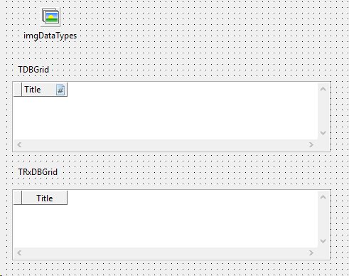

Images in TRxDBGrid Titles just won't show:
     grdData.TitleImageList:=imgDataTypes;
     grdData.Columns[0].Title.ImageIndex:=2;
This code works fine with TDBGrid. The same is in design state too.
I tried but cannot figure this out, although in both examples column titles descend from TGridColumnTitle...?
I'm using CT 7.30 on Windows 10.
Please help.

The project does not work or cannot figure out why TRxDbgrid refuses to show images in Titles?
TRxDBGrid 5 years 8 months ago #15499
  • Posts: 1434
  • Thank you received: 230
someone must put code to TRxDbgrid
TRxDBGrid 5 years 8 months ago #15500
  • Adrijan
  • Adrijan's Avatar Topic Author
  • Posts: 7
Yes, the code is missing.
