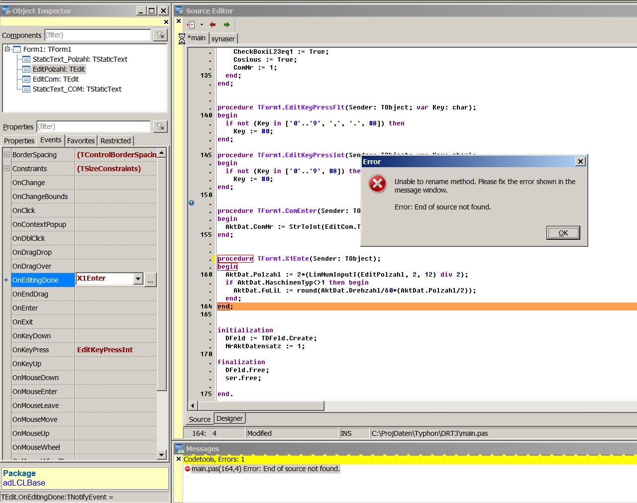

a problem using CT 6.8 on Windows7-64:
When renaming a method, CT displays 'End of source not found', please see screenshot. The bug is reproducable using the uploaded code and the following steps:
- Start the project 'DRT3' on CT 6.8
- Go to designer (click on Designer tab)
- Click on TEdit entry window of X1: (contains '2')
- At Object Inspector select tab 'Events'
- Click on 'X1Enter' at event OnEditingDone slowly 2 times so, that cursor position is after last character 'r'
- Delete last character 'r' with DEL key and press ENTER key
- Fast double click on 'X1Ente', procedure TForm1.X1Ente(.. is displayed
- Now click again at object inspector on 'X1Ente' behind last character 'e'
- To add the deleted 'r' again, type 'r', press ENTER and the error window 'End of source not found' appears
When closing CT, click on 'No' at window 'Save changes to project DRT3?'. Then the bug appears each time you start CT again using described command sequence.

Renaming a method results in error message 'End of source not found' 7 years 3 months ago #13482
  • Posts: 1432
  • Thank you received: 230
we fix this in LAB CT 6.9 revision 006840 (unreleased)
please give us time to release this LAB CT revision

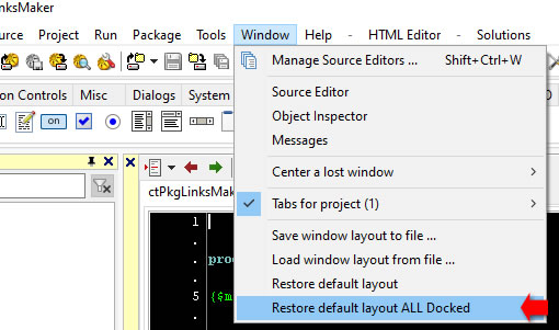

PS:Oh, If you like Typhon IDE with single Windows
Go to Typhon IDE=>Windows=>"Restore Default layout ALL Docked"
