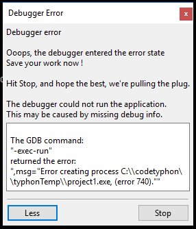

I've migrate to the release 6.6 on Windows 10 but when I execute a basic project the GNU debugger says that it couldn't execute with the -exec-run param and give an 740 code error.

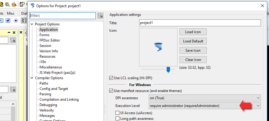

if you get this GDB ERROR 740 more Info
Check If your Project has has been configured to Run as Administrator
Typhon IDE and GDB run without Administrator rights and privileges
so you can't call from Typhon IDE (and GDB Typhon Sub-process) a project with Administrator rights and privileges.

I've verified that I apply your explanation.
But it doesn't work and it's the release 8.2 of GNU Debugger how it's delivered (with CT 6.6). This release doesn't support the "-exec-run" command apparently !
