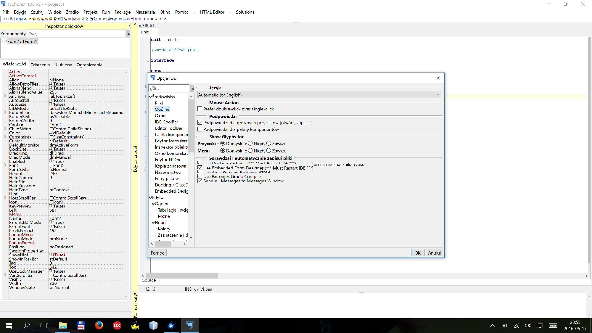

Just installed CT 5.70 on new laptop with high dpi (3200x1800) and IDE looks terrible. Apart from things visible on screen all other parts of IDE are tiny: menu, icons, forms and even mouse cursors. IDE is hardly usable this way. Is there a fix for this?

Right click on empty space in Object Inspector, then choose Options, then change Item height from 22 to 30 or more. That should solve bad looking Object Inspector.

Thanks for suggestion, it helps with property editor. Unfortunately it doesn't help with forms, menus and other stuff. That's a little strange because when you develop an app with CT you can set it to be DPI aware... as they say "the shoemaker's children are ill-shod".

Having also problem with CT 5.6. Trying to set switch off dpi awarness in compatibility for typhon.exe, but it doesn't help. CT still control api awareness.
Well, most part of it is ok, bu toolbars are tiny, so hard to click them
