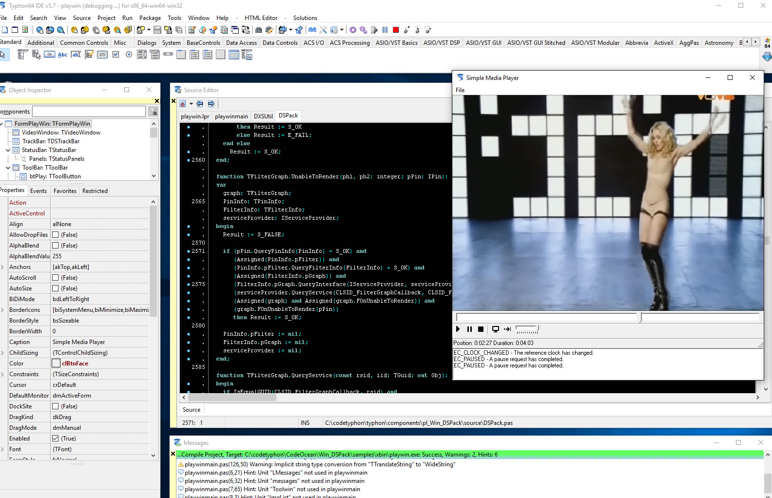

I am so happy, that the sample code PlayWin works with *.avi files.
Thank you very much !

THE GOOD NEWS IS THAT THE *.AVI FILE IS PLAYED CORRECTLY SHOWING THE MOVIE AND THE SOUND !

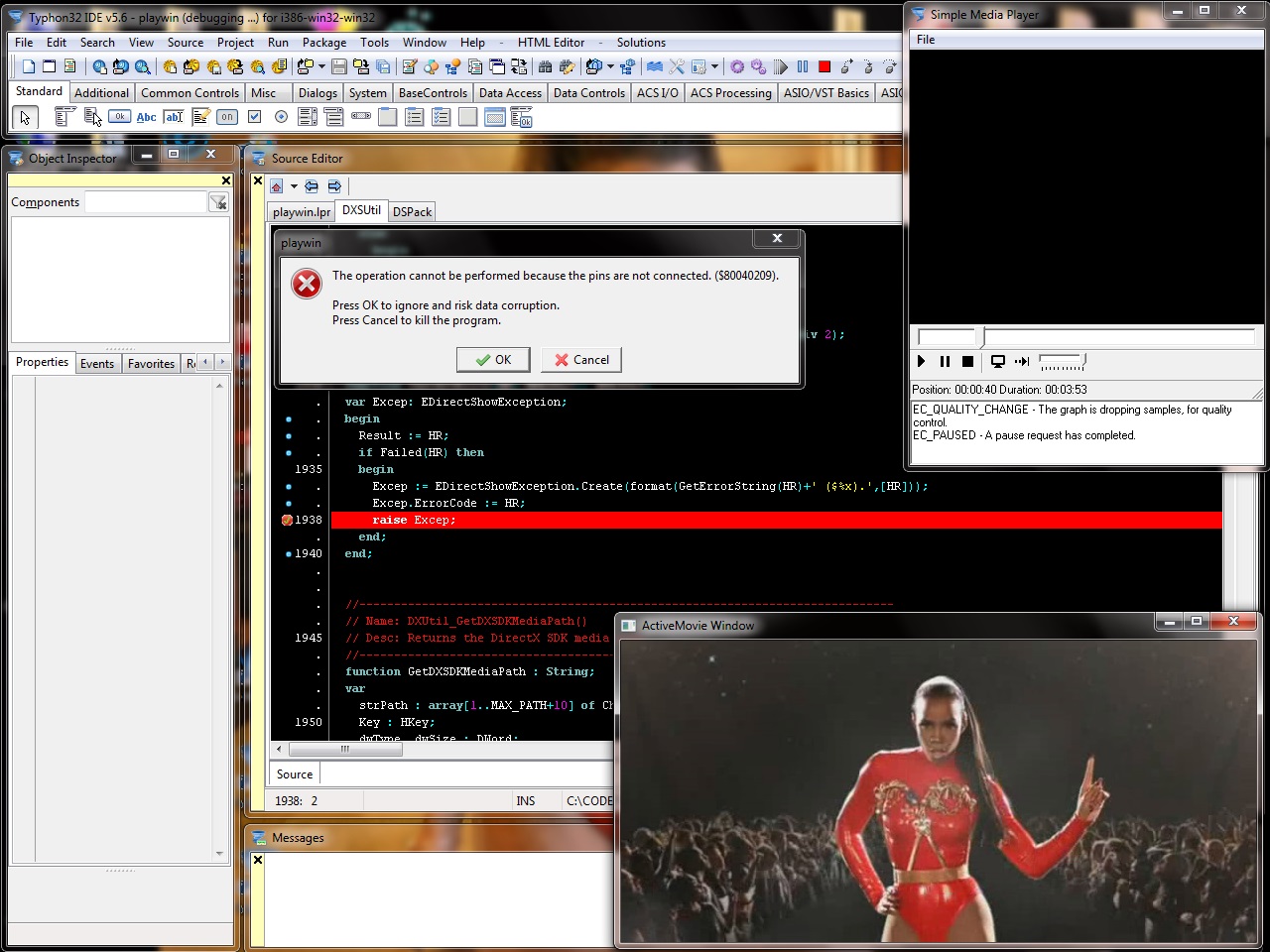

The sample code from C:\CODETYPHON\CodeOcean\Win_DSPack\samples\PlayWin works, but there rise some exceptions:
Exception 1: DSPack.pas - row number 2345
Debugger Error
The debugger encountered an error when trying to run/step the application:
Can not find bounds of current function
Press "Ok" to continue debugging (paused), and correct the problem, or choose an alternative run command.
Press "Stop" to end the debug session.

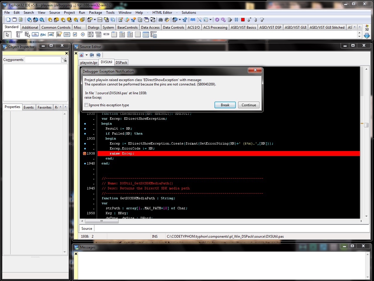

Exception 2: DXSUtil.pas - row number 1938
Debugger Exception Notification
The operation can not be performed because the pins are not connected. ($80040209):
In file 'DXSUtil.pas' at line 1938
raise Excep;
Ignore this exception type                     "Break"   "Continue".
Exception 3: application
Press "Ok" to ignore add  risk data corruption.
Press "Cancel" to kill the program.
After that appears an Assembler debugger.
Do you think I have some hardware problem with this computer ?
Last edit: by Emil Odjackov.
Can it be played a video file using any component 10 years 8 months ago #9133
this sample works OK on our PC Boxes
-Windows 10 pro, with Typhon 32 and Typhon64
-Windows 7 ultimate with Typhon 32 and Typhon64
tested with *.avi file

I tested again on my home PC2 - 64 bits Windows 7 ultimate and 32 bits CodeTyphon v 5.6;
Tested with *.avi file.
This time only 2 exceptions without Assembler debugger at the end.
Can it be played a video file using any component 10 years 8 months ago #9135
In our lab with CT 5.7 all work OK
did you install DirectX End-User Runtimes correctly ? info
with Web Installer ?
Can it be played a video file using any component 10 years 8 months ago #9136

I just installed DirectX End-User Runtimes with Web Installer from the link above. After installation I did not restart the computer.
Unfortunately they raise the same exceptions. May be I have some hardware problem. I will test at another home PC1 with Windows 8.1 and the same Typhon.

Sorry, but they raise the same 2 exceptions at PC1 under 64 bits Windows 8.1 with 64 bits CT.

There is no exceptions, because *.avi file is play on the Form that is part of the project.
( Under my old operating systems raised exceptions because *.avi file is play on the Form that is not part of the project, and is created on run-time, I do not know why - it is obviously on the pictures I attached above. )
