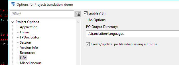

Multilanguage project 11 years 3 weeks ago #8315
OR
set Po output Directory
..\translation\languages
CodeOcean has 1300 sample projects (CT 5.5)
