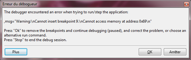

I used CT 5.4 on windows seven and CT64.
Ct was working fine since 2 weeks and I transform a project originaly in delphi XE2.
Suddenly I have my application freeze and CT also. I need to kill CT as I can't killed my application.
In first time after I discovered that the source of the program was completly empty !
I take the sauvegarde of the file, but if I can compile the project, the debbuger is broken : see error message in attachement.
I can close and restart CT it's alway the same :angry:
What can I do ?
thanks

> At address "0x69"
That means the address was not relocated (it should be at a higher address).
This typically happens when the address is not actually in the application. Or in other words, if smartlinking was used.
Due to a glitch fpc sometimes adds debug info for methods that are removed by smartlinking. That is why you should never use smartlinking for debug builds.
Verify your config wiki.lazarus.freepascal.org/Debugger_Setup
However this error does not usually lead to any hang/freeze. So their may be more.
What OS ? The image looks like windows? 32 bit or 64 bit?
For 32 bit maybe test the debugger from sourceforge.net/projects/lazarus/files/L...s/Alternative%20GDB/
(or version 7.2-1 as bundled with lazarus)
Some other versions of gdb (win32) are rather unstable. (e.g. during my tests versions 7.8, 7.9, 7.10 crash more often than the other versions)
If it is windows, and you get a freeze, have you tried to kill gdb.exe? Assuming it is still in the tasklist?

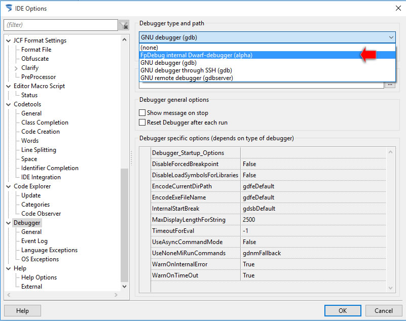

for ver 5.4 CodeTyphon has and fpDebug as option
for Windows and Linux

My OS windows 64, and I made no change in my PC between the time all was good and the time all was bad !
I just test again and it's the same think, I can compile but when I start the application, I have the windows error I copy in my first message.
I look for gdb.exe with the taskmanager, and I kill it, like that after I can kill CT.
As Sternas indicate, I change the débugger for fpDebugger and I can run my application and I can trace in debugging mode.
It seem that gdb is brokken.
If fpDebugger can make the job, no problem.
