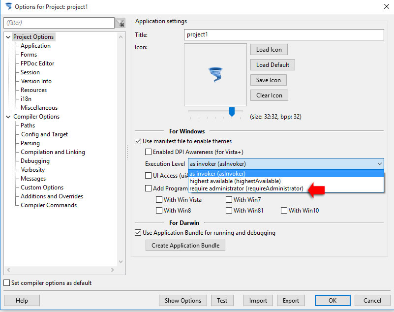

Yes Sir you can
go to Project Option => Execution Level
set "require administrator (require Adminnistrator)"
with this windows we will run you project always as Administrator
more info here
Warning Set this projects option, only at "release" stage of your project.
Typhon IDE Debugger (gdb) can't debug "administration" programs
