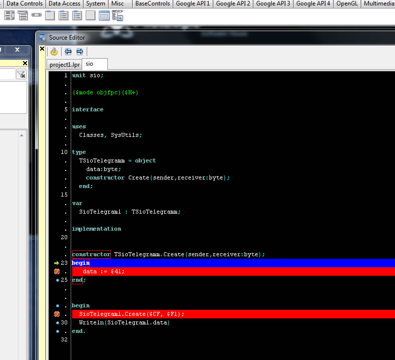

GDB exception 11 years 3 months ago #7589
  • wolfram
  • wolfram's Avatar Topic Author
  • Posts: 27
Why causes this simple unit (using a object not a class) a access violation?
Windows 7 64bit.

GDB exception 11 years 3 months ago #7594
  • wolfram
  • Posts: 27
Sorry Sir,
but this is not the Problem.
It crashes, if you step into the create constructor.
I have attached a reduced sample...

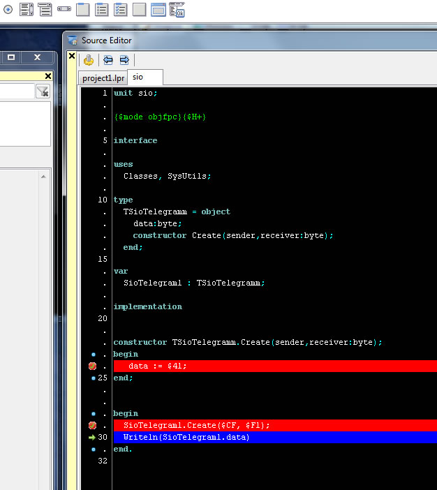

GDB exception 11 years 3 months ago #7596
  • wolfram
  • Posts: 27
sternas wrote: copy begin ..end block code from sio.pas to
project1.lpr
units can't have
begin ..end block
(1)
Sir, are you sure!?
units can have "begin end."-blocks since turbo pascal 1.0.
the error occures even if I move the begin-end-block to the main program.
(2)
I can not step through the constructor in CodeTyphon.
With Lazarus it works (Tested Lazarus 1.4, Win7-64).
With CodeTyphon the exception shown in the picture occurs.
BTW: I use CodeTyphon 5.3 updated to 5.4
But version 5.4 will not be displayed anywhere!
Still 5.3 will displayed.
Is this normal?
Thank you of your help.
Best Regards

GDB exception 11 years 3 months ago #7599
  • Tony_O_Gallos
  • Tony_O_Gallos's Avatar
  • Posts: 84
  • Thank you received: 24
For the structure of a Unit: wiki.freepascal.org/Unit
For Object type: wiki.freepascal.org/Programming_Using_Objects
In a unit you can use initialization/finalisazation but no begin/end;
The code is bugging the same under Lazarus.
