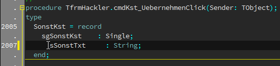

Can I get with settings a behavior like in Notepad++:
1)
If I, as seen in Grafik_00, set the caret to the left of
the variable and press Shift+Tab actuated, then does not happen.

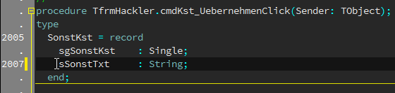

If I do this in Notepad++, then the variable is shifted
by the tab-width to the left. (Grafik_03)
2)

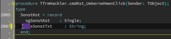

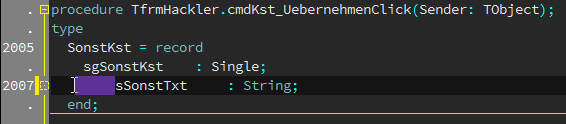

The same starting point, I mark the area to the left of
the variable, as shown in Grafik_01, press the Tab-key,
so I get as result a further tab to the right(Grafik_02).
If I do that with Notepadd++, I get as result Grafik_03.
