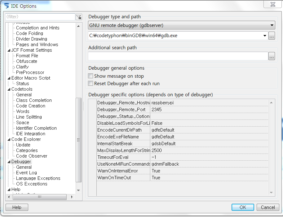

hi
I wanna use "remote debug" my application from windows. but i got problem
My target system is Raspberrypi2 (raspbian) host is win64(windows7)
I did this :
1) "target > gdbserver host:2345 ./Myapp" and get "processe execfilename created; pid =3029 listening port 2345"
2) IDE(typhon) >
I got result :
target > "remote side has terminated connection. gdbserver will reopen the connection"
and GDB in IDB does not work.
How can i solve this problem.. i need your help

I think host(windows) GDB configuration is wrong.
Host GDB config : host=i686-mingw64, target=i686-mingw64.
How can i chainge windows GDB configuration?

  • Posts: 8
I did it all your answer. but i got any chage..
By any chance, did i wrong way to build Cross-debugging?
Please check my way is right.
Here's my way
1. Installing Codetyphon and typhon following this instruction : www.pilotlogic.com/sitejoom/index.php/wi...allation-for-windows
2. Setting Cross-Compile environment follwing this instruction : www.pilotlogic.com/sitejoom/index.php/wiki?id=386
3. Setting IDE : tools - option - debugger as my post.
4. Setting target GDBserver : target>gdbserver HOST:2345 "myapp" or target>gdbserver --remote-debug -multi HOST:2345
5. Build and run (press F9)

At step 5 or 6 (Project Options) in the link you posted, go to the "Debugging" options.
Make sure you do not use smartlinking.
Open the break point window, and check that all breakpoints are in files from your project. And on lines in code.
A few thinks you could try. I do not know if they will help.
I might know more if I know the answers to the above section
Other options worth playing with are (in the property grid, global debugger options).Change one at a time
- "Internal start break", try "main" and "entry"
- UseAsyncCommandMode
- UseNoneMiRurommand
Those option affect how the IDE initializes the debug session, and it is possible that some version of gdb do not like all of them.
