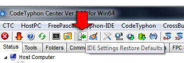

Hi Marco,
there is an option in CT menu to restore default settings:
-Typhon-IDE
--IDE Settings, Restore Defaults
Be aware it will reset any customization you have done in your IDE.

Sir my suggestion
for these errors :
open CTCenter and execute " Typhon IDE ->IDE Settings Restore Default"
The following user(s) said Thank You: GoldenFox1
IDE - Main window disappeared 11 years 10 months ago #5771
  • GoldenFox1
  • GoldenFox1's Avatar
It works. Thanks!!!
