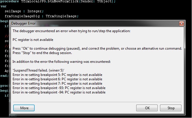

Debugger message 13 years 3 months ago #4122
  • ExDatis
  • Posts: 110
I've got a strange message from debugger(attachment),
when I close the application.
Win7 32bit Ultimate, laptop FujitsuSiemens AmiloPro,
Typhon 32bit BigIDE. Where did I go wrong?
Regards
Last edit: by ExDatis.

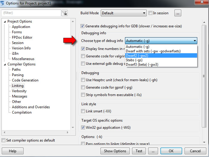

Debugger message 13 years 3 months ago #4123
I think, it's GDB and Pascal code problems
Try other "Debugger type info" for your project
Projects->options->Linking
Debugger message 13 years 3 months ago #4124
  • ExDatis
  • Posts: 110
Thank you very much! I'll try.

Debugger message 13 years 3 months ago #4125
  • ExDatis
  • Posts: 110
Nope, the same problem. But it's not so important, I'll reinstall OS and Typhon.

Debugger message 13 years 2 months ago #4141
  • ExDatis
  • Posts: 110
Probably I'm wrong, but the error is repeated and I think that the problem is in using STRIP tool which I use every time before I create backup. Is that logical thinking?
Regards
Debugger message 13 years 2 months ago #4142
  • ExDatis
  • Posts: 110
Also, I use the option: --strip-all
Debugger message 13 years 2 months ago #4143
  • Pierre Joubert
  • Pierre Joubert's Avatar
  • Posts: 13
Hi
Perhaps, by some change there is a version 7.3 or 7.4 of GDB on your machine?
Please see the following:
sourceware.org/bugzilla/show_bug.cgi?id=14018
wiki.freepascal.org/GDB_Debugger_Tips#.2....28winerr_5.29.22.29
Debugger message 13 years 2 months ago #4144
  • ExDatis
  • Posts: 110
binGDB\win32\readme.txt:
"CodeTyphon Studio
This GDB v 7.5.50 for Win32 release at 23/10/2012
can be used to debug your Win32 applications".
Thank you very much, I'll check links,
best regards!

Debugger message 13 years 2 months ago #4154
  • ExDatis
  • Posts: 110
Nope, the fault is not due to the use STRIP command. It's happening in other projects, also, without using STRIP.
So, not big deal, just use stop.
