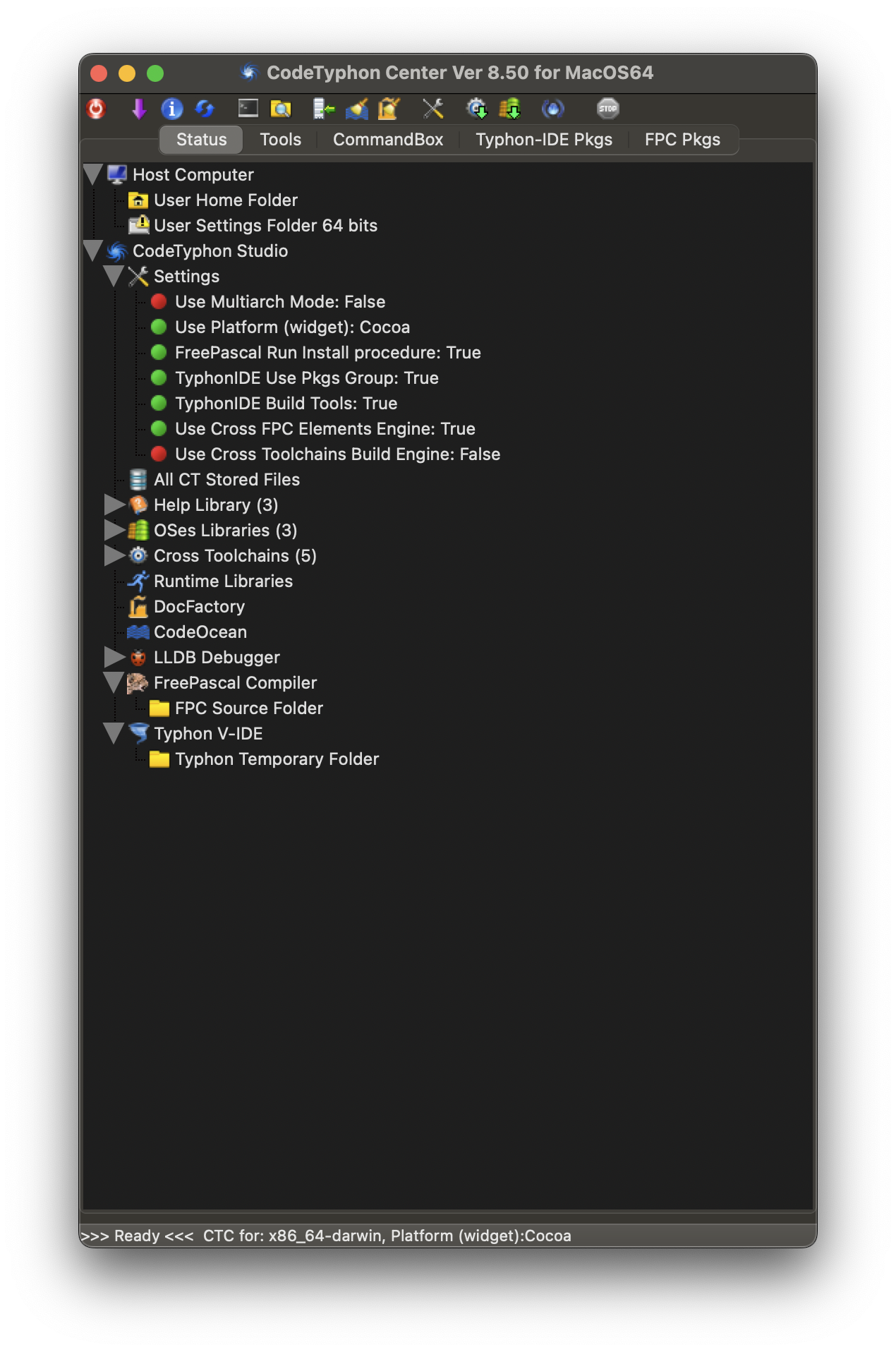

Has anyone managed to get CT 8.5 running on macOS 15.1 Sequoia? 1 year 9 months ago #18666
  • Carl Caulkett
  • Carl Caulkett's Avatar Topic Author
  • Posts: 7
  • Mac Mini M1
  • macOS 15.1 Sequoia
  • CodeTyphon 8.5
I've just downloaded and tried to install CodeTyphon 8.5 on macOS 15.1. I ran the option to `Install the System Libraries` and to `Remove and Build All`, as instructed by the Wiki page. Now, when I run the CodeTyphon app which gets installed in my `/Applications` folder, it, in turn launches the CodeTyphon app in my`/usr/local/codetyphon/binCenter/x86_64-darwin-cocoa` folder.
I should also point out that I've added my user to the `sudoers` group using the instructions on www.pilotlogic.com/sitejoom/index.php/wi...il-installation.html
The problem is that the only thing that gets displayed is the `CodeTyphon Center` (see attached), but there is nothing that I can see or find which is able to launch the actual CT IDE itself.
Before I commit too much time to trying to get this to work, it would be really handy to know whether CT 8.5 does actually work on macOS 15.1, or whether I need to wait for things to be sorted out by PilotLogic!

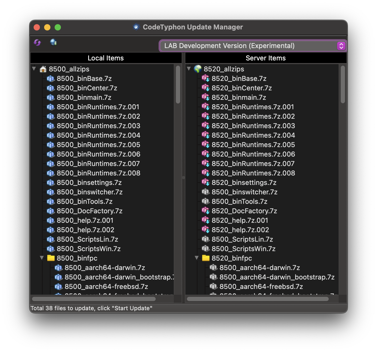

Thanks for the reply, Sternas! Where do I find LAB CT 8.60 Rev 008520?
UPDATE: I fired up the Update Manager and changed to `LAB Development Version (Experimental)`, then clicked "Check for Updates". I'm not sure that the updates displayed are the latest 8.6 files though...
Nevertheless, I clicked on 'Start Update" but still no CT IDE seems to be available!
Last edit: by Carl Caulkett.
