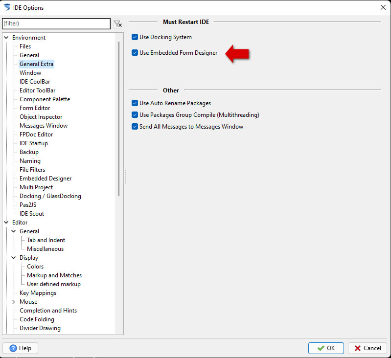

Unable to delete components Form a form 4 years 7 months ago #16873
  • Posts: 1436
  • Thank you received: 233
Go to TyphonIDE => Settings => Options
Disable  Embedded Form Designer and
restart Typhon IDE
The following user(s) said Thank You: Kurth
