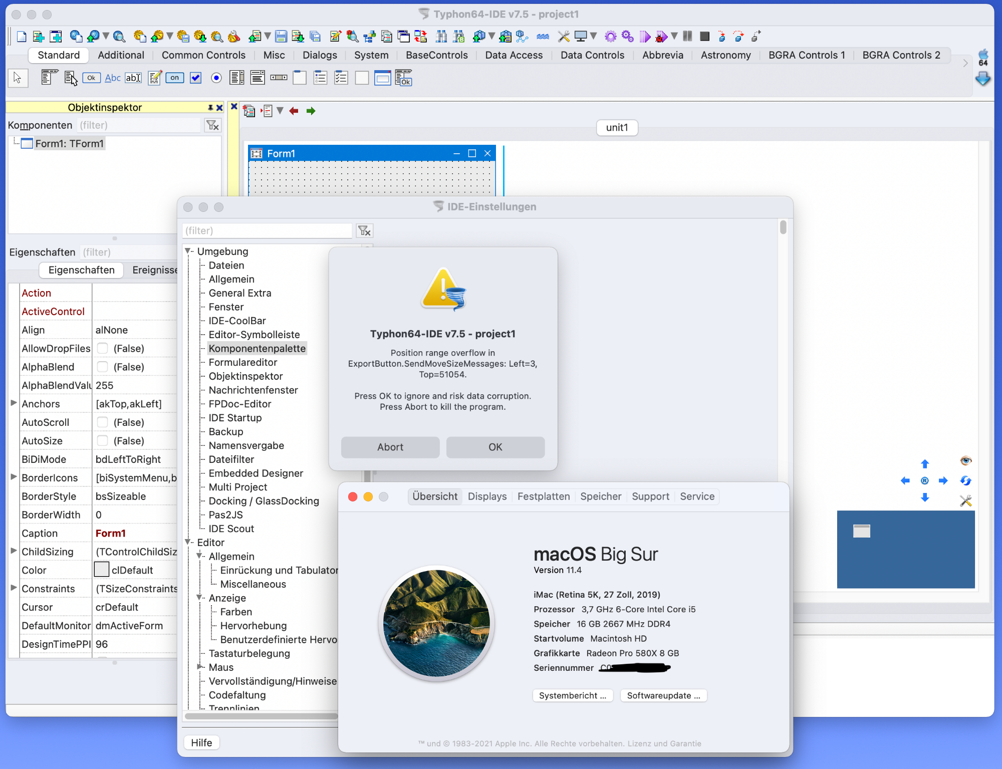

Hi CT-Team,
small, but not important issue with CT 7.5 under Big Sur on my iMac. Normally I use the component palette docked on the right side, and switch off the components in the toolbar on top. Trying to disable the component view toolbar in the settings dialog end up in a little crash. See screenshot.
Nonetheless, I'm impressed from your continuos work at CT. Thank you! I love it!
Jens

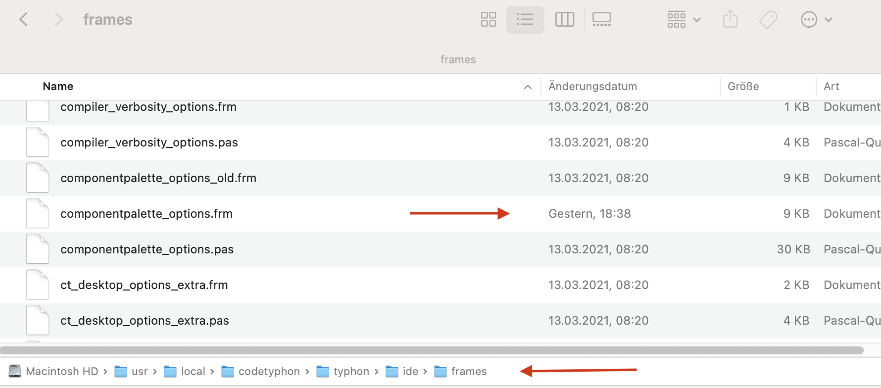

I think we fix it
1) Replace
codetyphon/typhon/ide/frames/componentpalette_options.frm
with the new in the attach zip.
2) Rebuild Typhon IDE
Crash in Settings 5 years 2 months ago #16014
  • Jens
  • Jens's Avatar Topic Author
  • Posts: 10
Done, but no success. Still the same message. I doublechecked the file, is looking ok.
