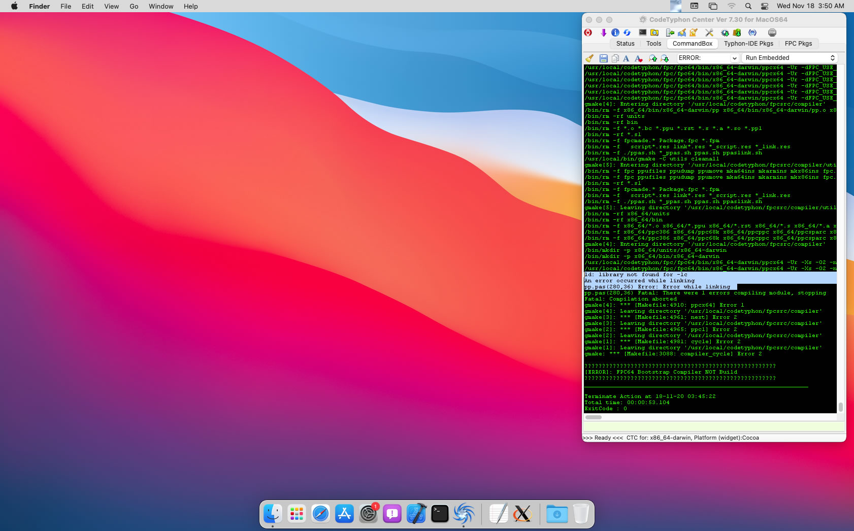

CT don't support new MacOS 11.0.1 "Big Sur" yet.
Lab Report
a) On Amd/Intel CPU FreePascal gives ERROR:
ld: library not found for -lc
An error occurred while linking
pp.pas(280,36) Error: Error while linking
and this because Apple remove libc.dylib from "Big Sur"
CTCenter work OK
screen 1
This problem must solved by FreePascal Team.
In Lab CT version 7.3 (unpublished) we don't use XQuartz anymore,
we install ALL CT needs from MacPorts.
b) For Arm64 (M1) we don't have Apple hardware to test...
but we will add all fixes to CT, to be ready (when and if).
c) We will try to make CrossBuild procedure from MacOS Catalina to Arm64-MacOS 11.0.1 "Big Sur"
Every MacOS release give us problems.
The compatibility (at development level) of new with old OS version has many, many, many problems.
and we are NOT happy with this.
