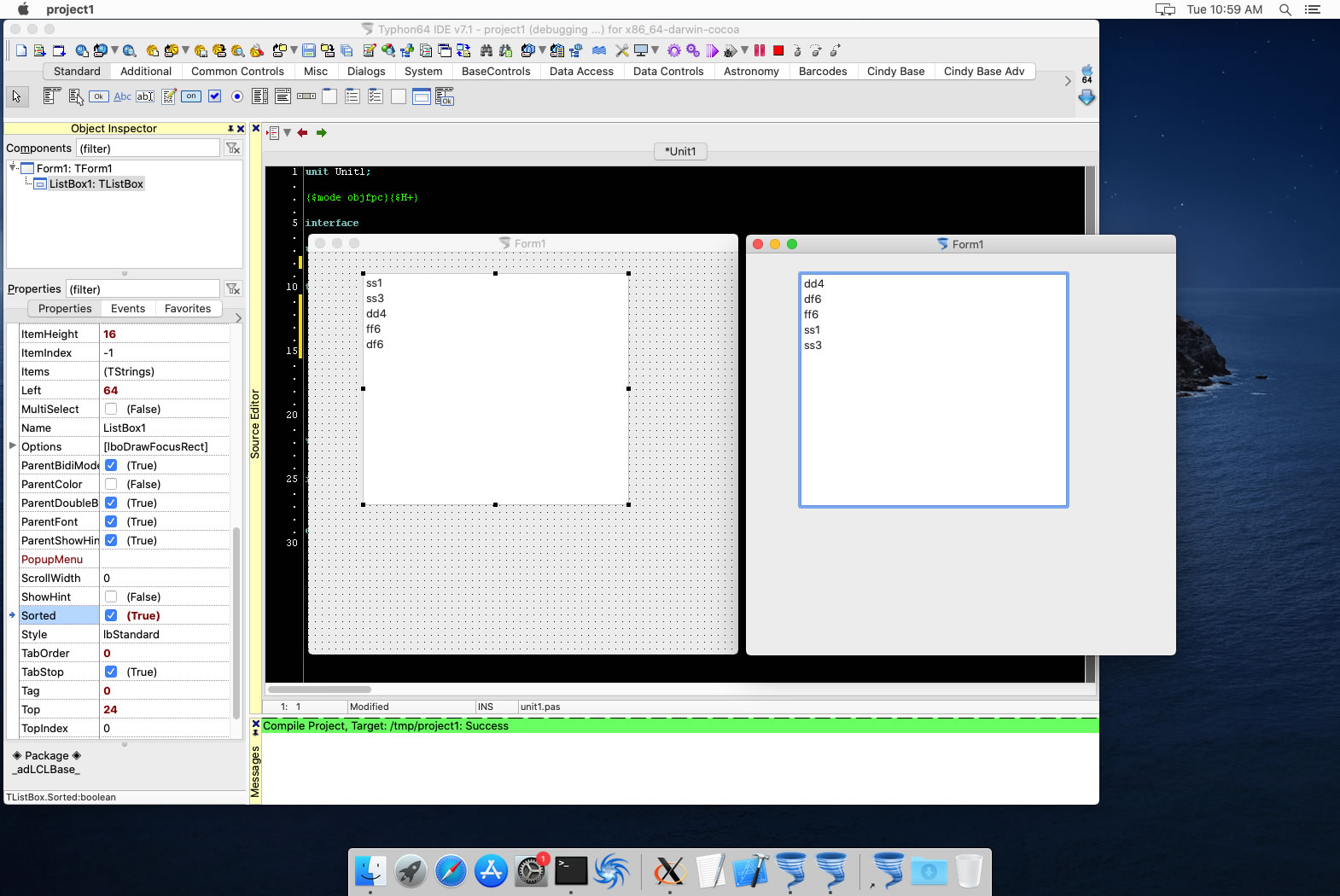

CT 7.0 Cocoa on OSX Catalina strage behaviours 6 years 8 months ago #14506
  • Posts: 1447
I test and no problem to Unreleased LAB CT
Typhon 7.1 r2003171743 FPC 3.3.1 r2003171053 Platform : x86_64-darwin-cocoa (beta)
screen from MacOS 10.15.3 Catalina
