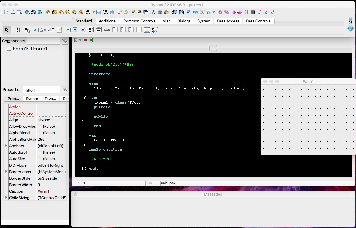

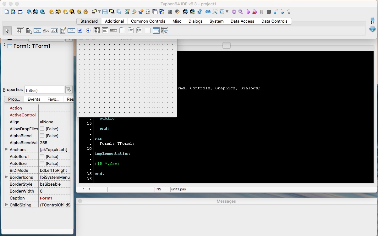

On my OSX system (High Sierra 10.13.2), both Typhon32 and Typhon64 IDEs appear without any menus on the system menu bar (other than the Apple and typhon menu which does not even open) when they are compiled against Cocoa framework.
Tried clean install of CT6.3 distribution (removed all user settings also), updated all system libraries without issues, compiled, same thing.
Upgrading to CT6.4 beta (the 'lab' version), removed all setting files, updated all system libraries (again) without issues, compiled, same thing.
Is there something I am doing wrong?
Thank you very much in advance.

on MacOS Cocoa platform need work...
For our test we use High Sierra 10.13.2
For MacOS my suggestion is to use
Lab CT 6.40, Typhon64 with QT4 as IDE HOST platform (64 bits)
And QT5 (64 bits) it's OK, but my suggestion is QT4 until we fix Cocoa problems
GTK2 (64 bits) has a problem with font size
Carbon (32 bits) work's OK, like QT4 and QT5
