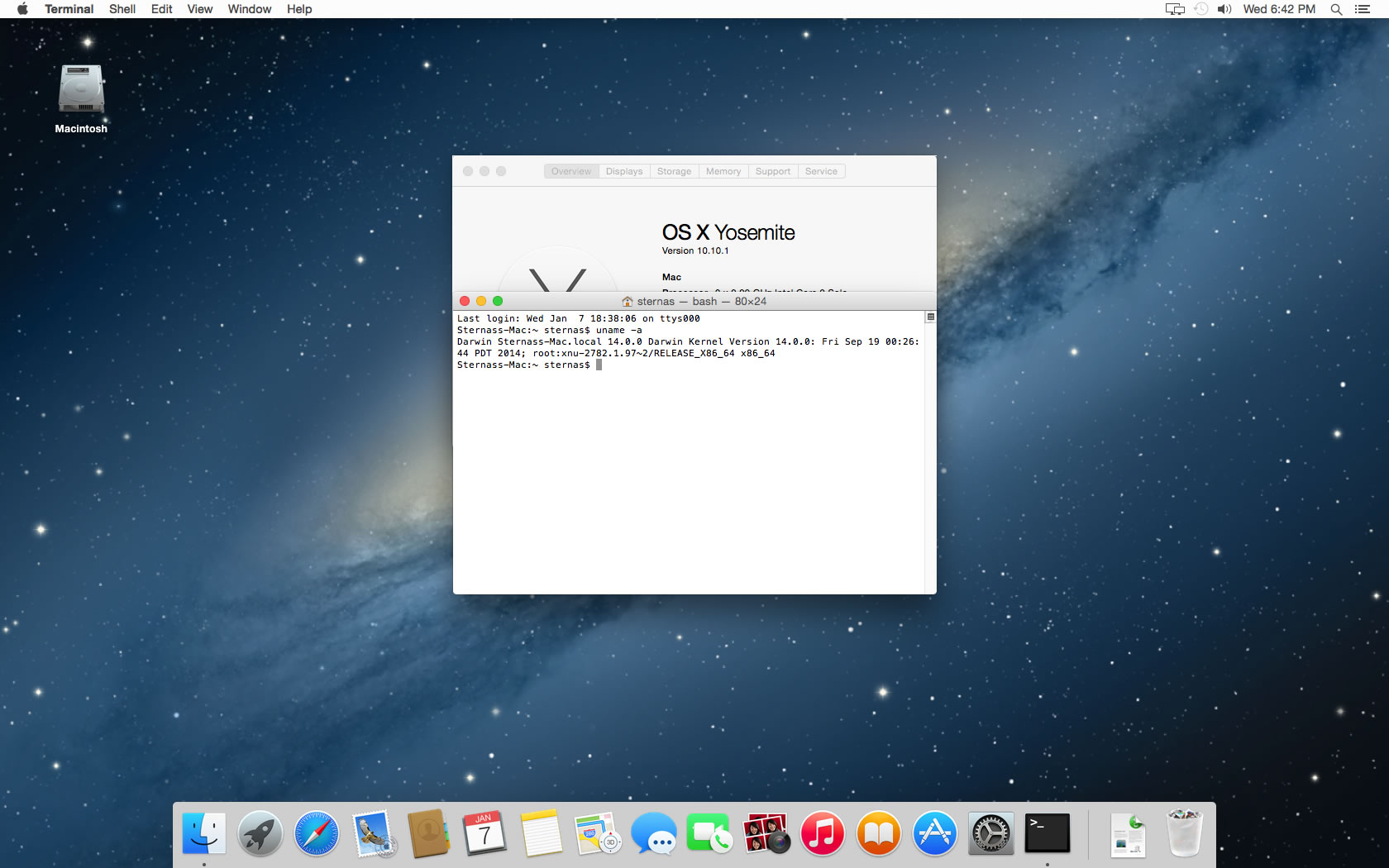

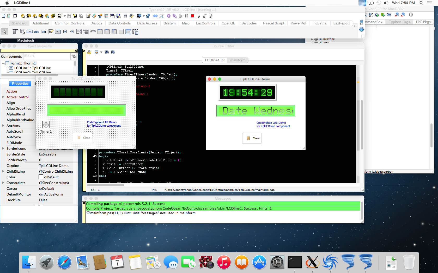

We test Lab CodeTyphon ver 5.20 on
MacOS Yosemite ver 10.10.1 ( info )
This is an Exploration Port of CT on MacOS
many things are unfinished,
but these are our first steps to this OS....

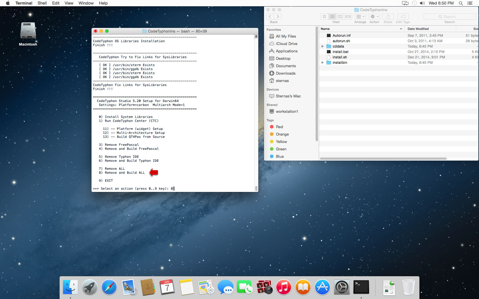

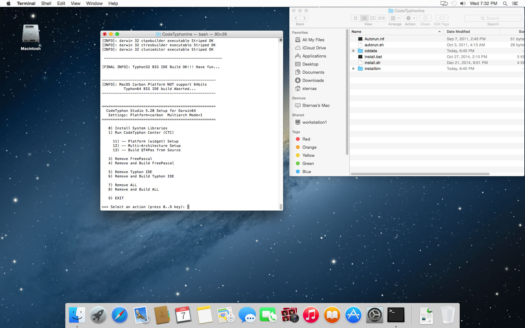

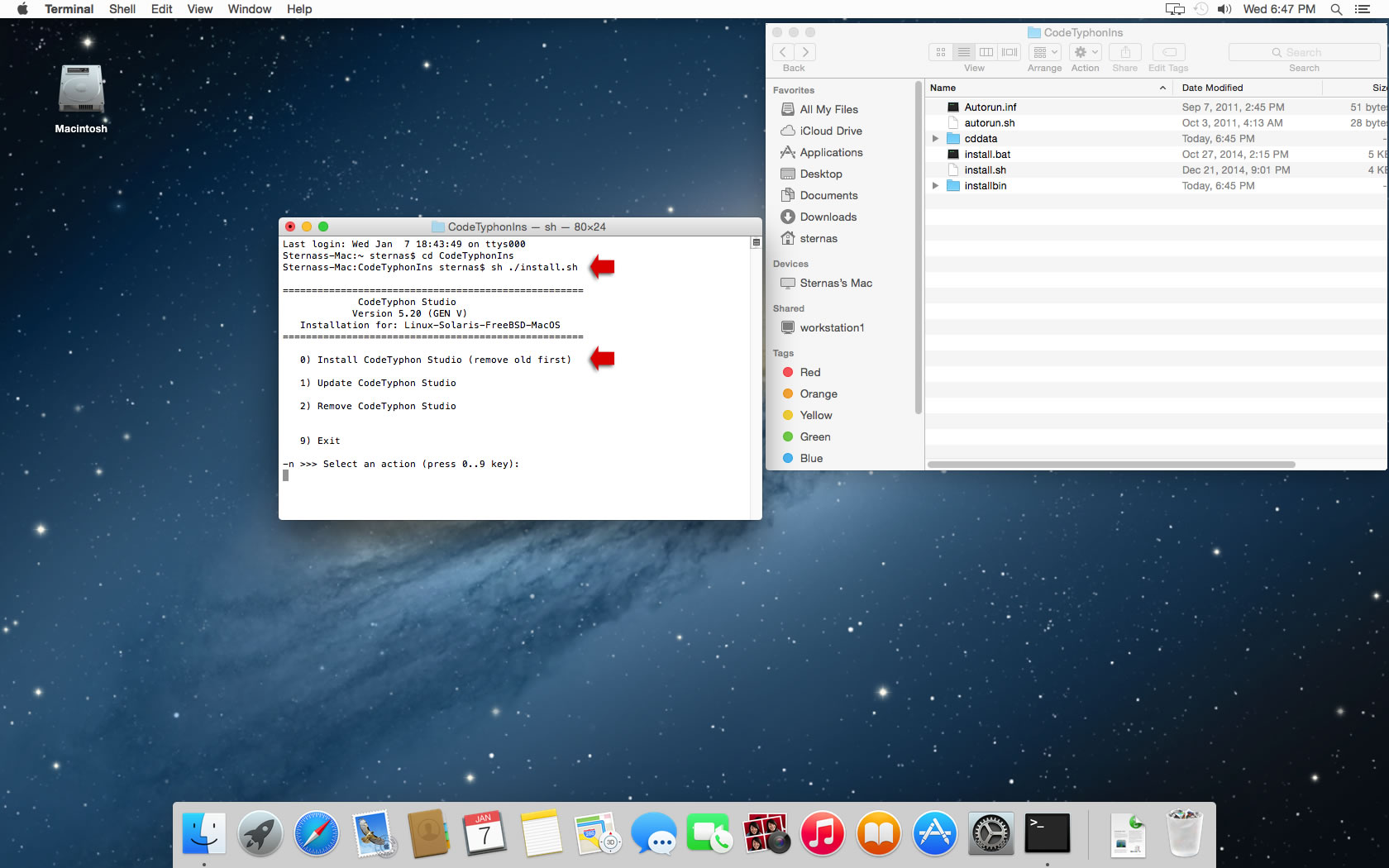

1)-Install
a)-- Xcode from Apple Store
b)-- XQuartz xquartz.macosforge.org/landing/
c)-- MacPorts www.macports.org
Is the only Proprietary OS that want Credit Card to download "Free To Use" software :silly:
The same CT installation procedure, as any other Unix (Linux, FreeBSD, Solaris etc)

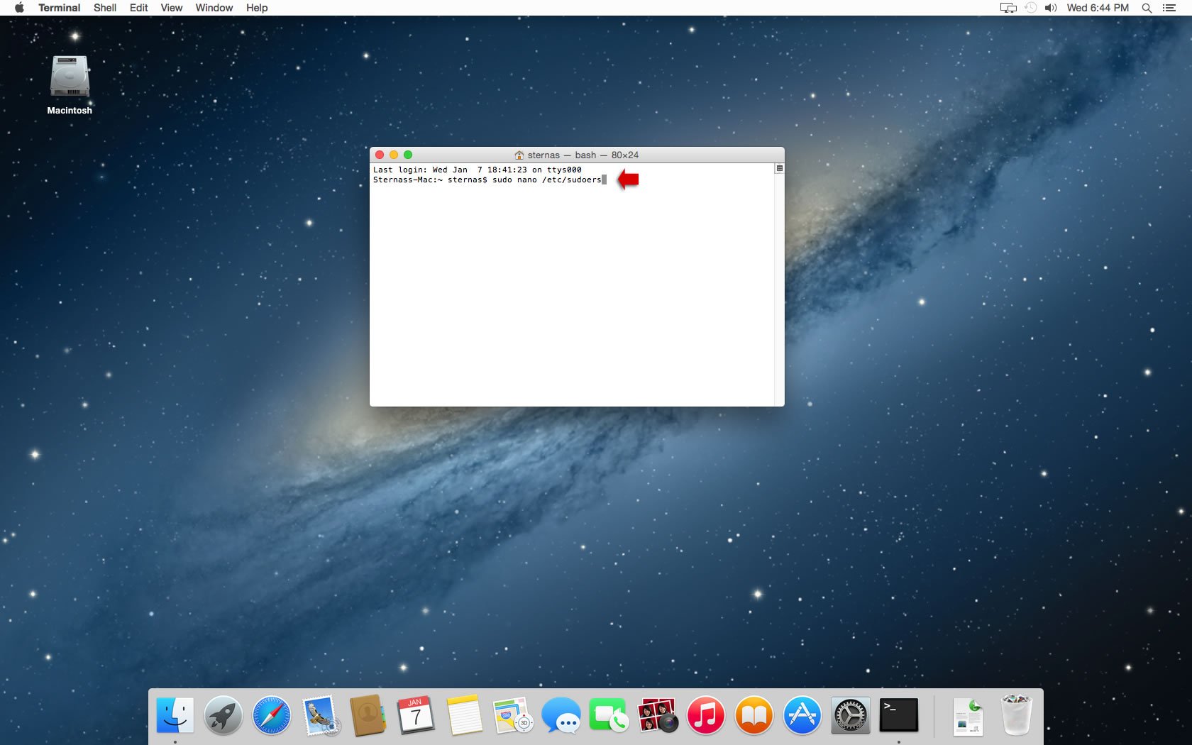

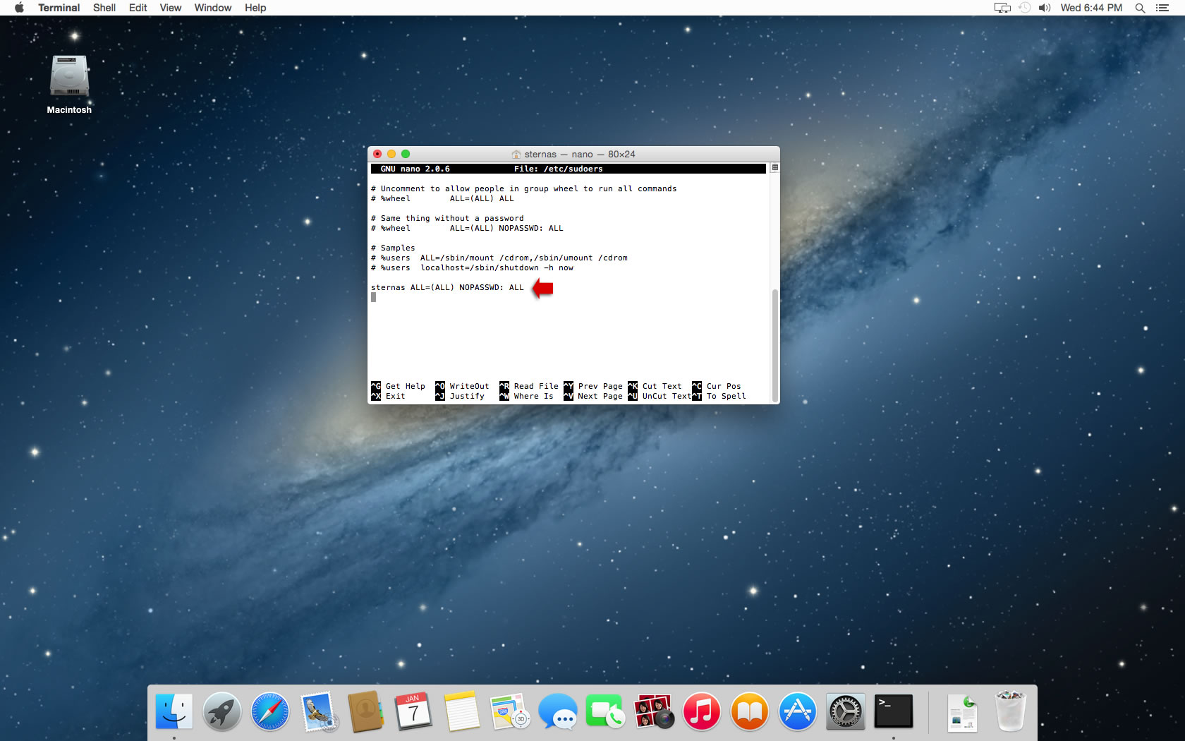

su
nano /etc/sudoers
add in /etc/sudoers file the line
USER	ALL=(ALL) NOPASSWD: ALL

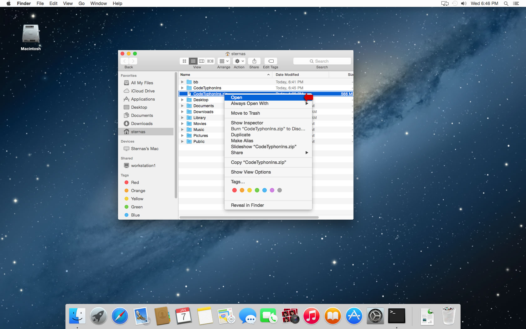

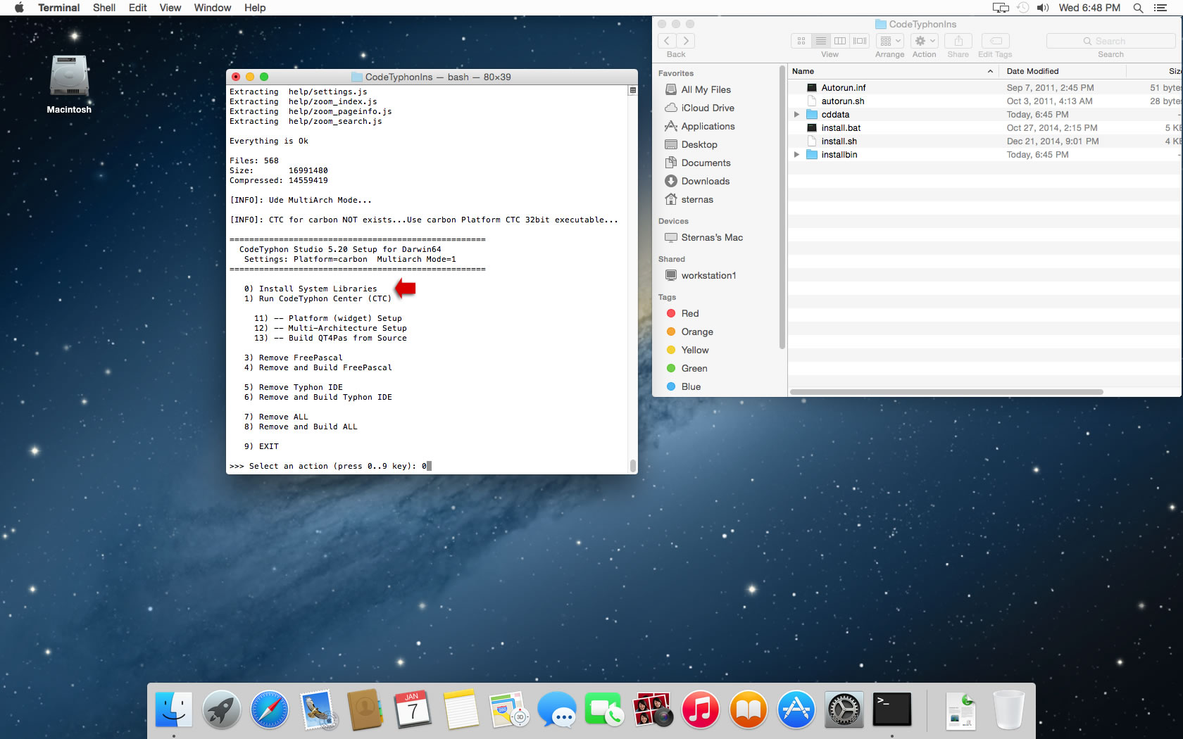

3)-Download and Unzip CodeTyphonIns.zip
4)-Run installation script
5)-Install "System Libraries" from CT Setup script.
6)-Build ALL FPC and Typhon IDE.

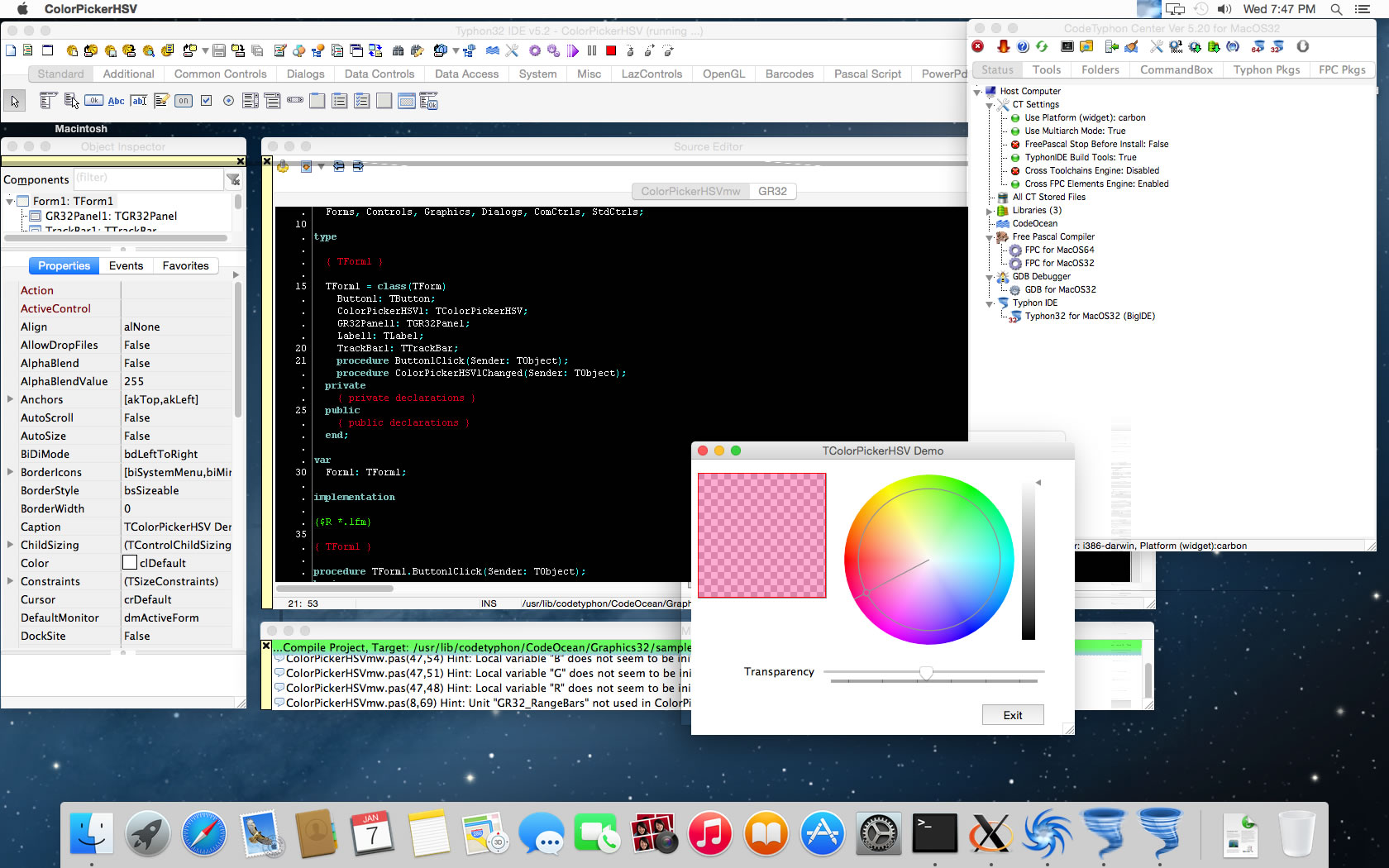

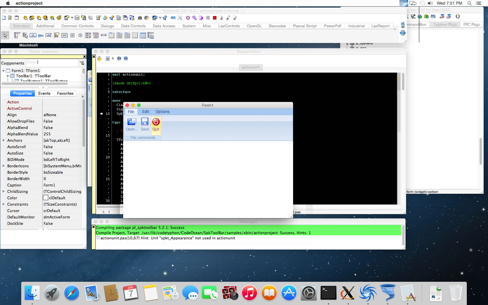

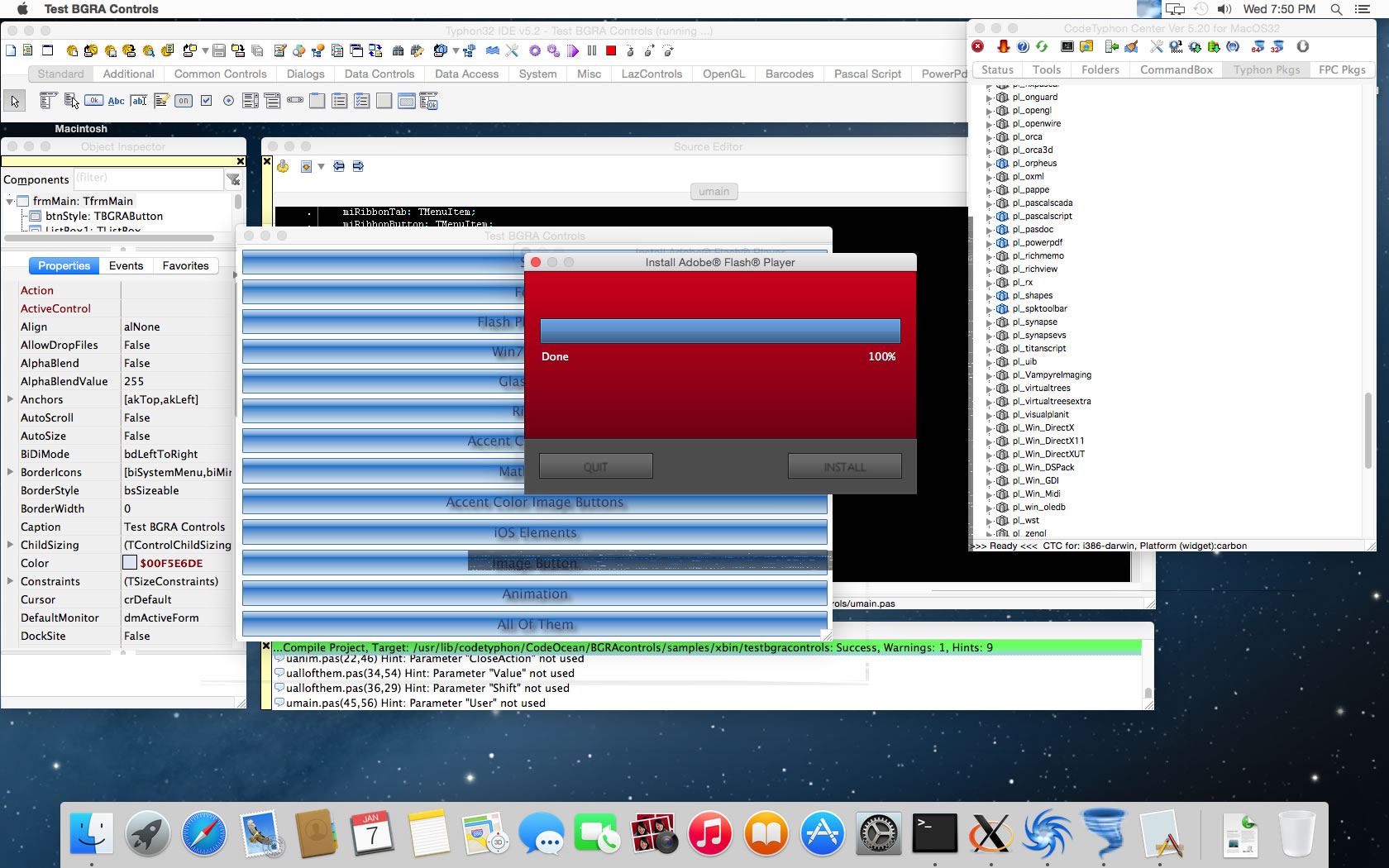

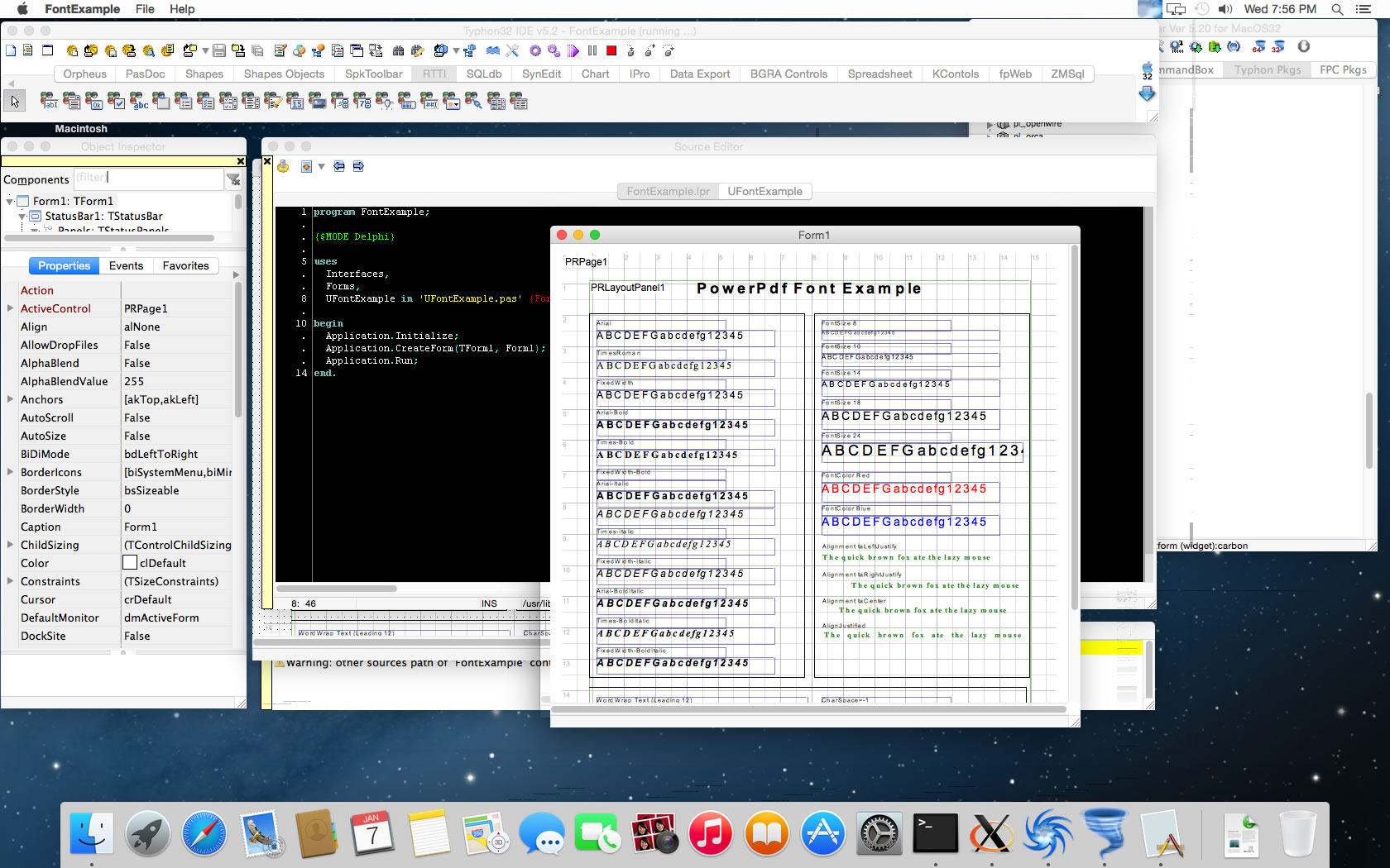

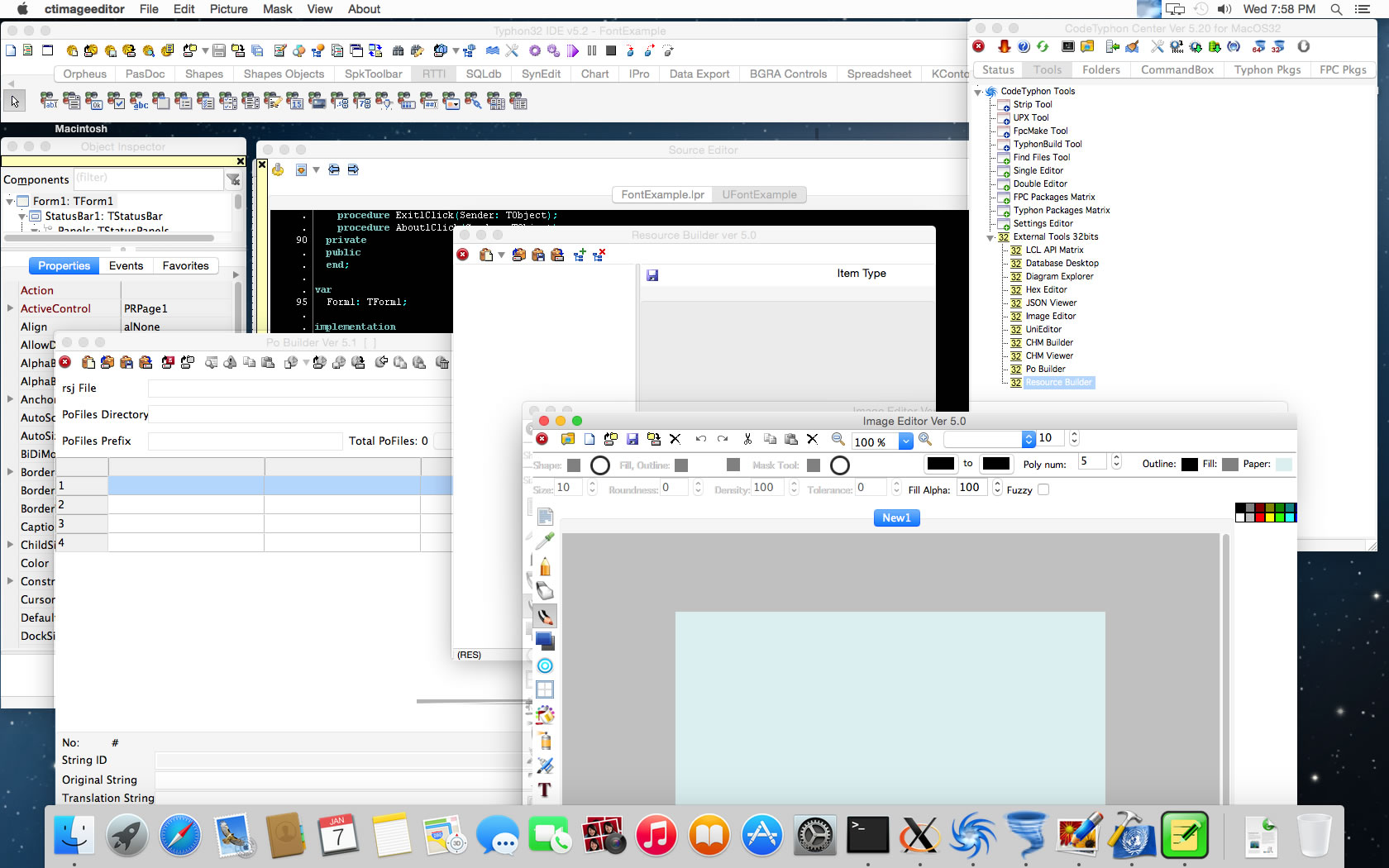

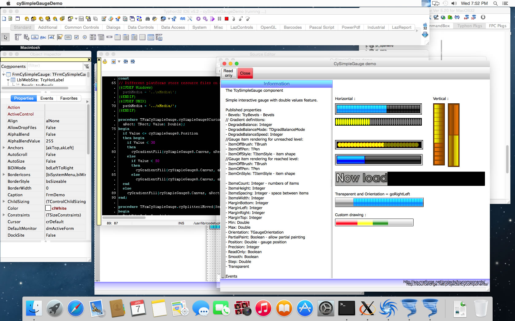

General CT tests list :
-CT System libraries installation (MultiArch)
-CT Installation (MultiArch)
-CT Build All procedure
-CT Update procedure
-FreePascal compiler tests (MultiArch)
-Typhon IDE tests (MultiArch only for 32bit)
-Typhon IDE tools tests (MultiArch only for 32bit)
-CodeOcean samples tests
pl_ExControls,,
pl_Graphic32,
pl_PowerPDF,
pl_SpkToolBar,
pl_Cindy,
etc...

Ct 5.20
MAC Yosemite 10.10.1
Smooth install. No problems.
Very Great job, Sternas and team!!
Thanks very much :)

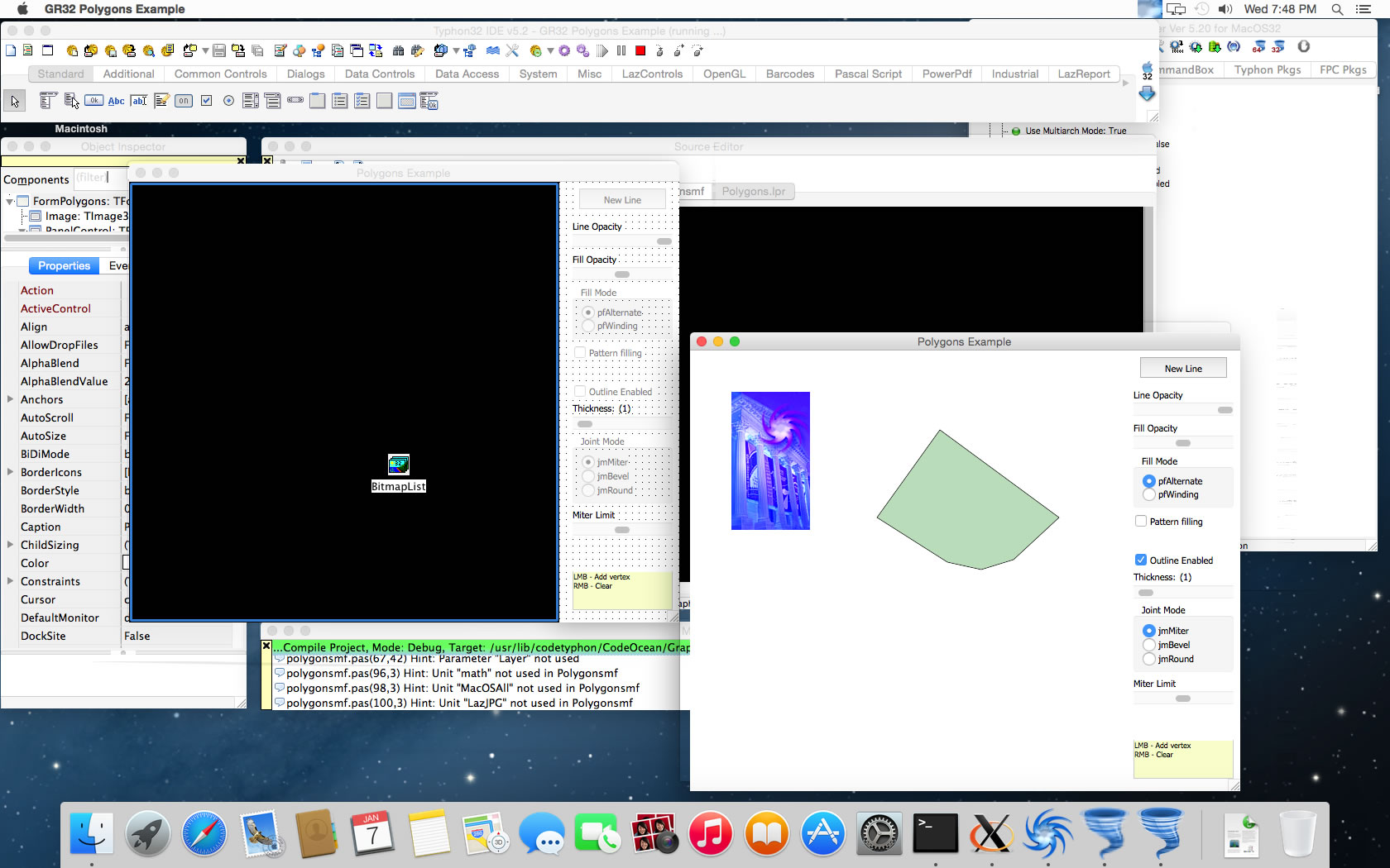

  • Posts: 51
Other question my friend. I see several packages like ins and zeos don't compile. Just reporting. Best regards.
