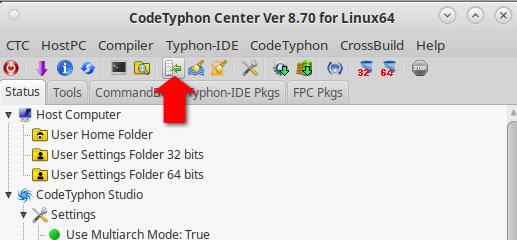

Close TyphonIDE
Open CTCenter
Restore Default Settings
The following user(s) said Thank You: Adaptive Business Applications

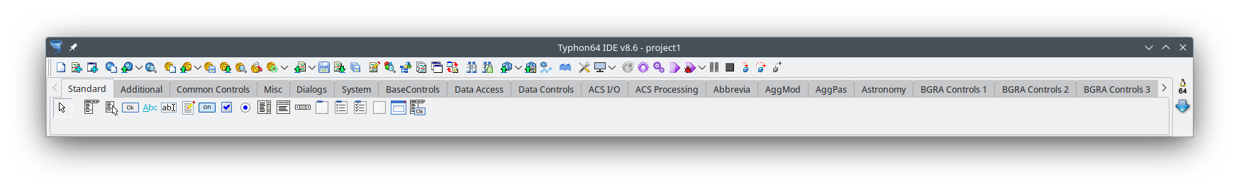

Help - I accidentally messed up my IDE 1st line Menu at the top. 1 year 7 months ago #18869
  • Adaptive Business Applications
  • Adaptive Business Applications's Avatar Topic Author
  • Posts: 20
Hi, here is the screen shot.
Help - I accidentally messed up my IDE 1st line Menu at the top. 1 year 7 months ago #18870
  • Posts: 1435
  • Thank you received: 231
This is NOT normal,
TyphonIDE MainMenu is always visible.
Please give us more info
-Linux distribution
-Desktop Platform
-TyphonIDE Build Platform
etc

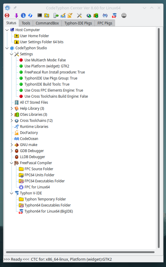

Also here is a screen shot of CTC which is missing a lot of options I think:
Last edit: by Sternas Stefanos. Reason: just to ensure image shows

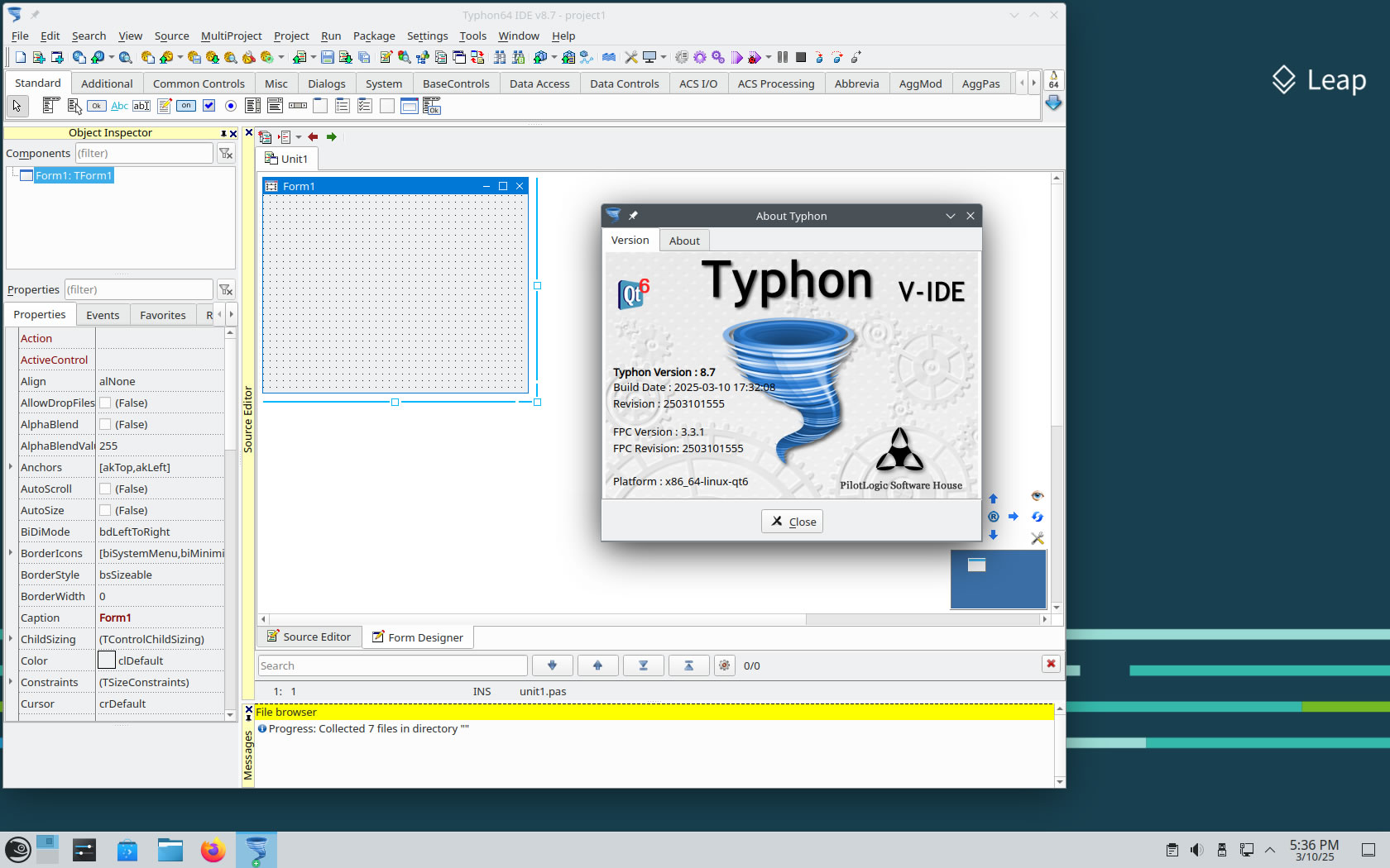

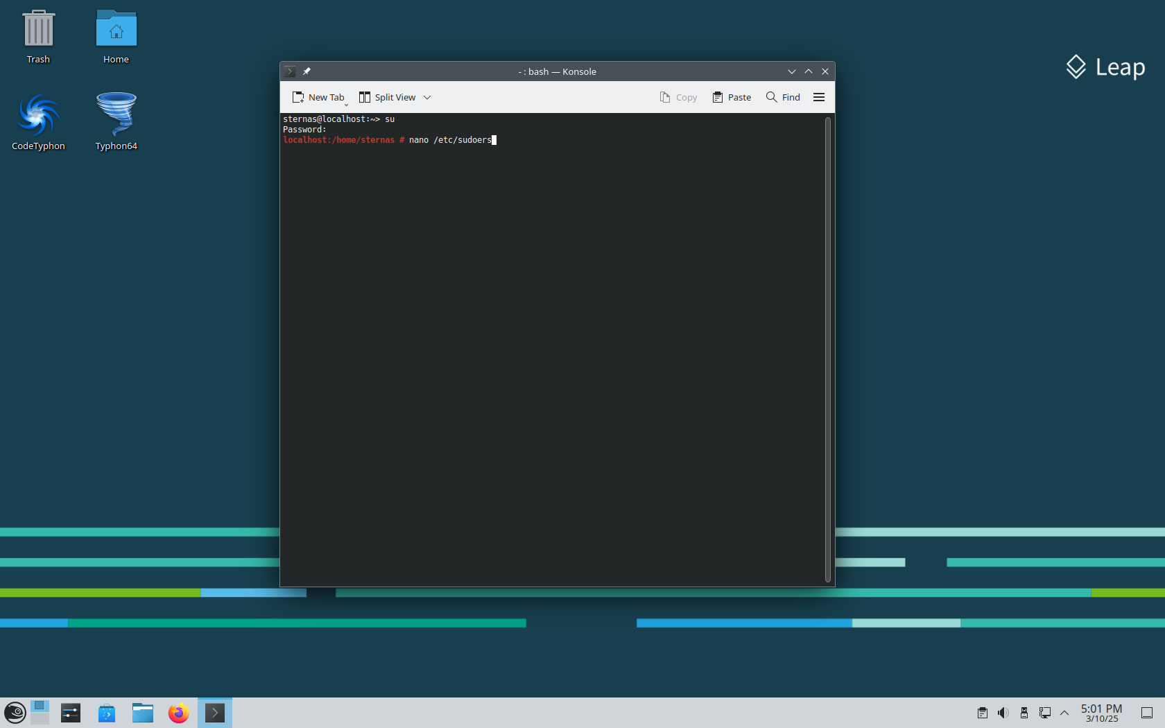

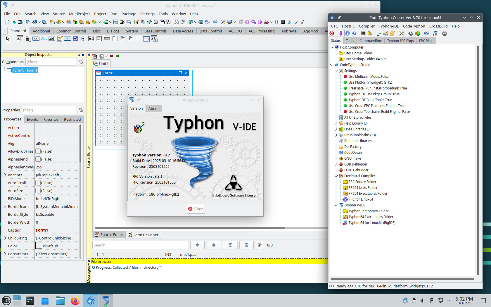

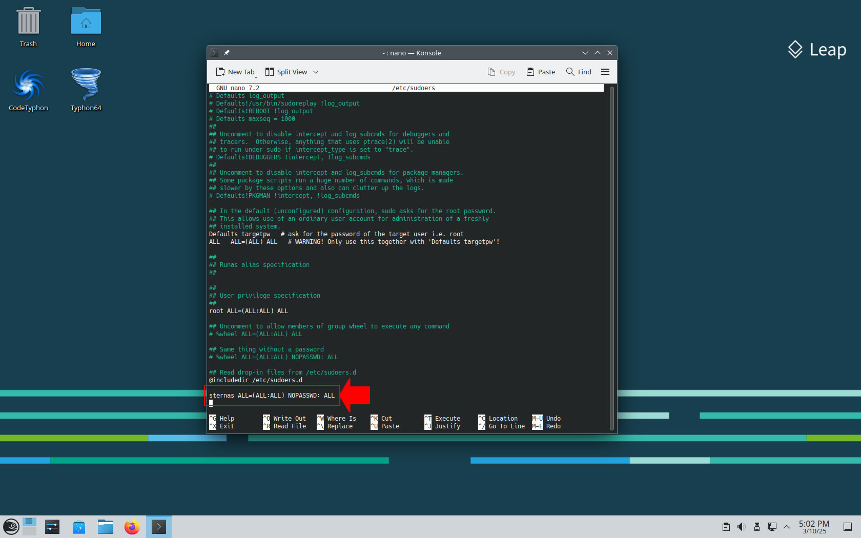

Help - I accidentally messed up my IDE 1st line Menu at the top. 1 year 7 months ago #18873

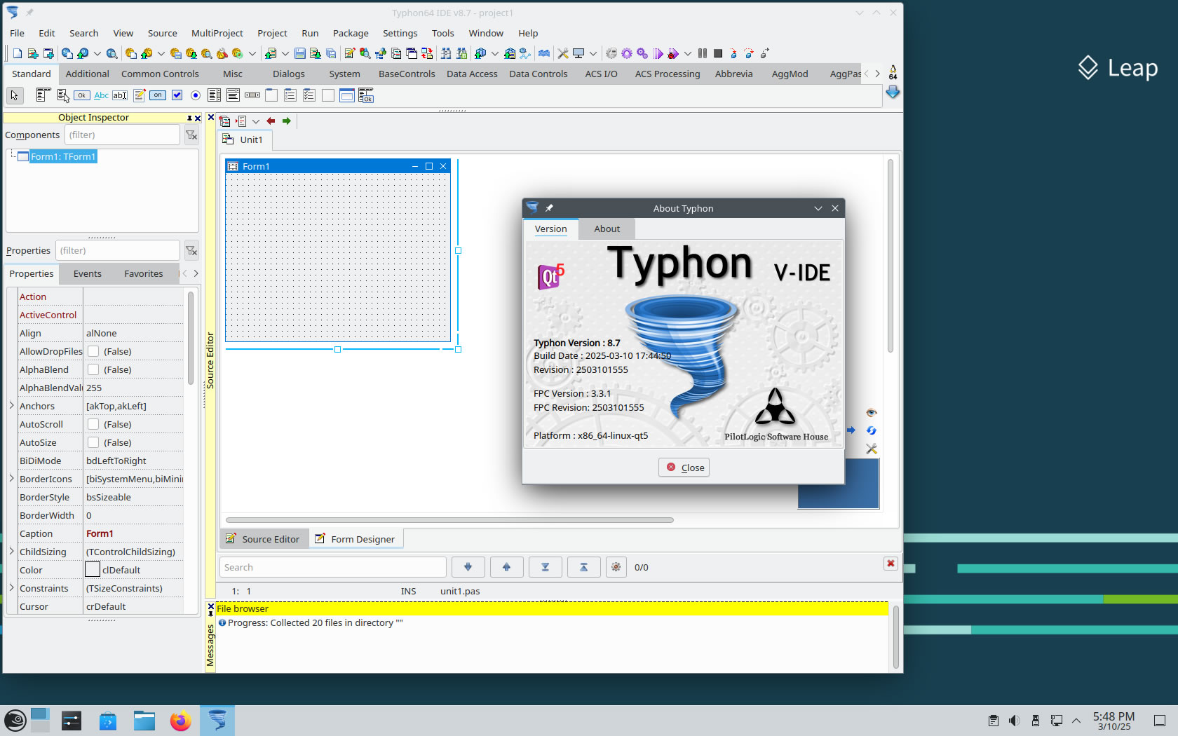

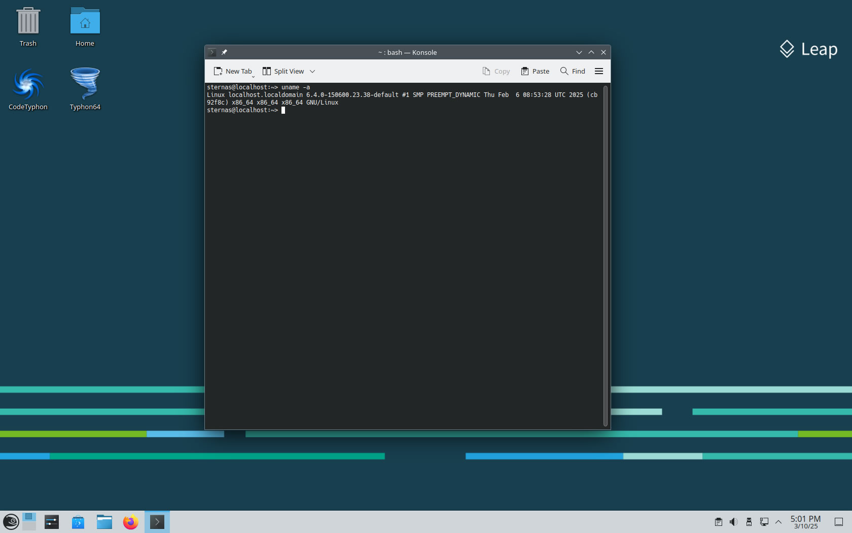

The problem is
Your CodeTyphon installation user don't have "sudo" root privileges
My suggestion:
Remove CodeTyphon and
Follow this tutorial
And some Pics from our tests on openSUSE-Leap-15.6 with KDE Desktop...
My /etc/sudoers file, username = sternas
CT for GTK2
CT for QT6
CT for QT5
