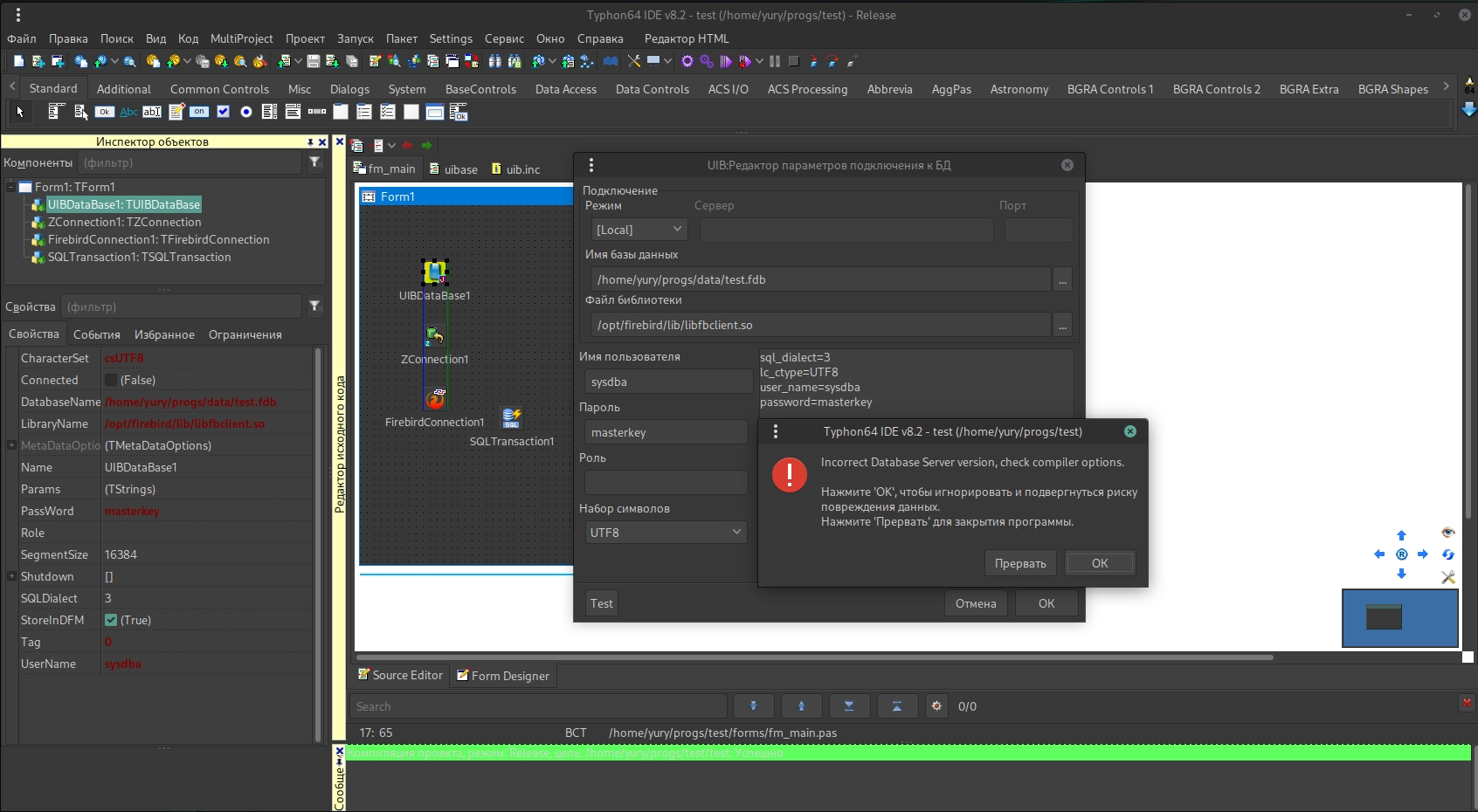

Good afternoon. When trying to use Firebird 4 and UIB under Linux, he encountered an error - "Incorrect Database Server version".
When using ZEOS, there is no such error. Everything is fine on Windows.
An example in the attachment. Firebird version 4.03, CT 8.21.
What am I doing wrong? Or is it a mistake in the pl_UIB package?

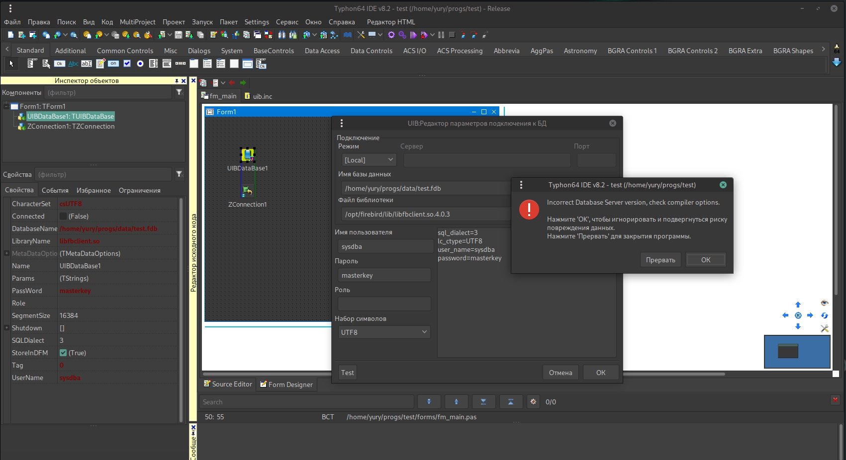

Give to
UIBDataBase1
property LibraryName
then correct file
for sample libfbclient.so.4.0.3
or
the full path of libfbclient.so.x.x

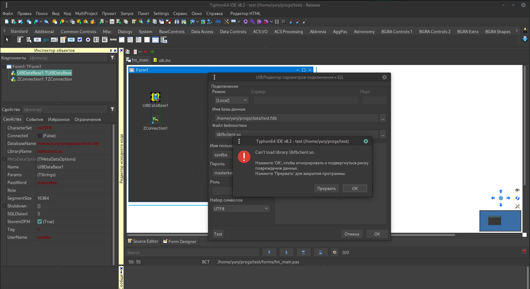

I did just that - screenshot 2. And received an error message - "Incorrect Database Server version".

Replaced the uibase.pas file, reassembled CodeTyphon. Unfortunately, the result is the same (screenshot in the attachment). CT 8.21, Linux Manjaro-cinnamon-22.0. Everything works on Windows.
