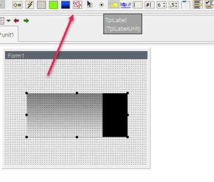

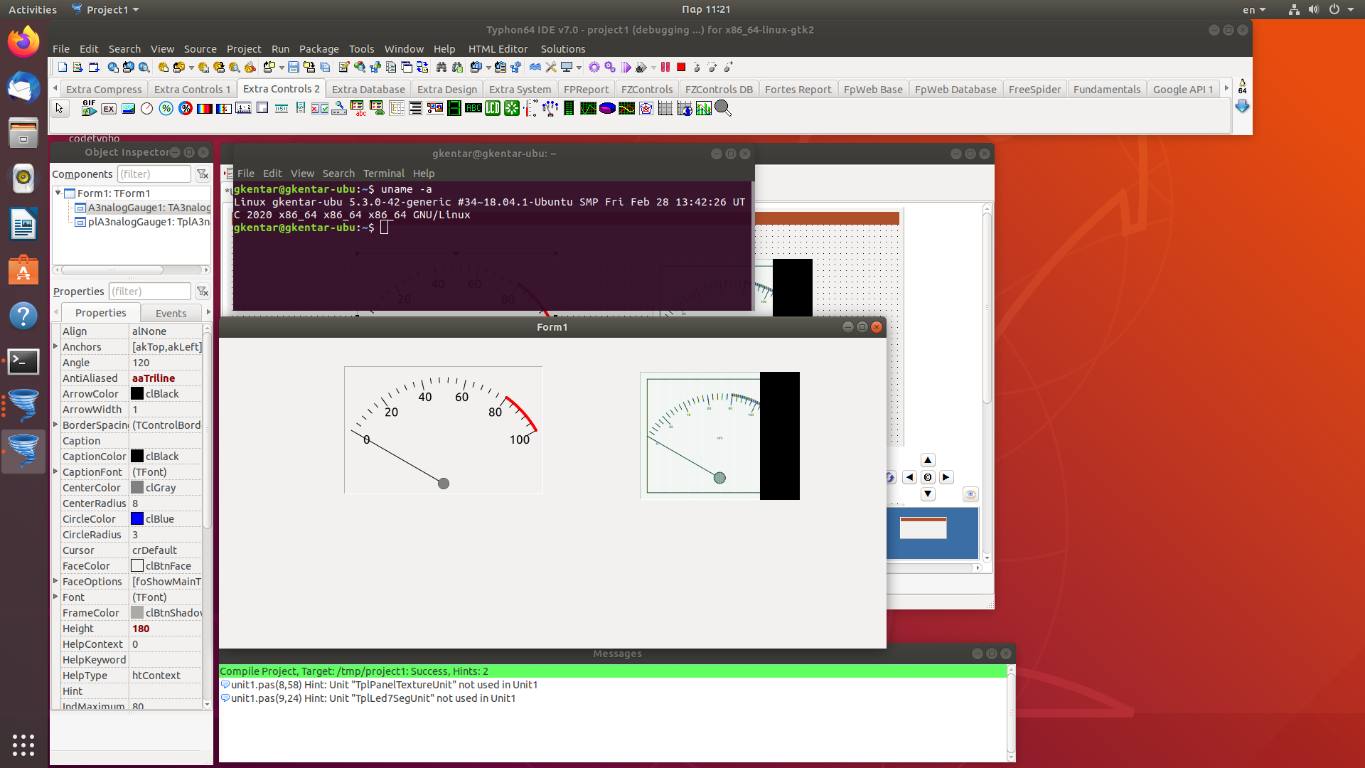

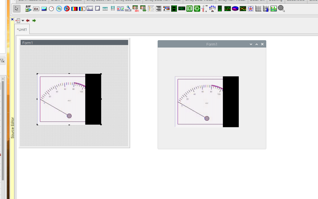

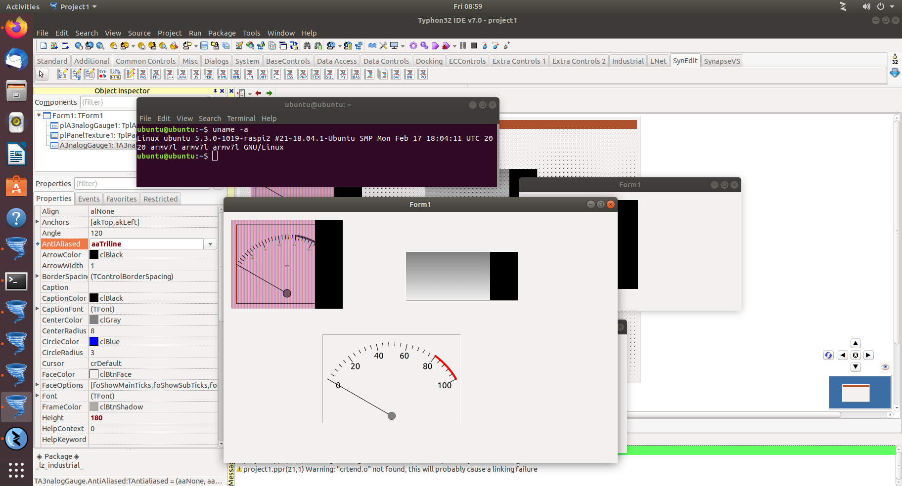

I am using A3nalogGauge component in Extra Controls2 Tab . When I set in Antialiased property any other value except aaNone in Object Inspector i see the result in attached screenshots.
IDE CT 6.8 installed in Raspberry 4/4G. The AnalogogGauge component from industrial package ''renders'' ok in CT 6.8 Iin Raspberry.
A3nalogGauge in CT 6.8 installed on Windows 10 renders ok.
Any solution ?

Texture panel component from Extra Controls 1 Tab has the same problem

Also happens in Rpi4 /4G , running Ubuntu Gnome
Δεν θα πέθαινα ποτέ για τα πιστεύω μου, γιατί μπορεί να είναι λάθος.

Also in my desktop Pc AMD 8G Ubuntu Gnome
