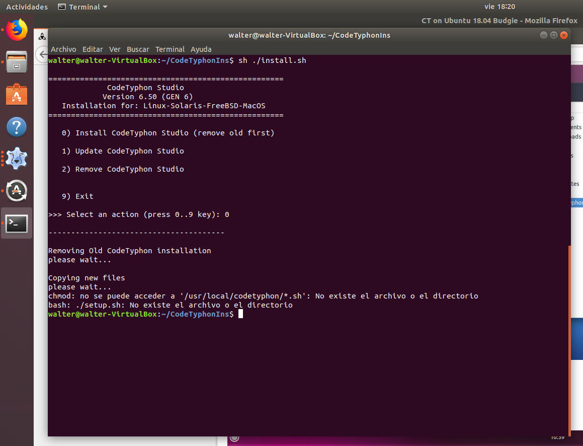

I can't install Ct on Ubuntu 18.04
I read this tutorial www.pilotlogic.com/sitejoom/index.php/wi...-ubuntu-18-04-budgie
But the install file told me:
chmod can't access to '/usr/local/codetyphon/*.sh'
that there isn't the file or directory: "bash ./setup.sh"

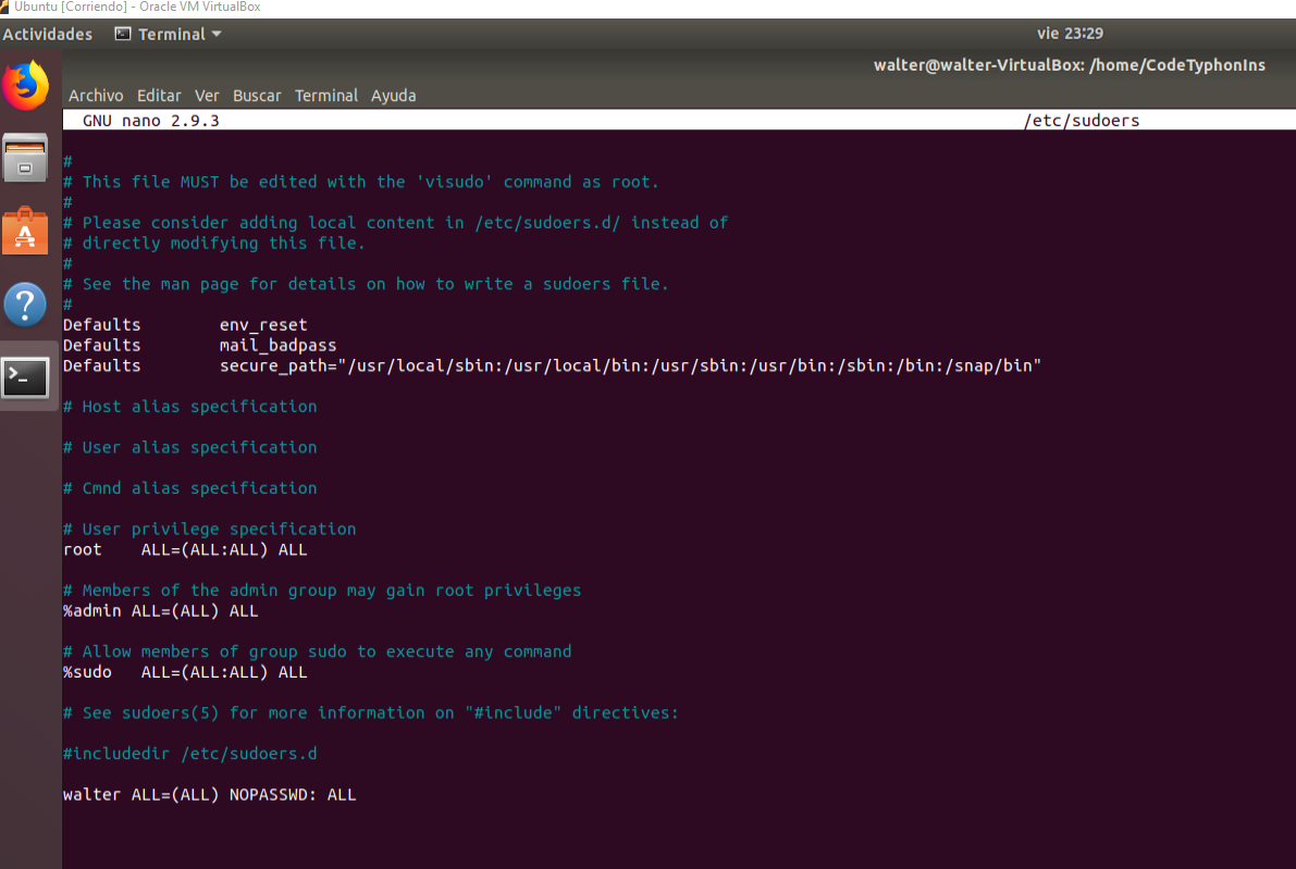

Did you add with
sudo nano /etc/sudoers
at the end of /etc/sudoers the line
<<username>> ALL=(ALL) NOPASSWD: ALL
Can't install CT on Ubuntu 18.04 8 years 2 months ago #12022
  • taqtaq
  • taqtaq's Avatar Topic Author
Yes
Can't install CT on Ubuntu 18.04 8 years 2 months ago #12026
my suggestion
remove manual the CT directory /usr/local/codetyphon/
from your OS
-Download CT again
-and start new installation
PS: We test in our LAB CT on Ubuntu Mate (32, 64 and arm32) every day without any problem.
Can't install CT on Ubuntu 18.04 8 years 2 months ago #12030
  • taqtaq
Thanks Sir.
I could to install CT.
After you told me that remove the CT directory, download CT again and start a new installation, I decided install Ubuntu again and then, I followed your suggestions
I don't know what happened,may be, had been a wrong Ubuntu installation, so I did a new full Ubuntu installation.
Now CT is working.
Thank you very much.
