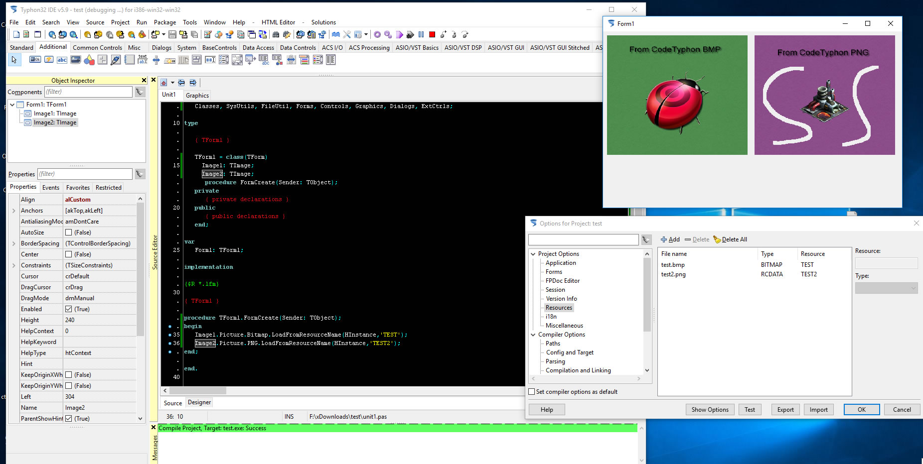

Only 1 line
   Image1.Picture.Bitmap.LoadFromResourceName(HInstance,'TEST');
   Image2.Picture.PNG.LoadFromResourceName(HInstance,'TEST2');
look at Screen and test the new test.zip
clear out directory before build or re-build test project
The following user(s) said Thank You: avanleyen
