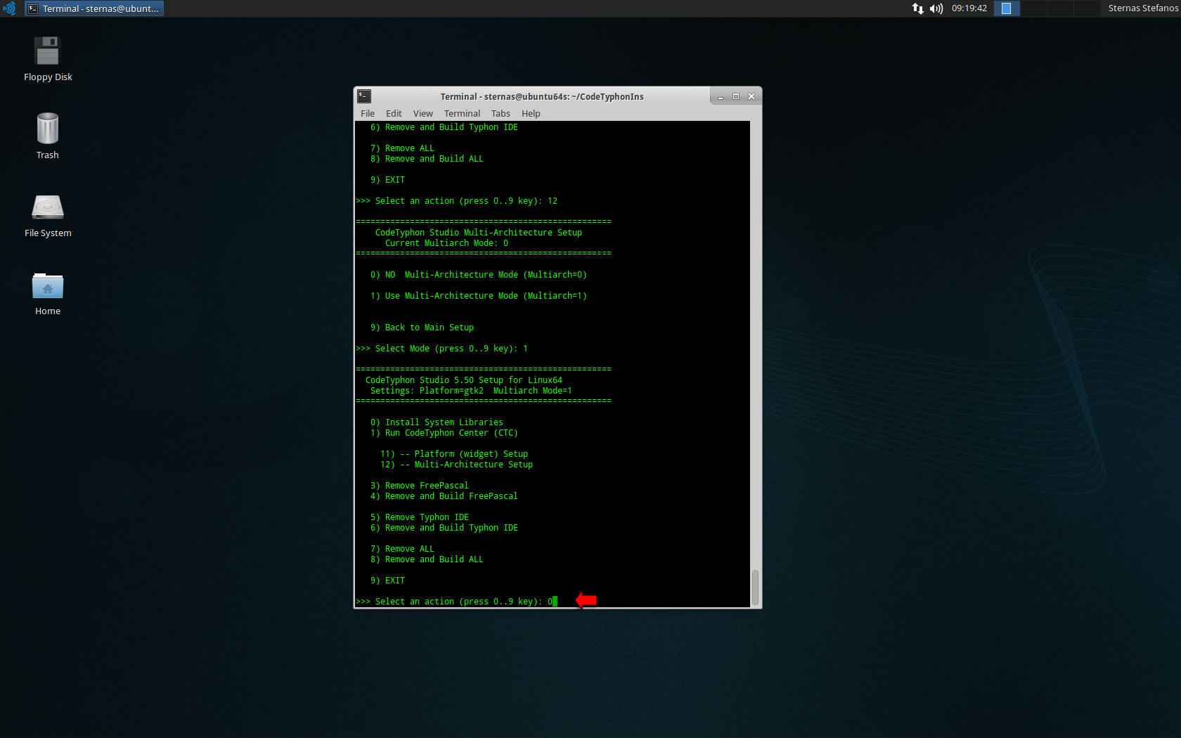

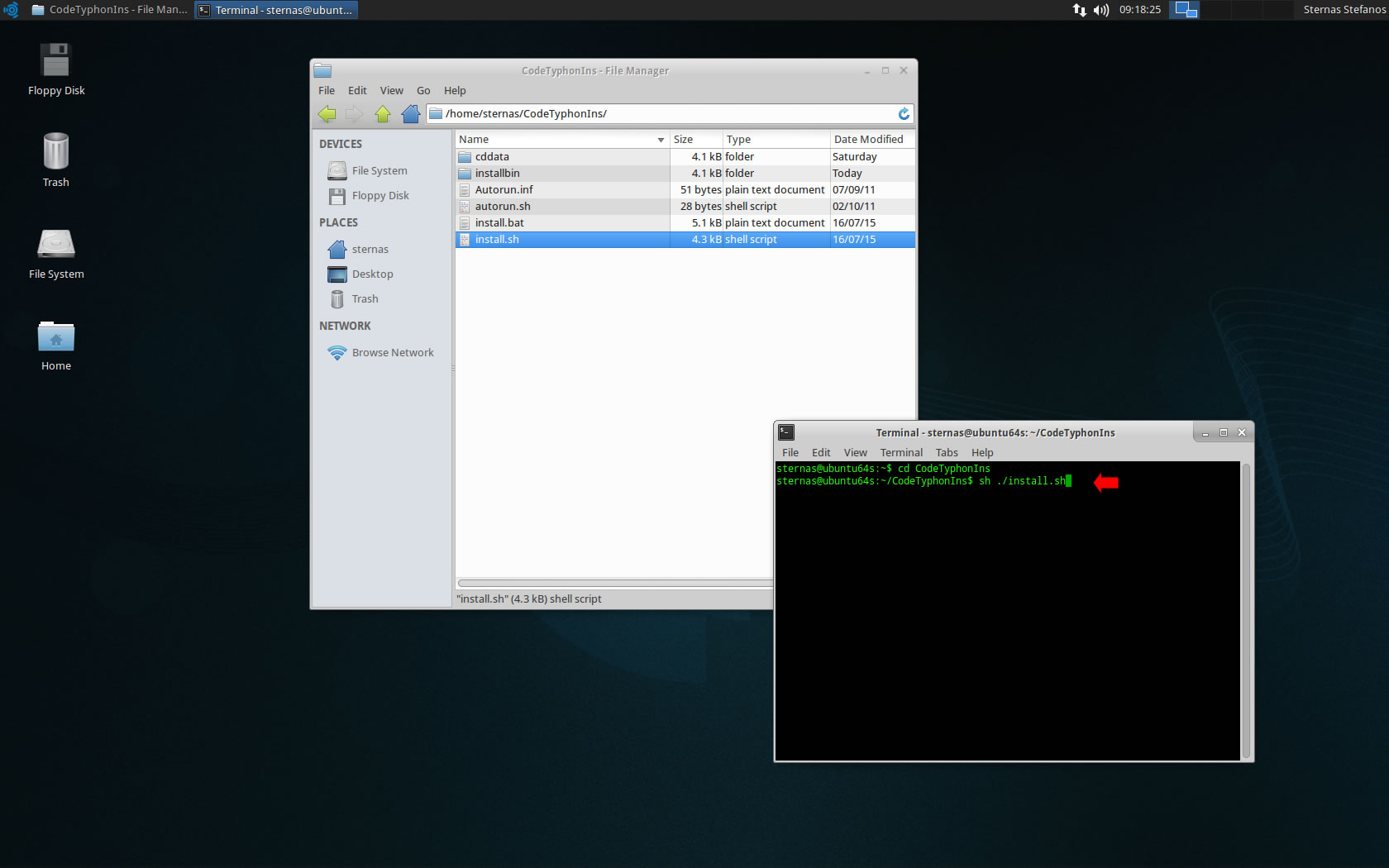

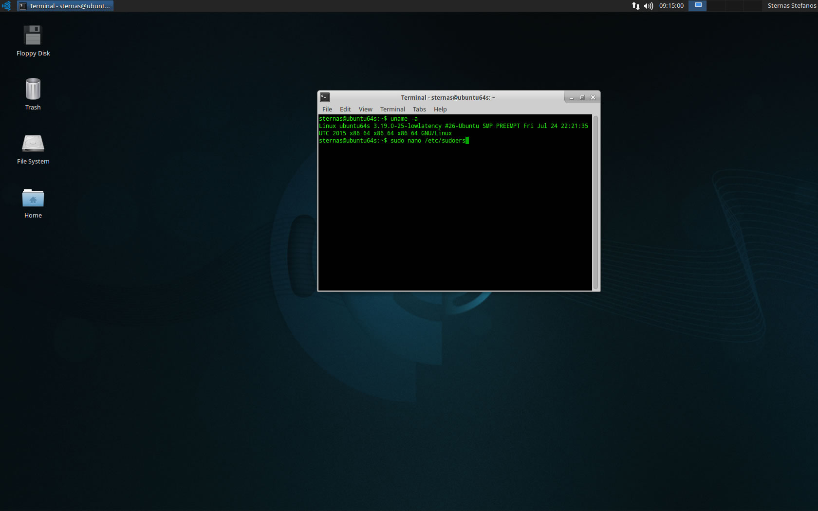

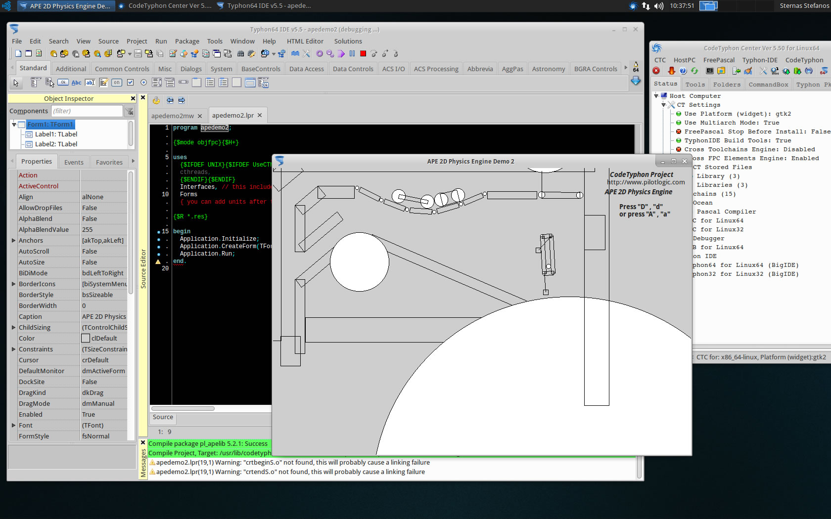

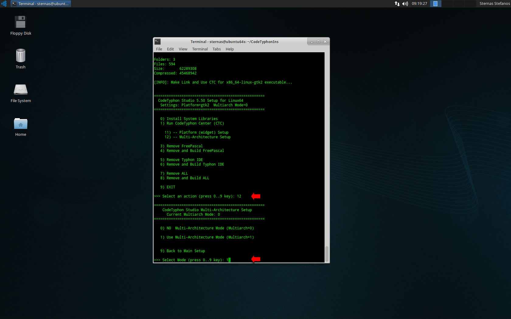

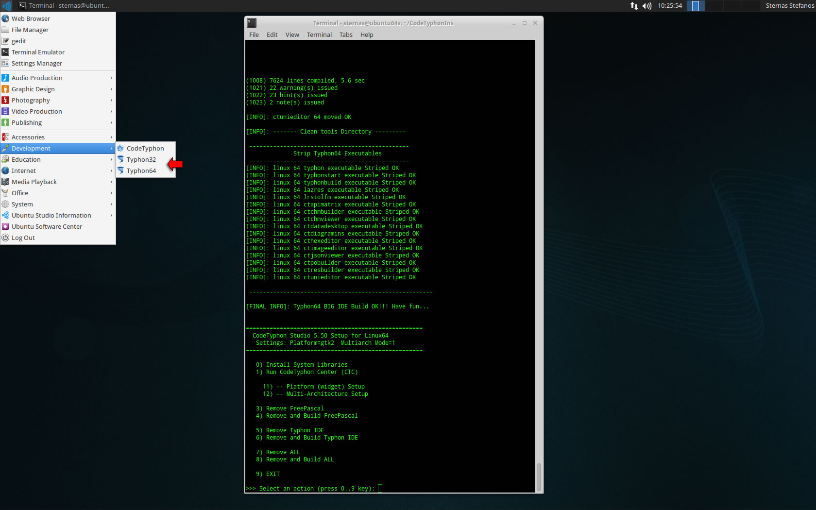

We test LAB CodeTyphon ver 5.50 on
Ubuntu Studio 15.04 with Xfce Desktop info
Some screens from CodeTyphon Installation and Build procedure for GTK2:
(All actions are the same as any other CT host OS)

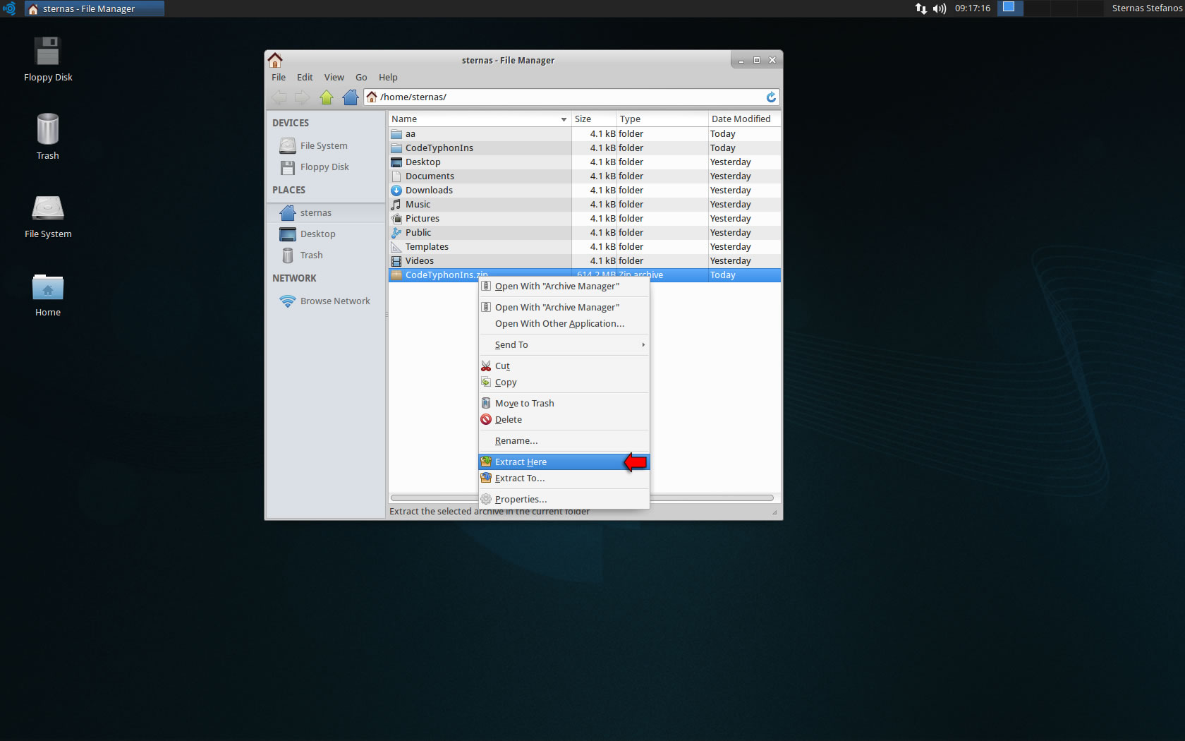

1)-Download CodeTyphonIns.zip

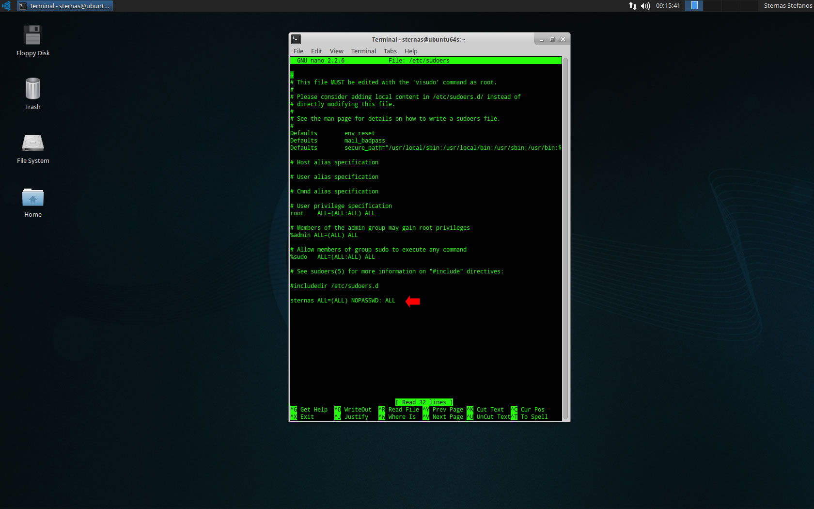

sudo nano /etc/sudoers
3)-UnZip CodeTyphonIns.zip

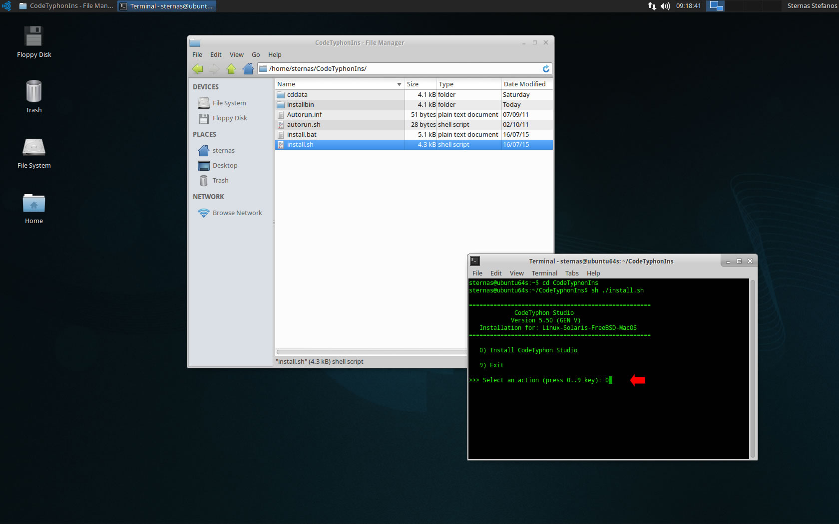

4)-Run install.sh from CT directory to Install CodeTyphon
5)-CT on Ubuntu 15.04 now has MultiArch Support. You can Select MultiArch=1 from "MultiArch Setup"

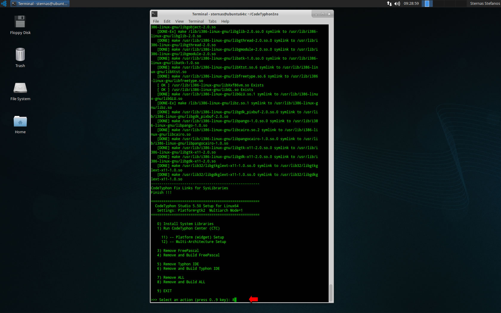

6)-Install "System Libraries" from CT setup script.

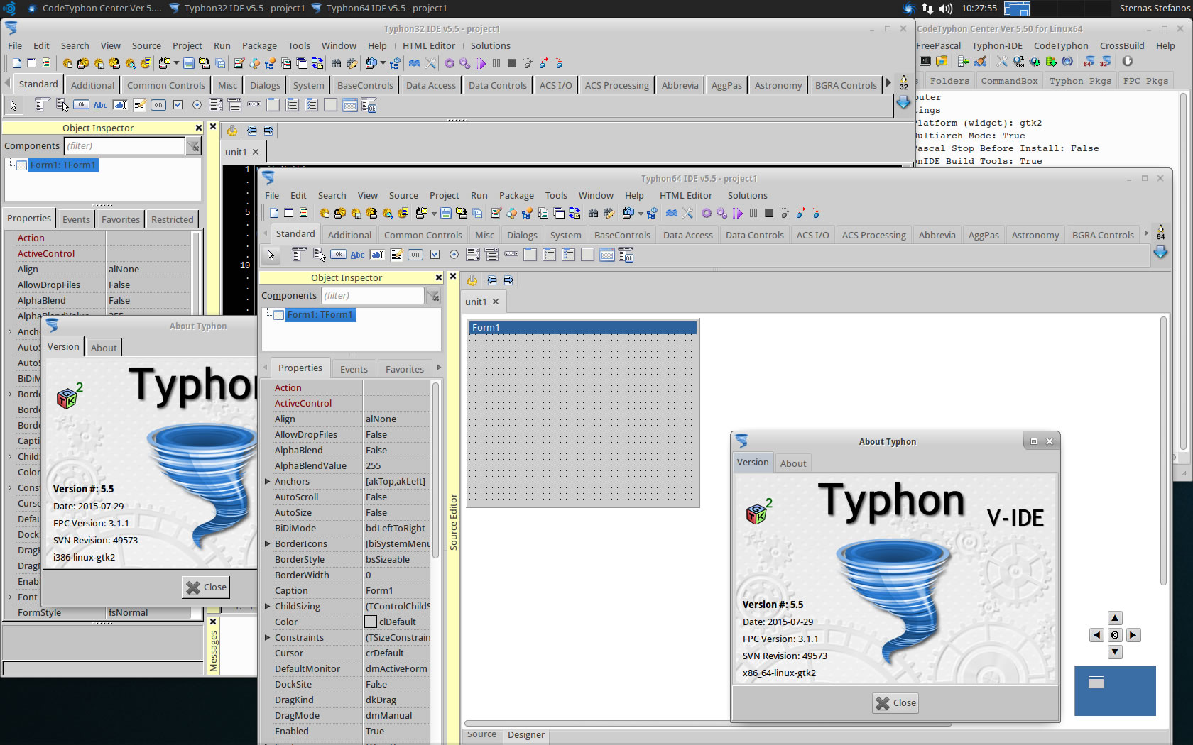

7)-Build ALL (Freepascal and Typhon IDE) from sources

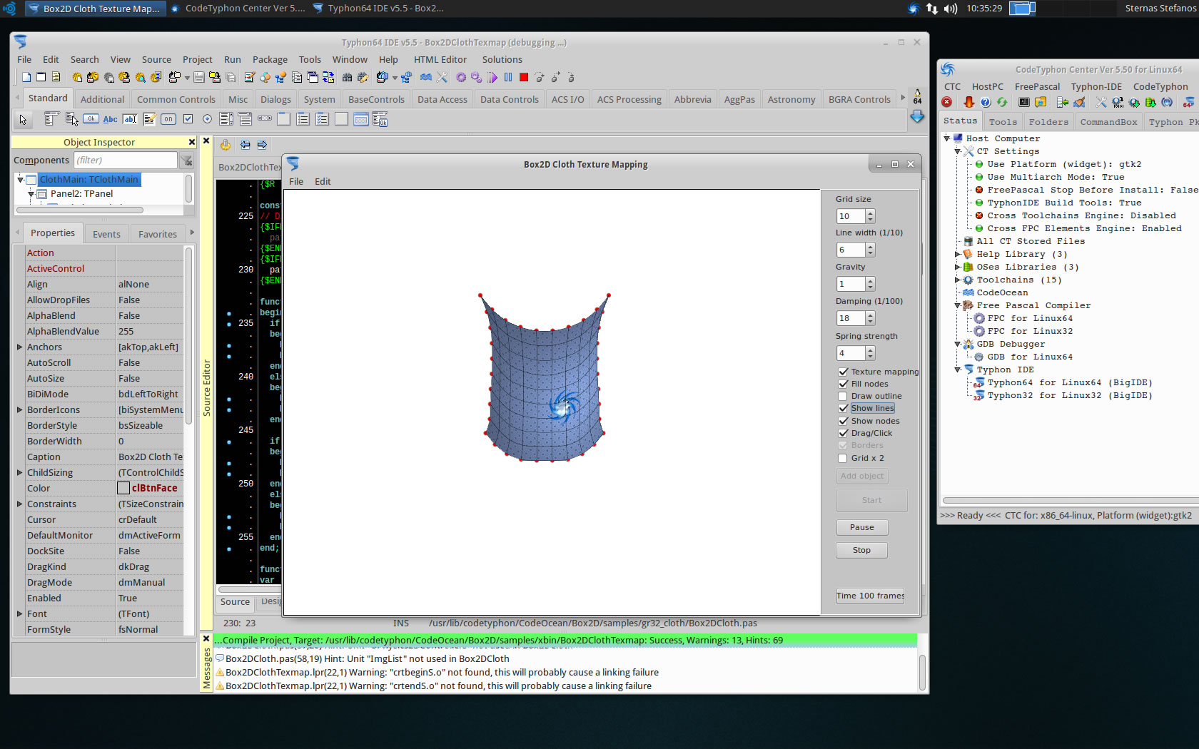

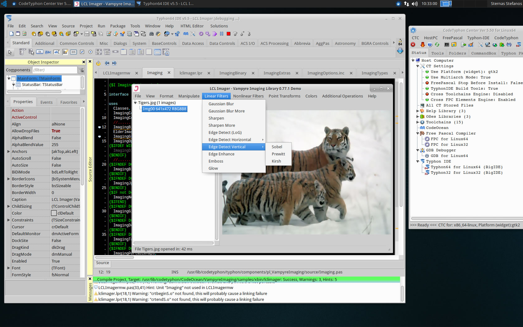

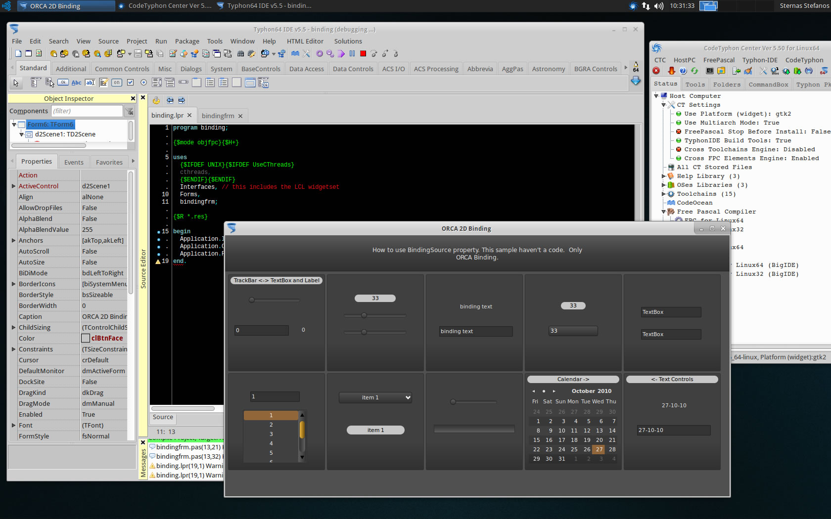

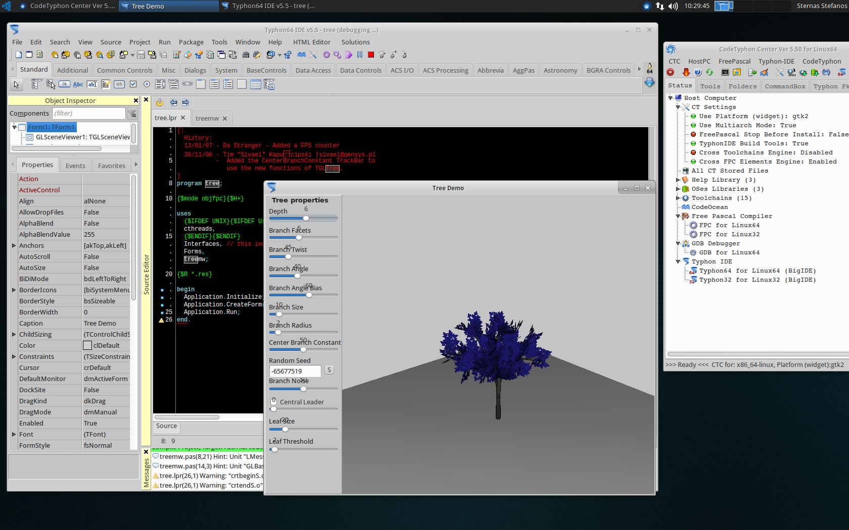

Some Libraries test on Xfce (GTK2) :
pl_GLScene,
pl_ORCA,
pl_VampyreImaging,
pl_Box2D
pl_APE

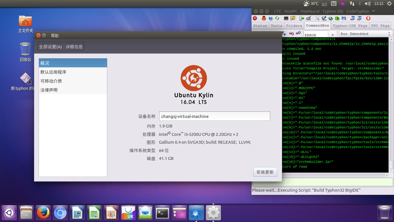

[LAB] CodeTyphon on Ubuntu Studio 15.04 9 years 11 months ago #9724
  • bjchang888
  • bjchang888's Avatar
  • Posts: 2
/usr/local/codetyphon/typhon/ide/main.pp(1055,67) Warning: (4105) Implicit strError: /usr/local/codetyphon/fpc/fpc64/bin/x86_64-linux/ppcx64 can't be executed, error message: Failed to execute "/usr/local/codetyphon/fpc/fpc64/bin/x86_64-linux/ppcx64", error code: -9
make[2]: *** [typhon] Error 1
Makefile:3794: recipe for target 'typhon' failed
make[2]: Leaving directory '/usr/local/codetyphon/typhon/ide'
make[1]: *** [ide] Error 2
Makefile:4212: recipe for target 'ide' failed
make[1]: Leaving directory '/usr/local/codetyphon/typhon/ide'
make: *** [ide] Error 2
Makefile:2751: recipe for target 'ide' failed
make: Leaving directory '/usr/local/codetyphon/typhon'
Error: (IDE) Build IDE: stopped with exit code 512
Error: (TyphonBuild) Building IDE: Building IDE failed.
[INFO]: make some links for Typhon64...
[ERROR]: Sorry, Typhon64 BIG IDE NOT Build
CodeTyphon Studio 5.70 Setup for Linux64
Settings: Platform=gtk2 Multiarch Mode=1
