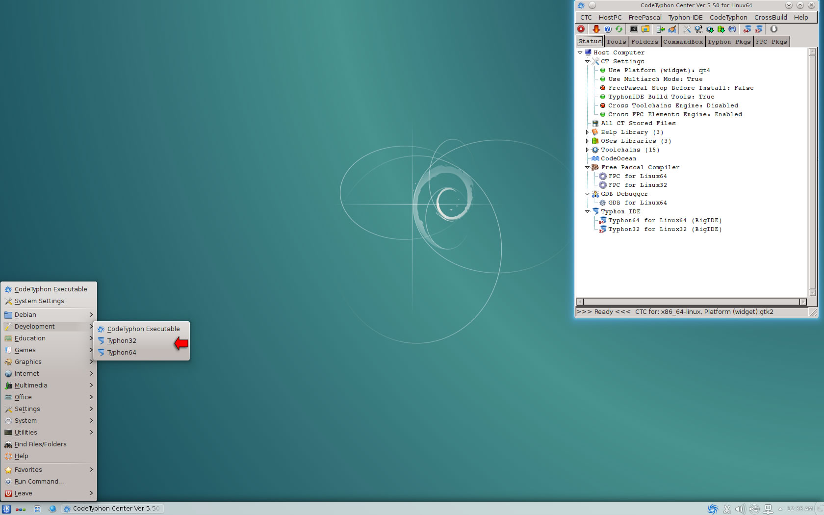

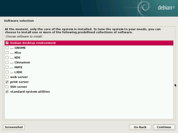

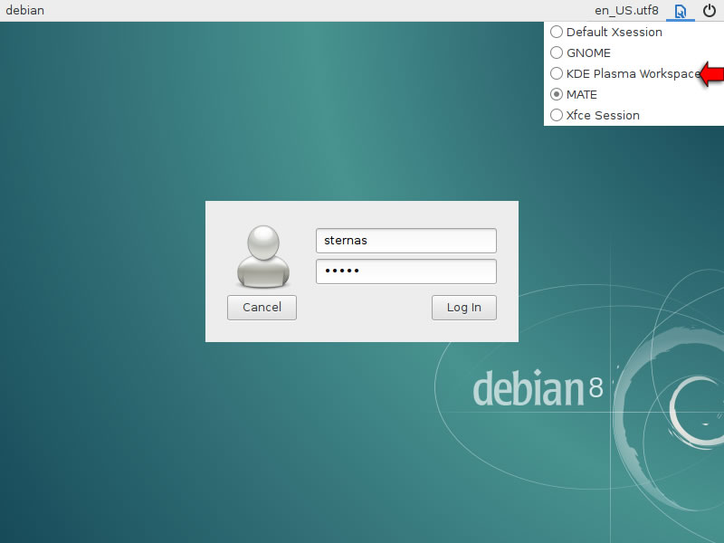

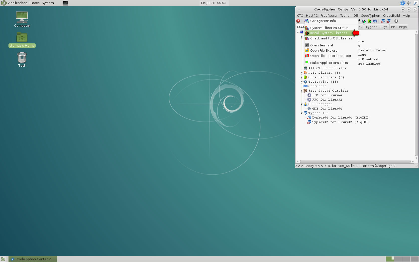

We test LAB CodeTyphon ver 5.50 on
Debian 8.x with MATE, KDE4 and Xfce Desktops info
one of our Lab Reference Linux.

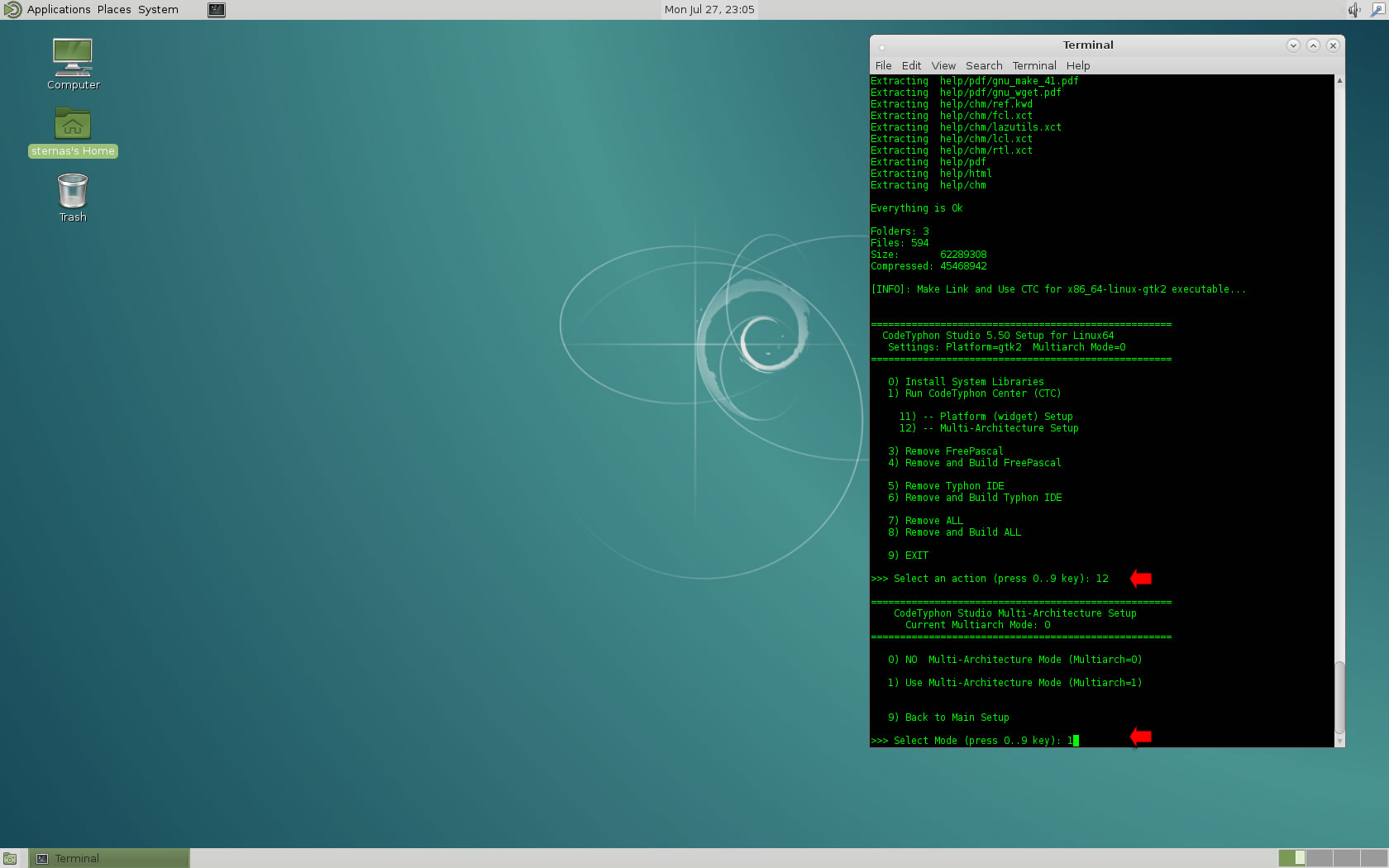

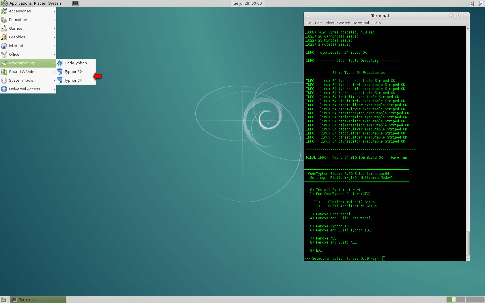

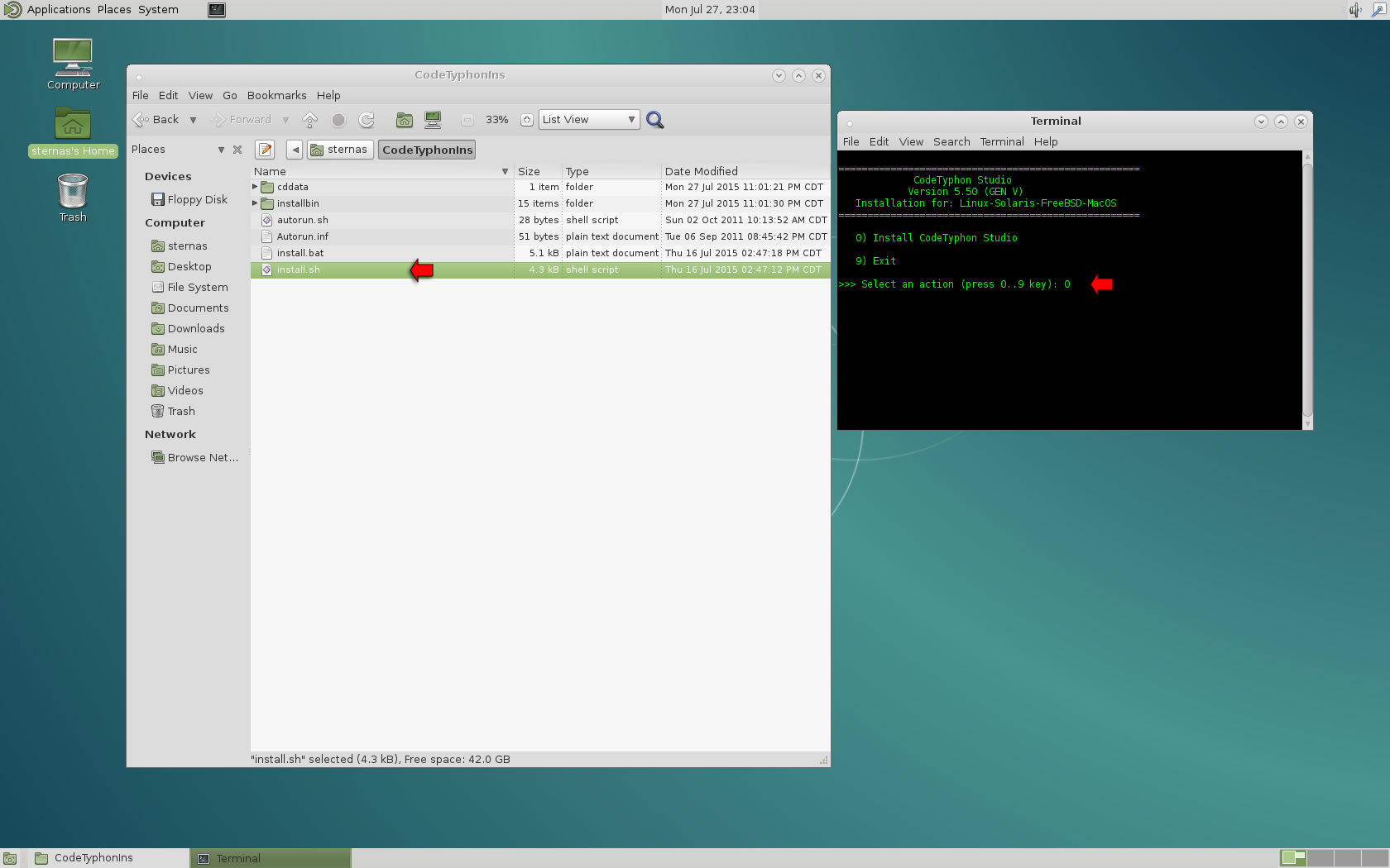

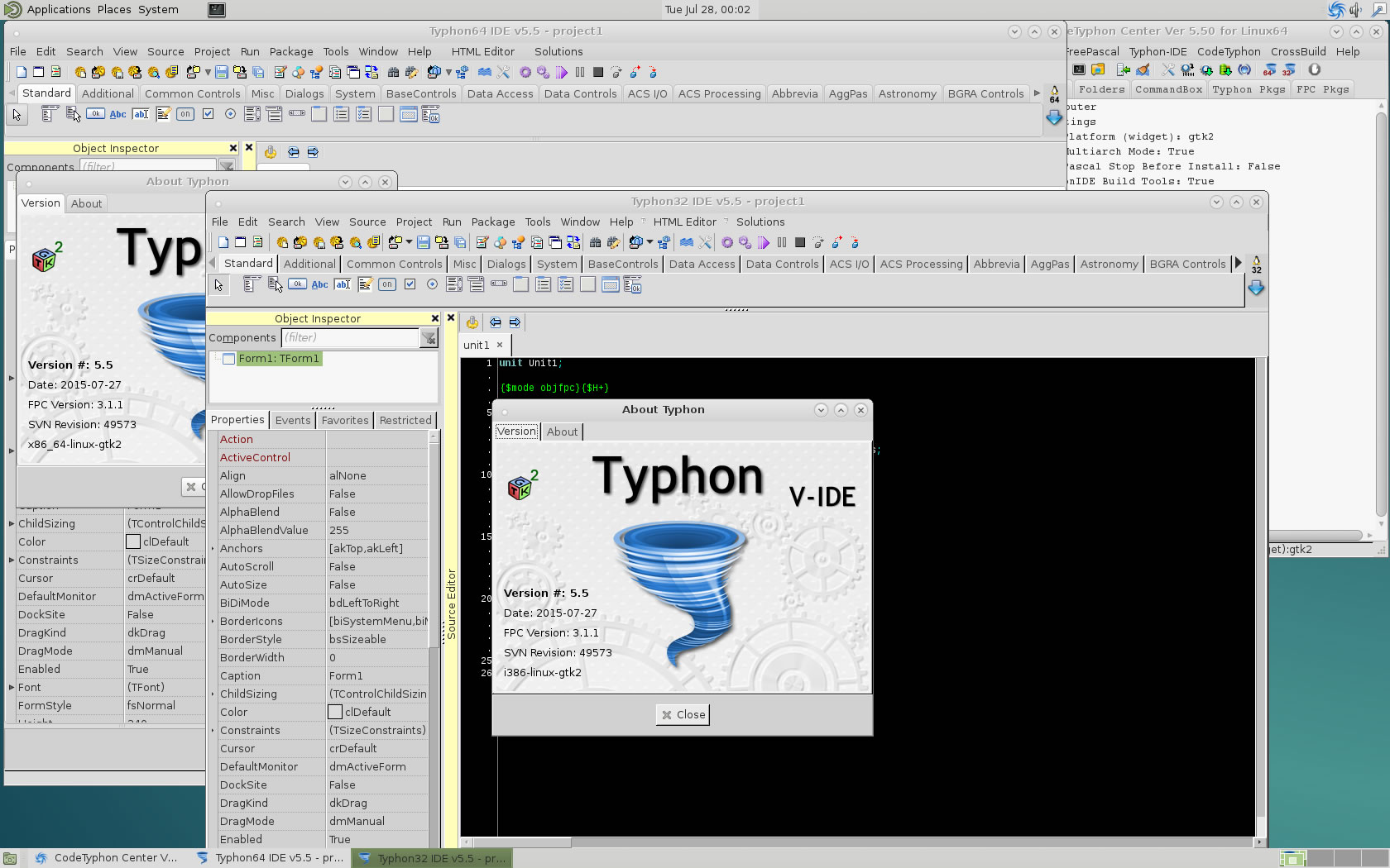

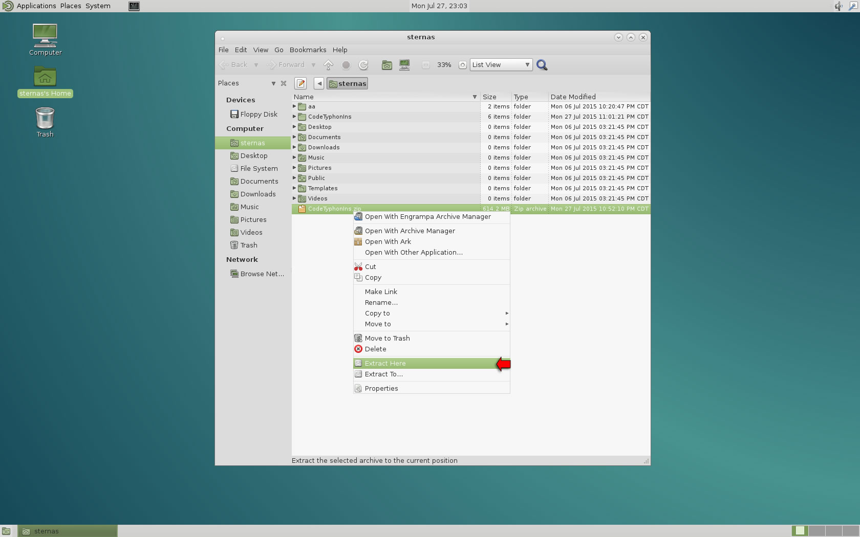

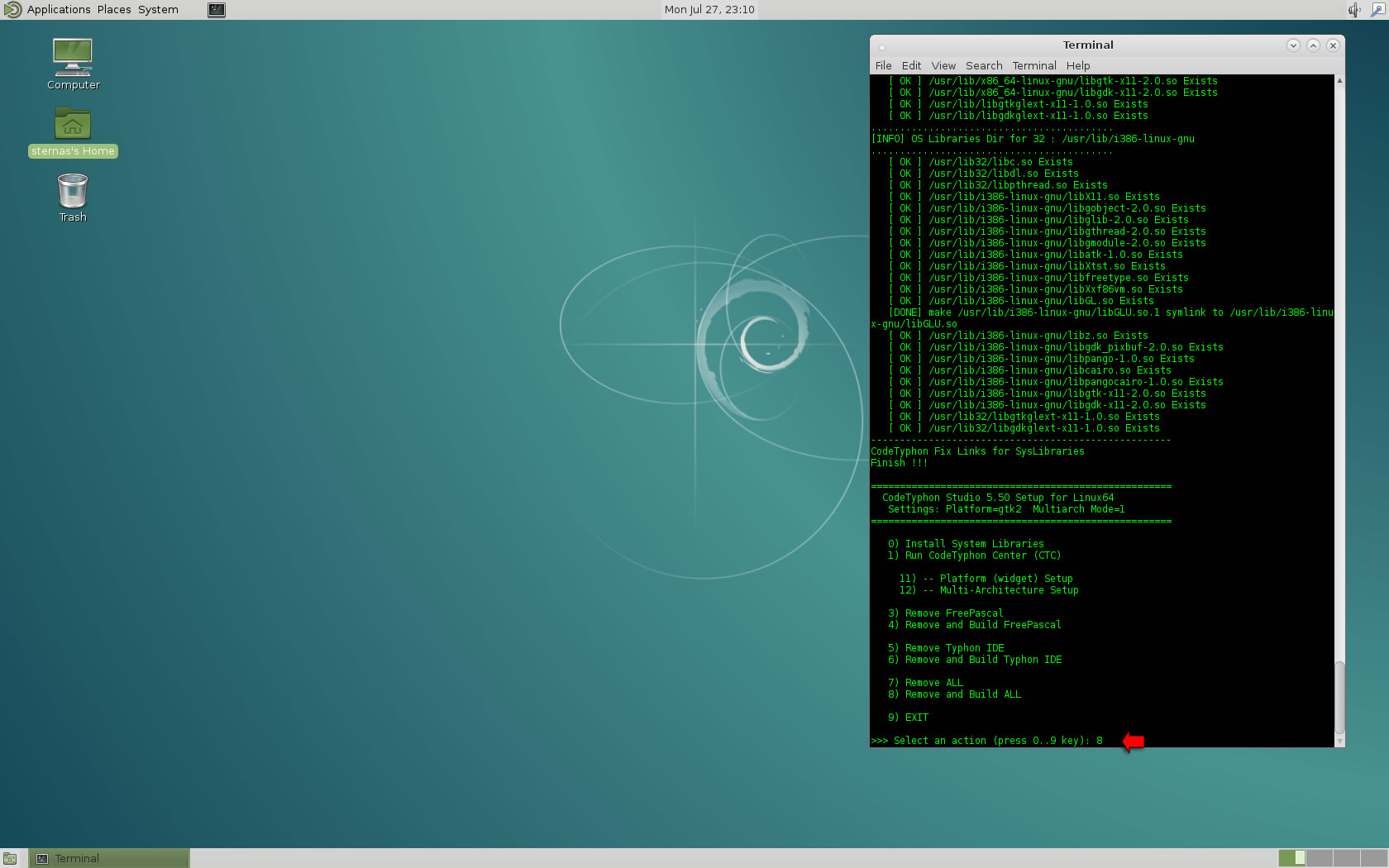

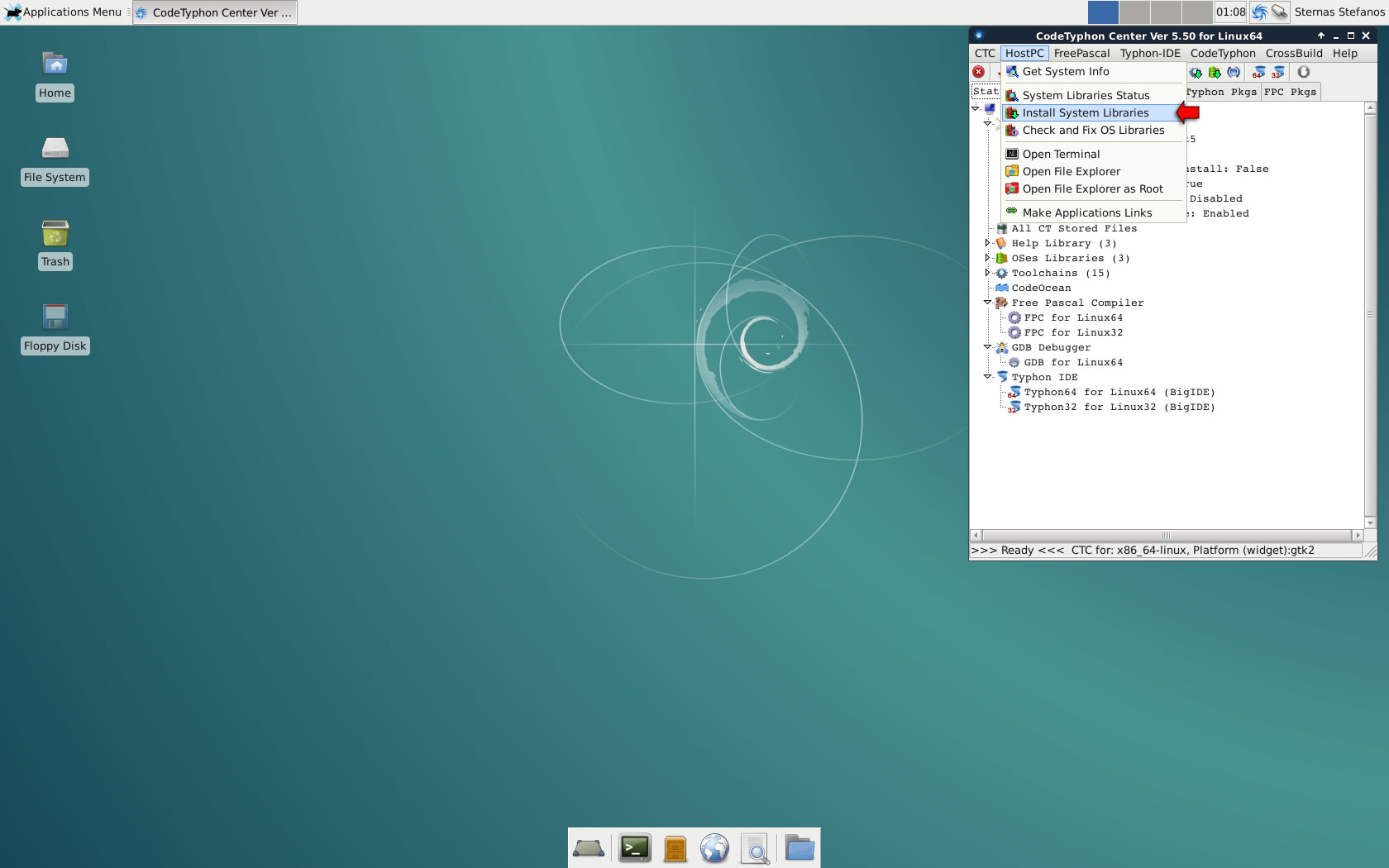

Some screens from CodeTyphon Installation and Build procedure for GTK2:
(All actions are the same as any other CT host OS)

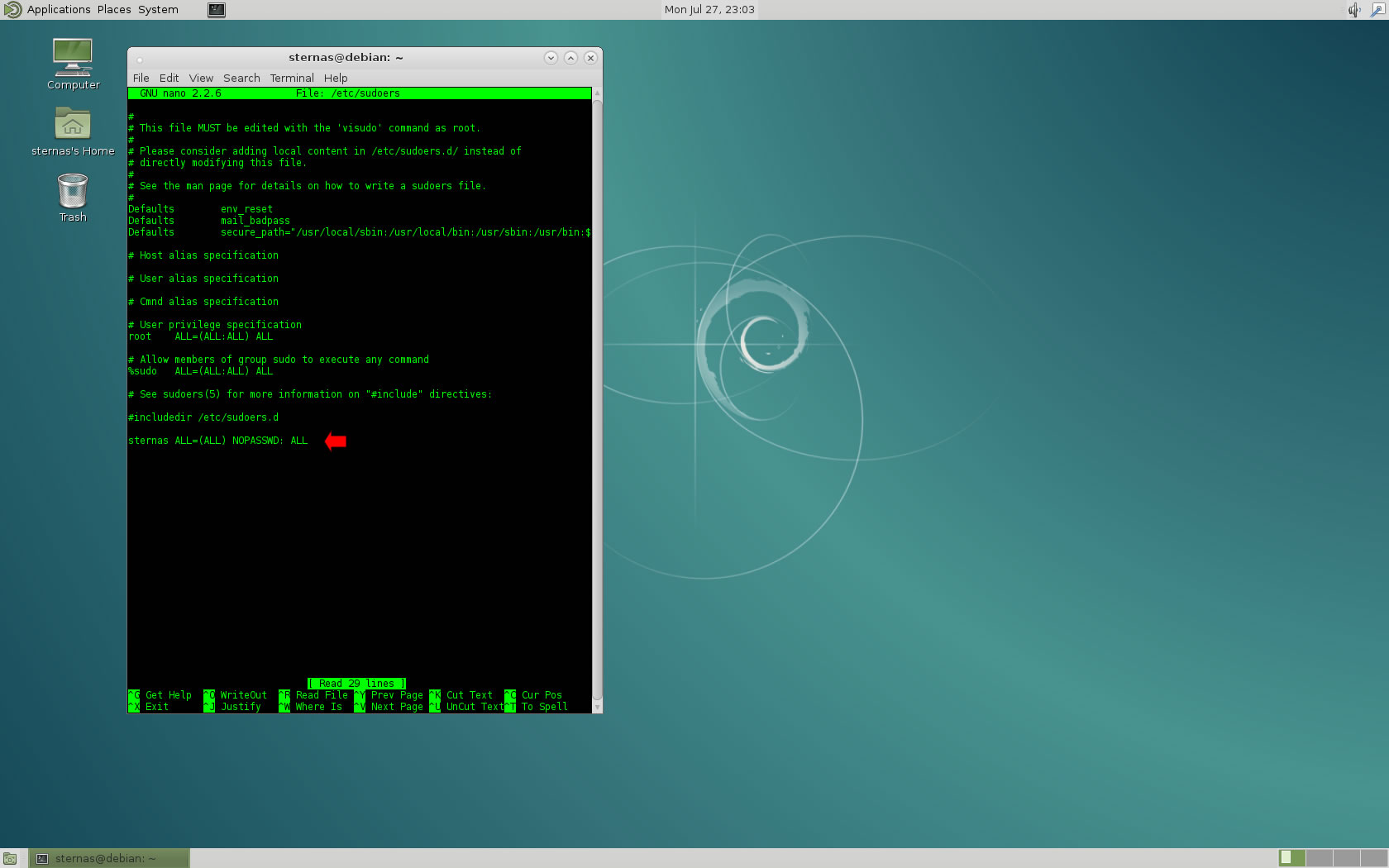

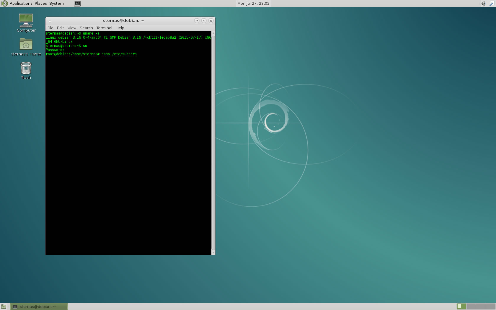

1)-Download CodeTyphonIns.zip
su
nano /etc/sudoers
3)-UnZip CodeTyphonIns.zip

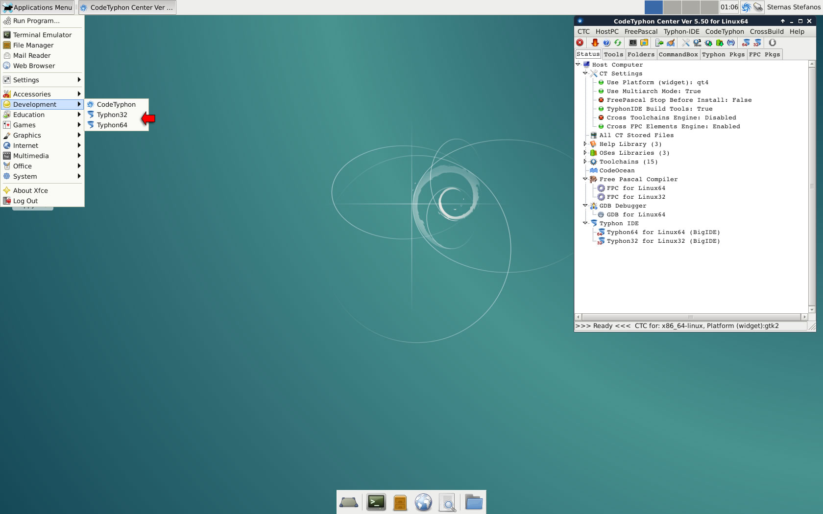

4)-Run install.sh from CT directory to Install CodeTyphon

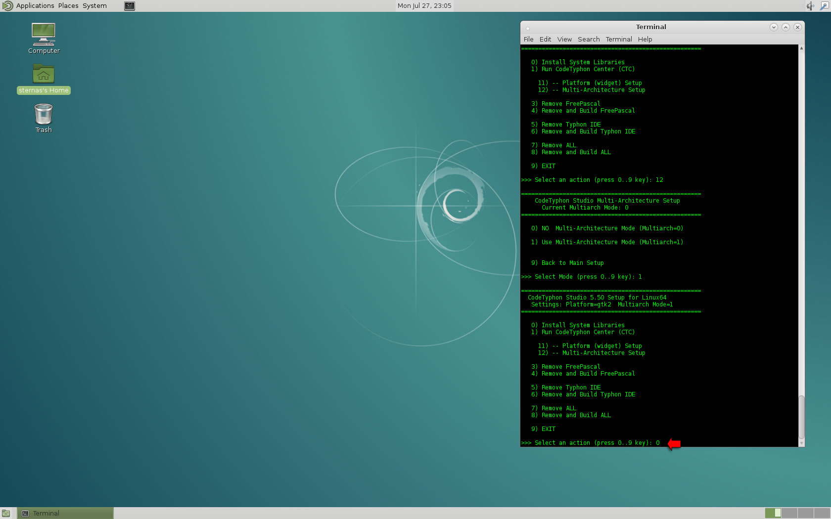

5)-CT on Debian 8.x now has MultiArch Support. You can Select MultiArch=1 from "MultiArch Setup"
6)-Install "System Libraries" from CT setup script.
7)-Build ALL (Freepascal and Typhon IDE) from sources

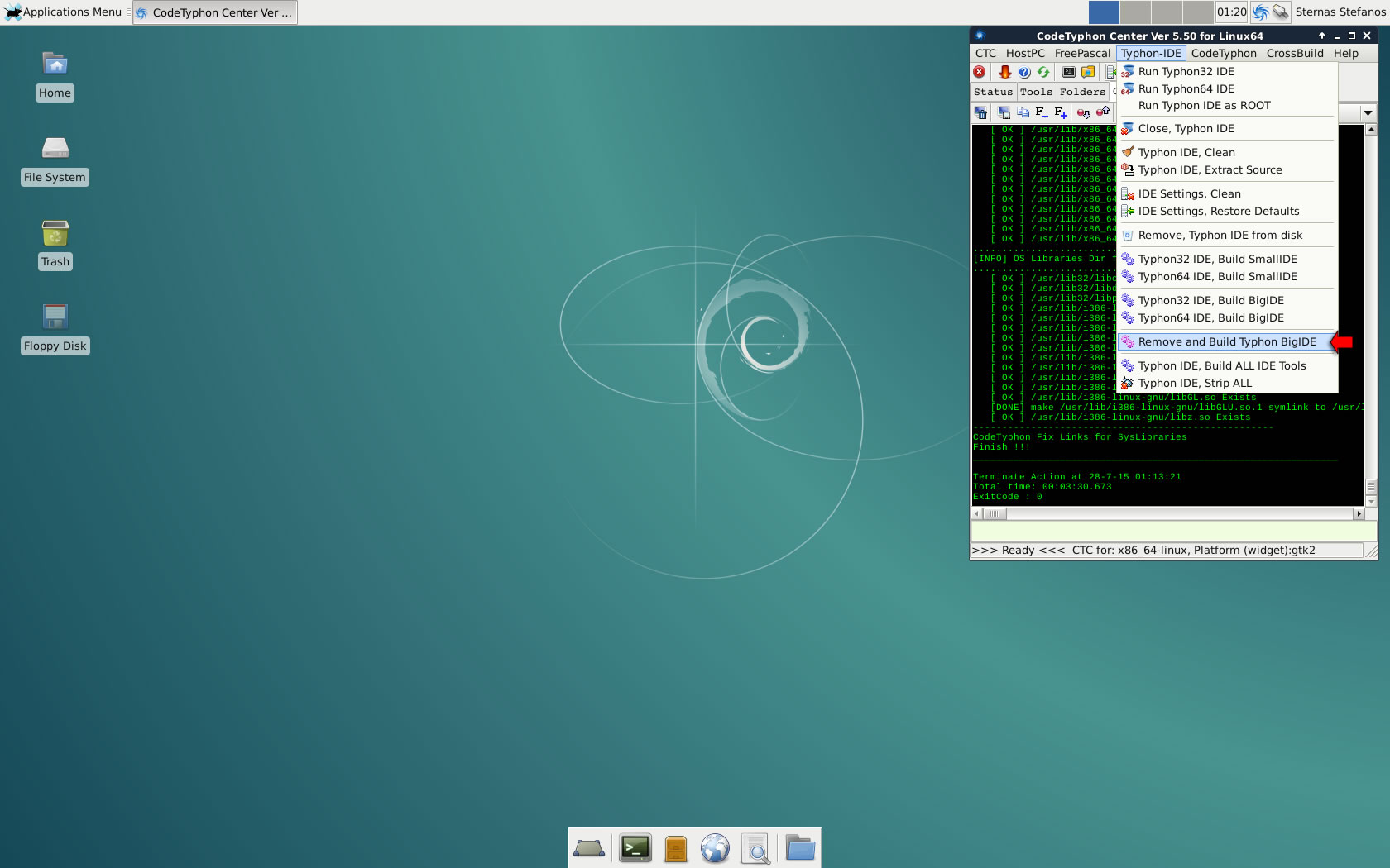

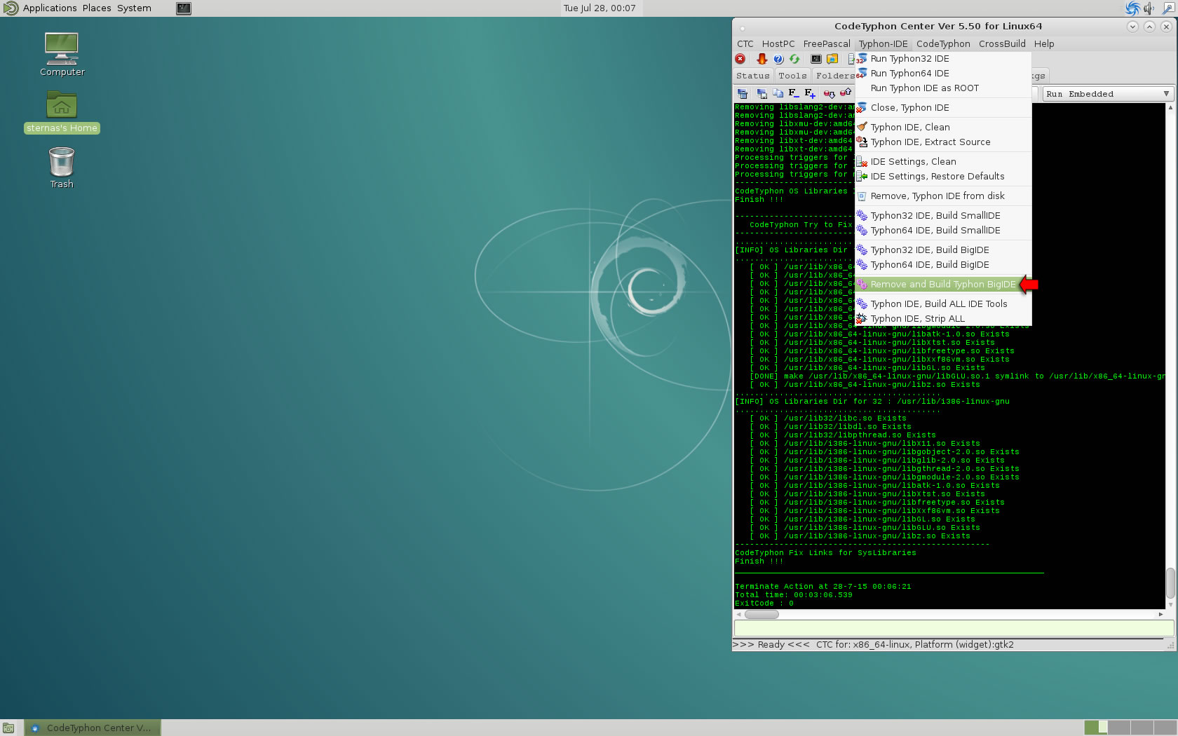

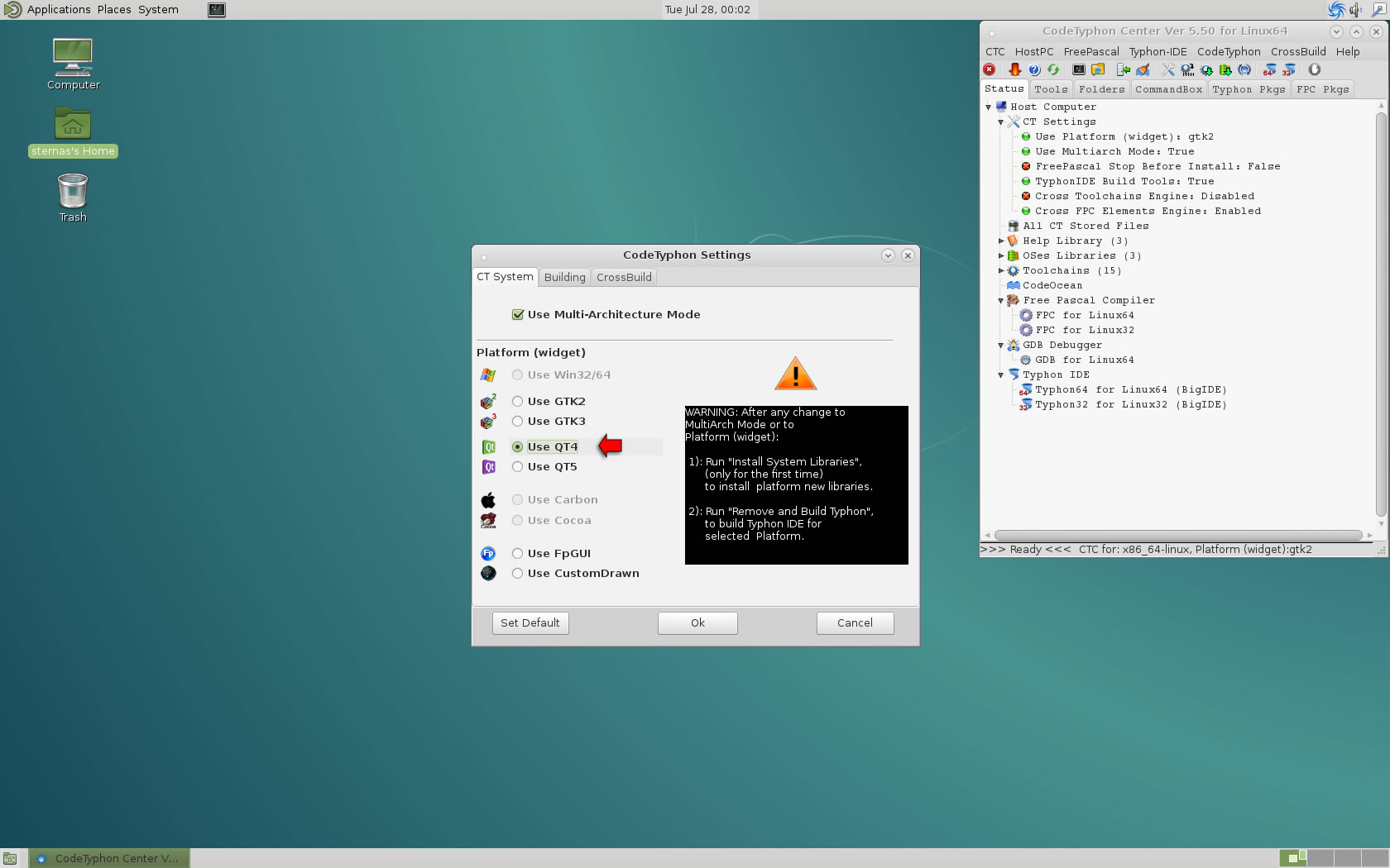

Build MultiArch Typhon IDE for QT4 procedure:
1)-Open CodeTyphon Center -> Setup Dialog
2)-Set Platform to QT4
3)-Install OS System Libraries
4)-Remove and Build Typhon BigIDE

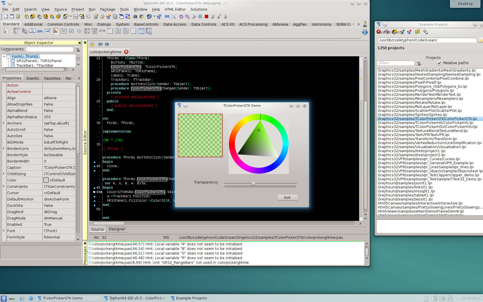

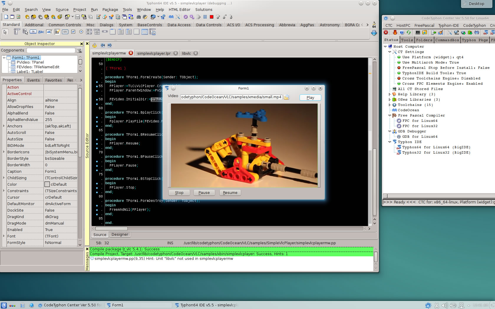

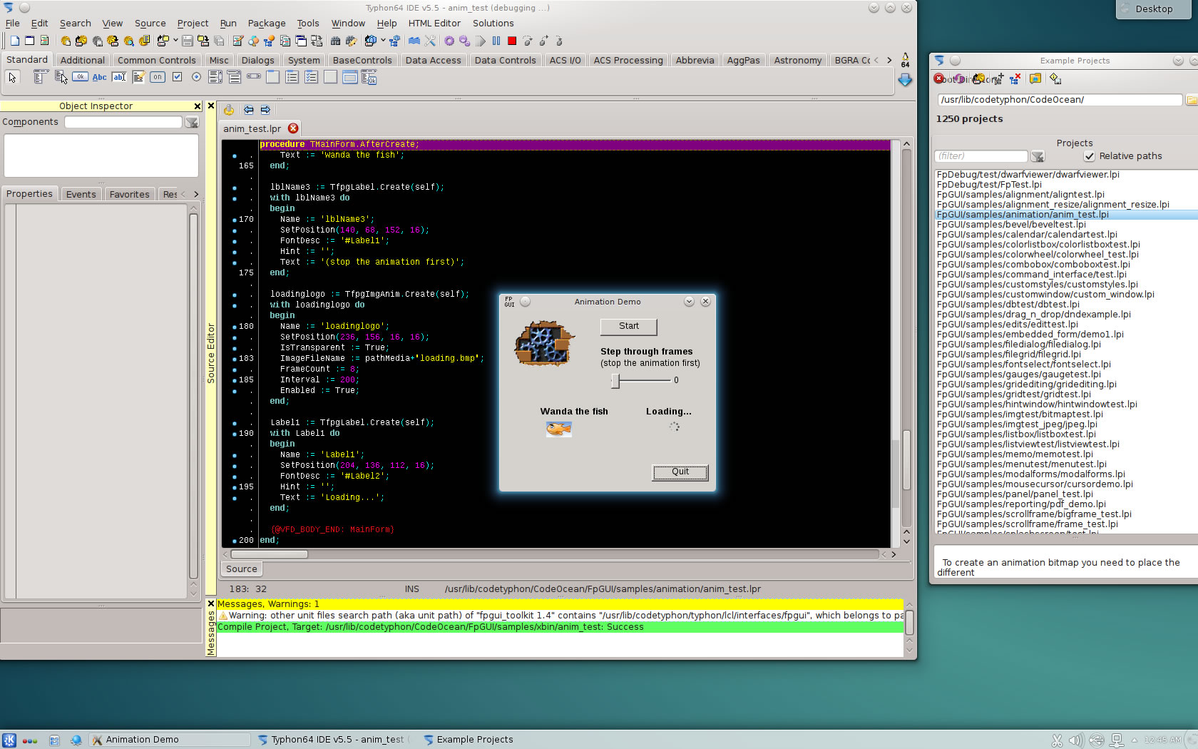

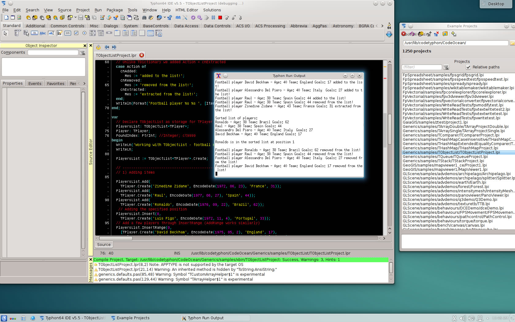

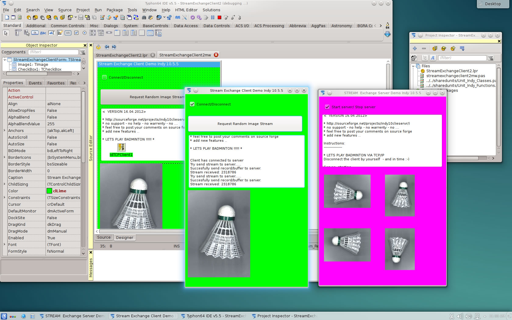

Some Libraries test on Plasma 4 (QT4) :
lz_vlc (video player),
pl_ColorLib,
fpGUI,
Generis (on Linux ???)
pl_Graphics32,
pl_Indy (server, client)
etc

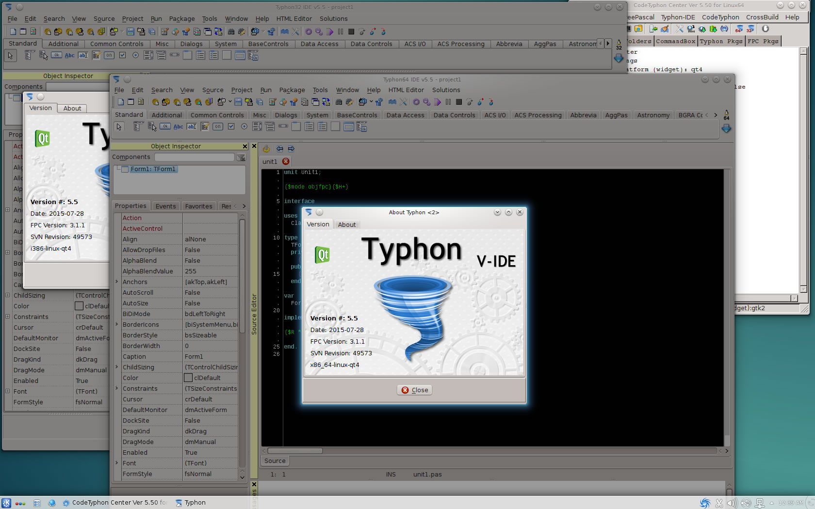

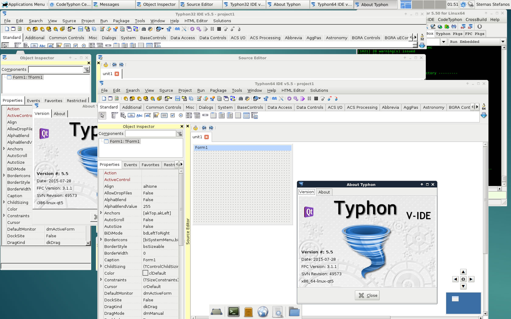

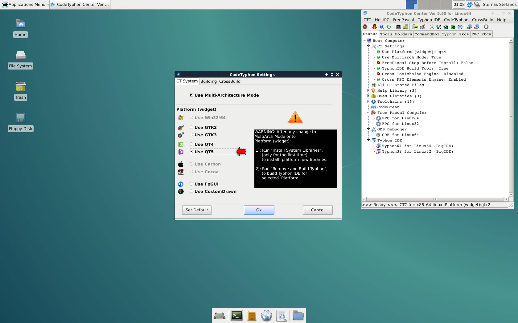

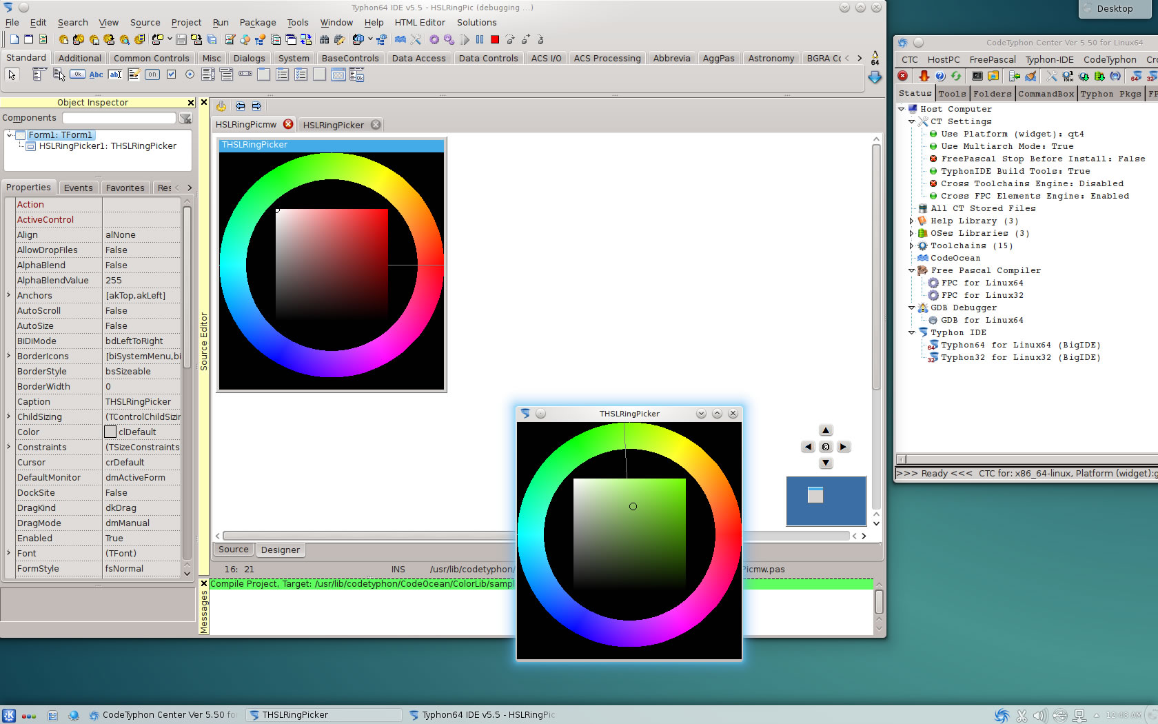

Build MultiArch Typhon IDE for QT5 procedure from Xfce Desktop...:
2)-Set Platform to QT5
and have fun....

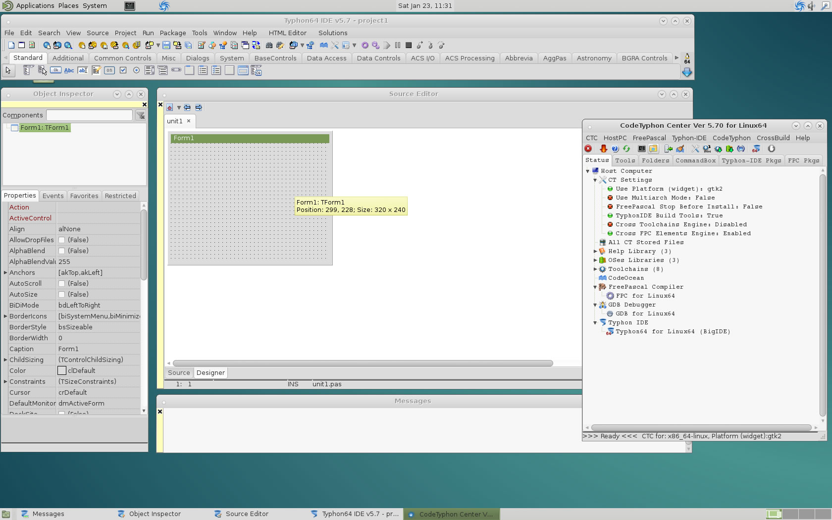

[LAB] CodeTyphon on Debian 8.x 10 years 2 months ago #8994
  • Posts: 4614
  • Thank you received: 1129
Oh, you know many CT tricks :)
-from Action log, I can't find the problem
-in "CT Host Info" all are OK
My suggestions
-Remove and reinstall - build CT
-Test and Lab CT 5.70
Mysterious problem...
