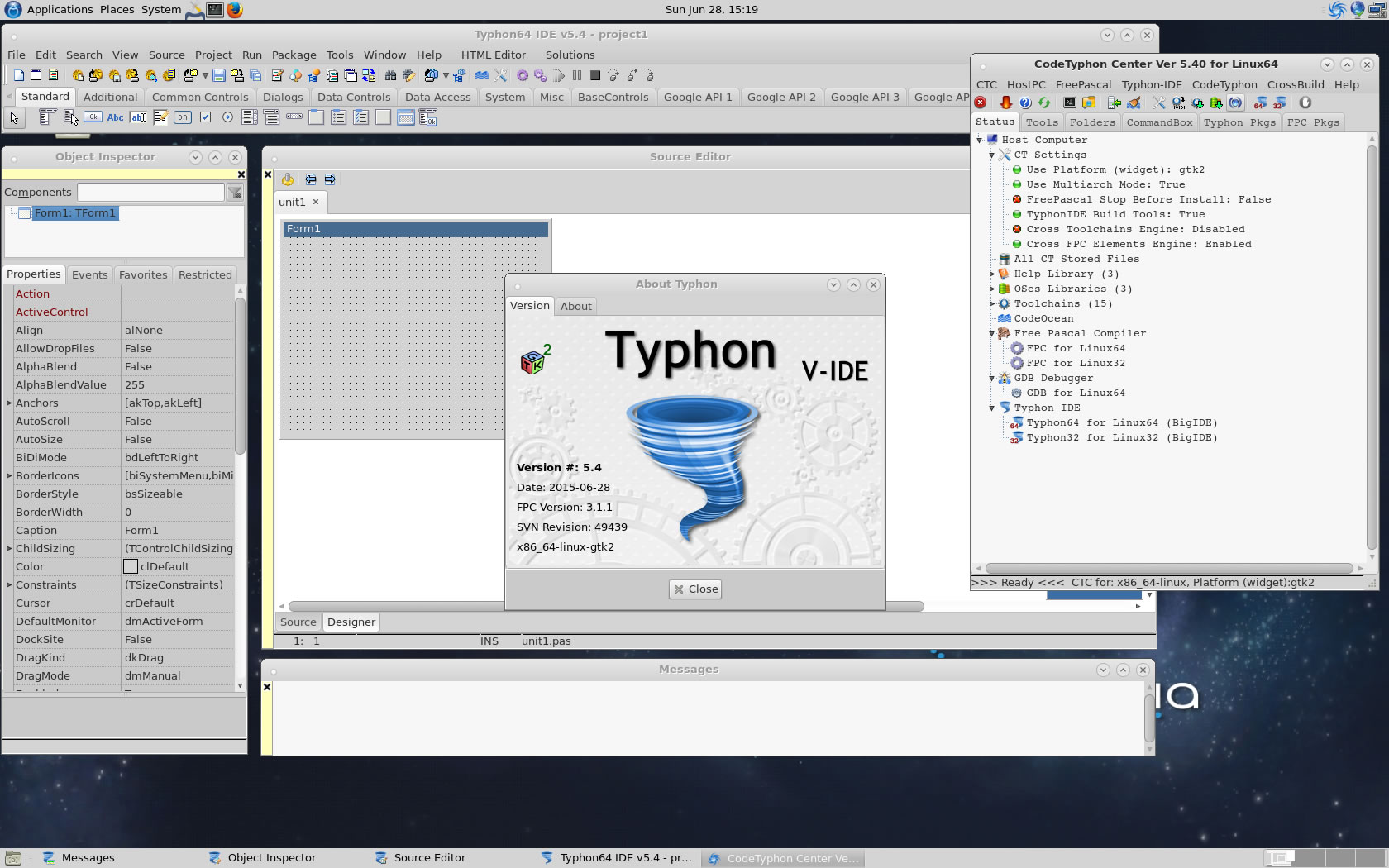

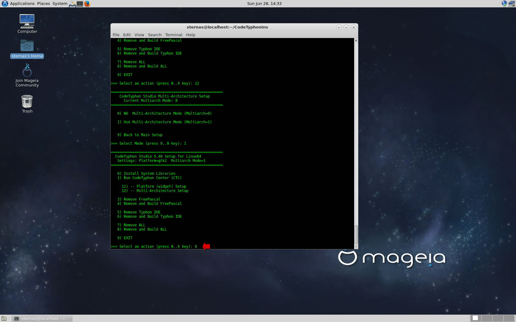

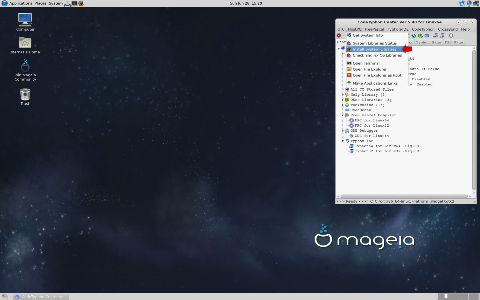

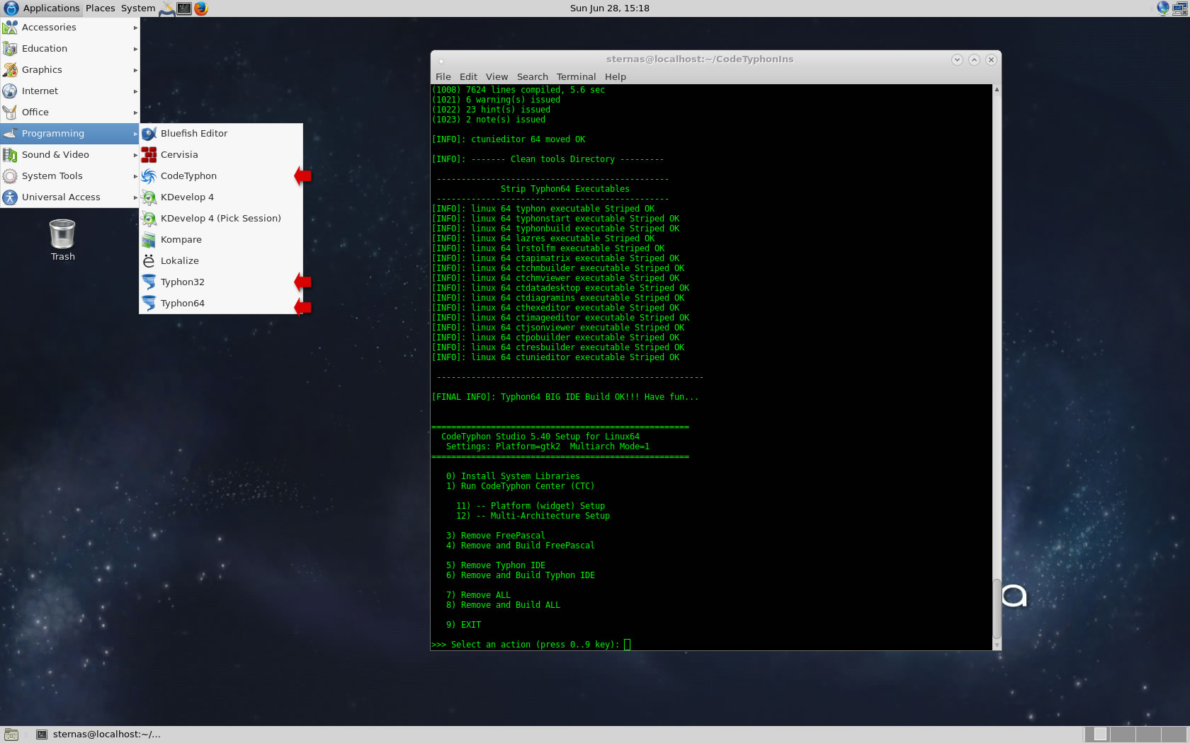

We test LAB CodeTyphon ver 5.40 on
Mageia 5 with KDE4, MATE and Xfce Desktops (Mageia-5-x86_64-DVD.iso) info

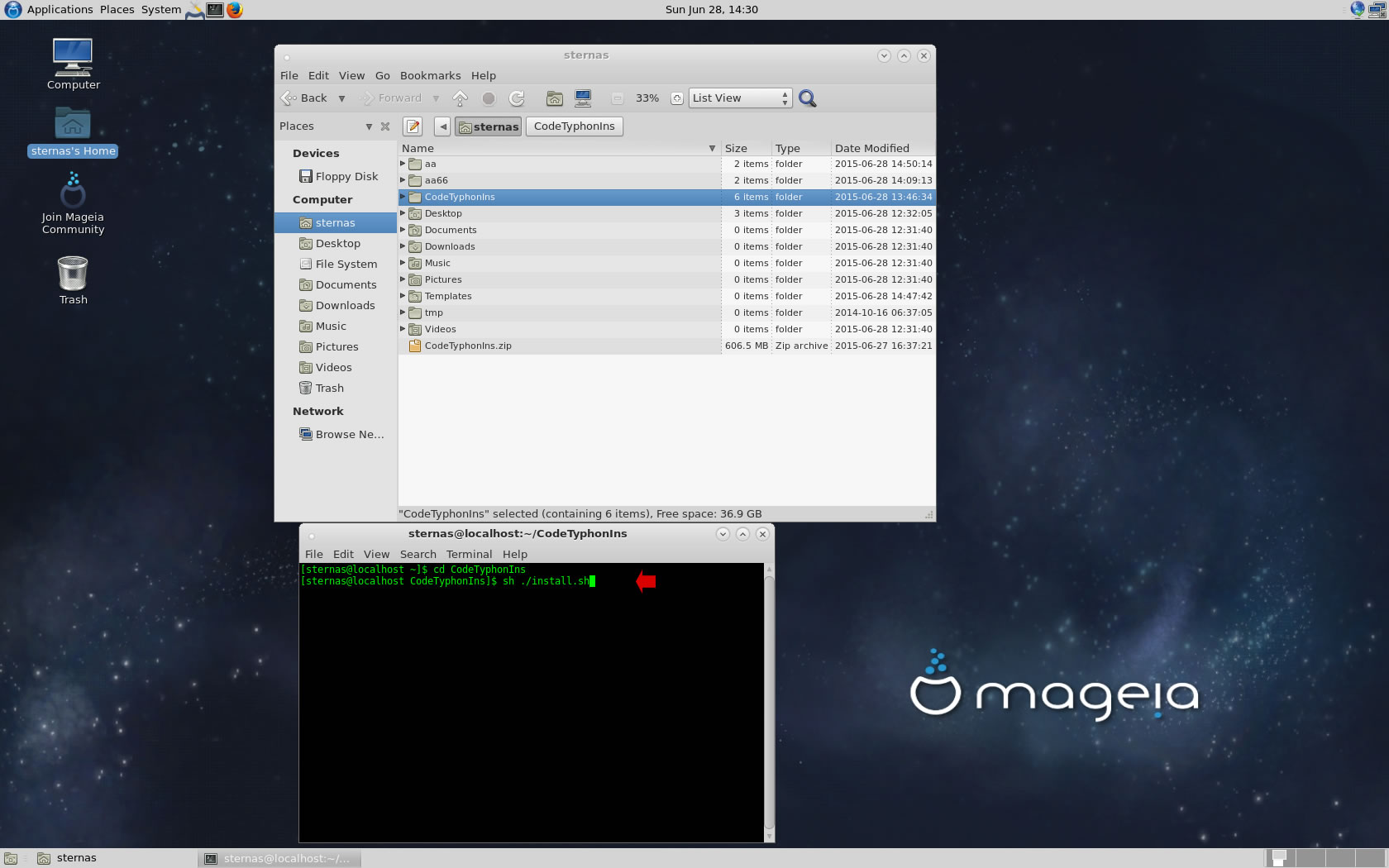

Some screens from CodeTyphon Installation and Build procedure for GTK2:
1)-Download CodeTyphonIns.zip

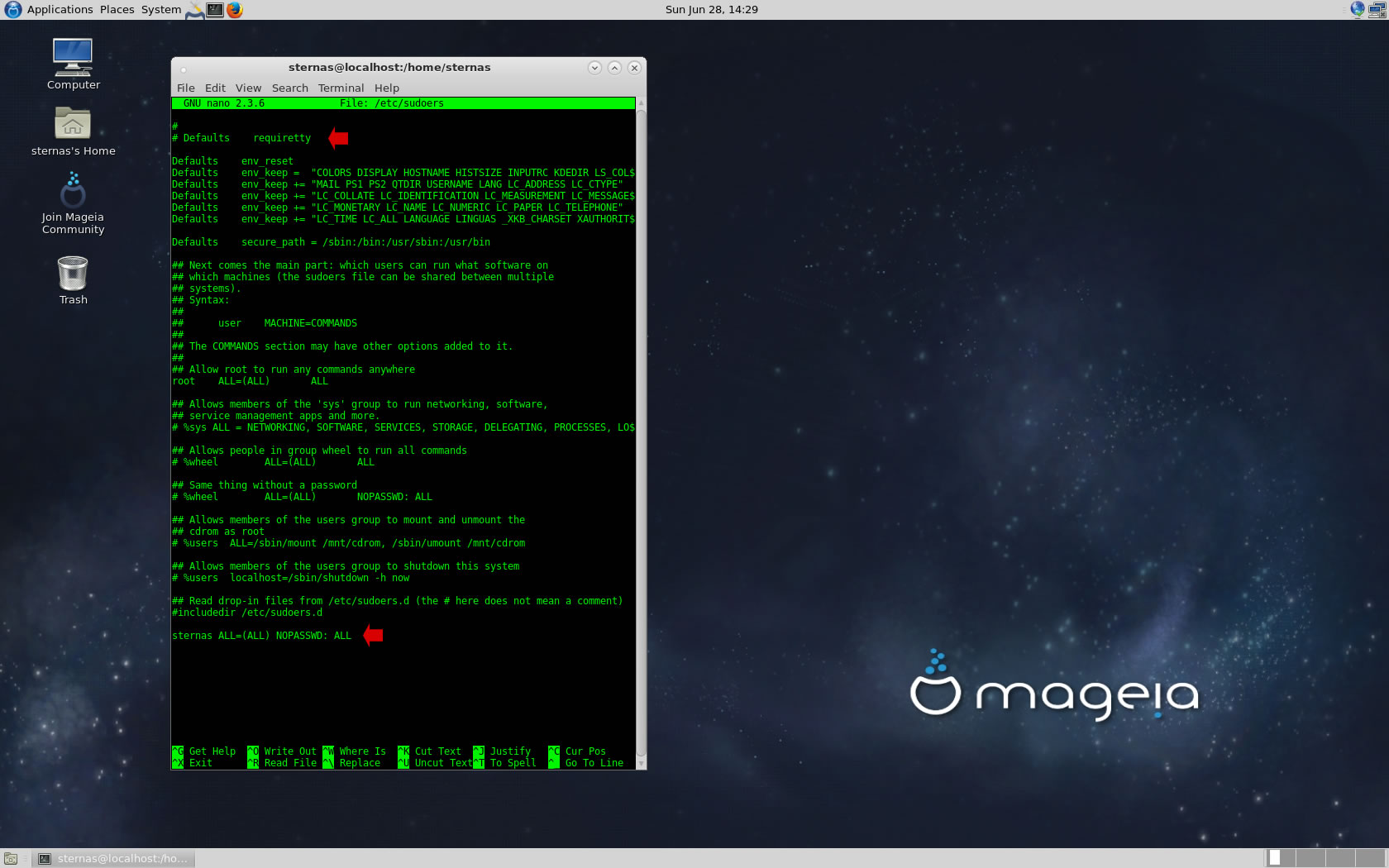

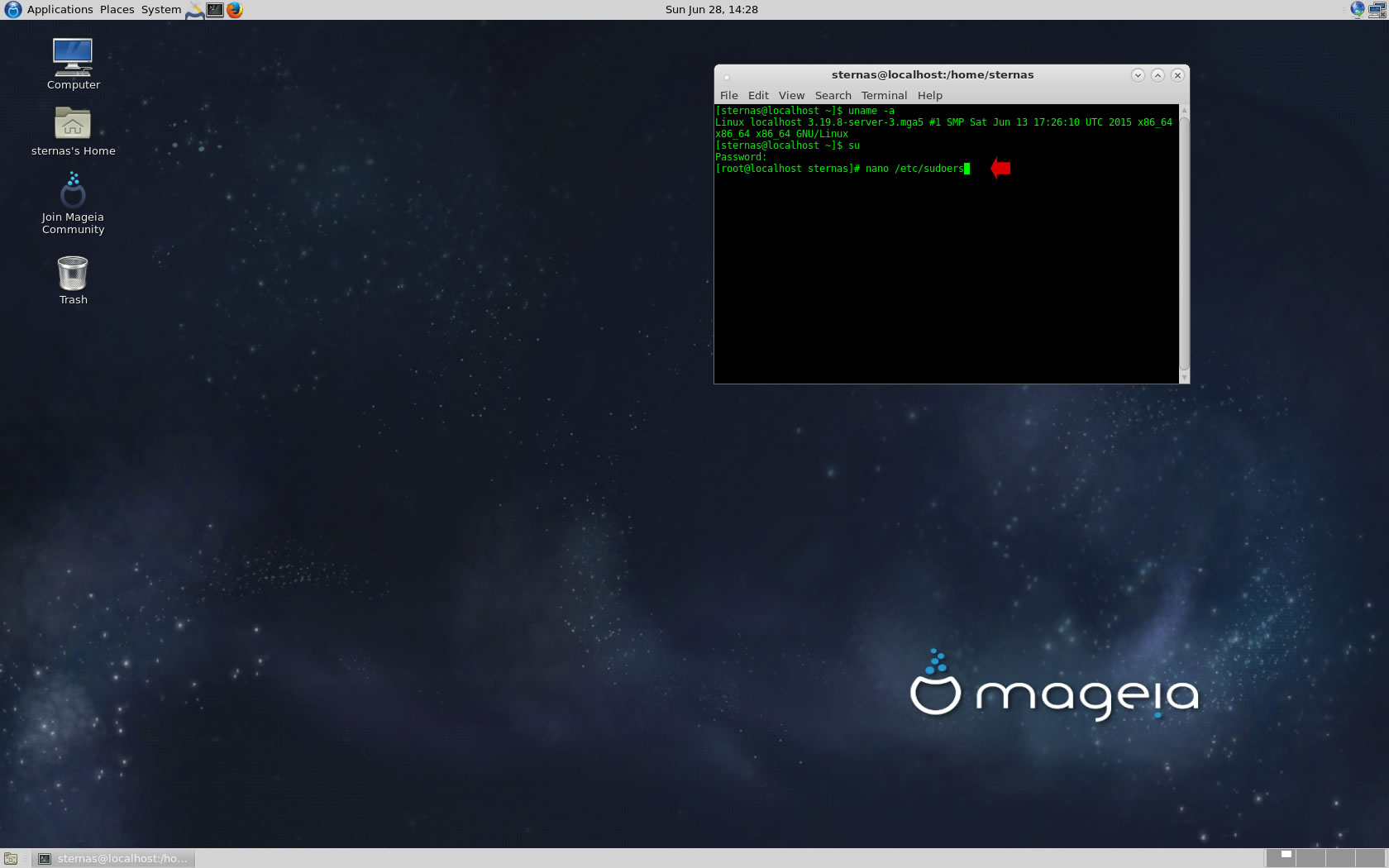

su
nano /etc/sudoers
Comment out the following line in /etc/sudoers:
# Defaults requiretty

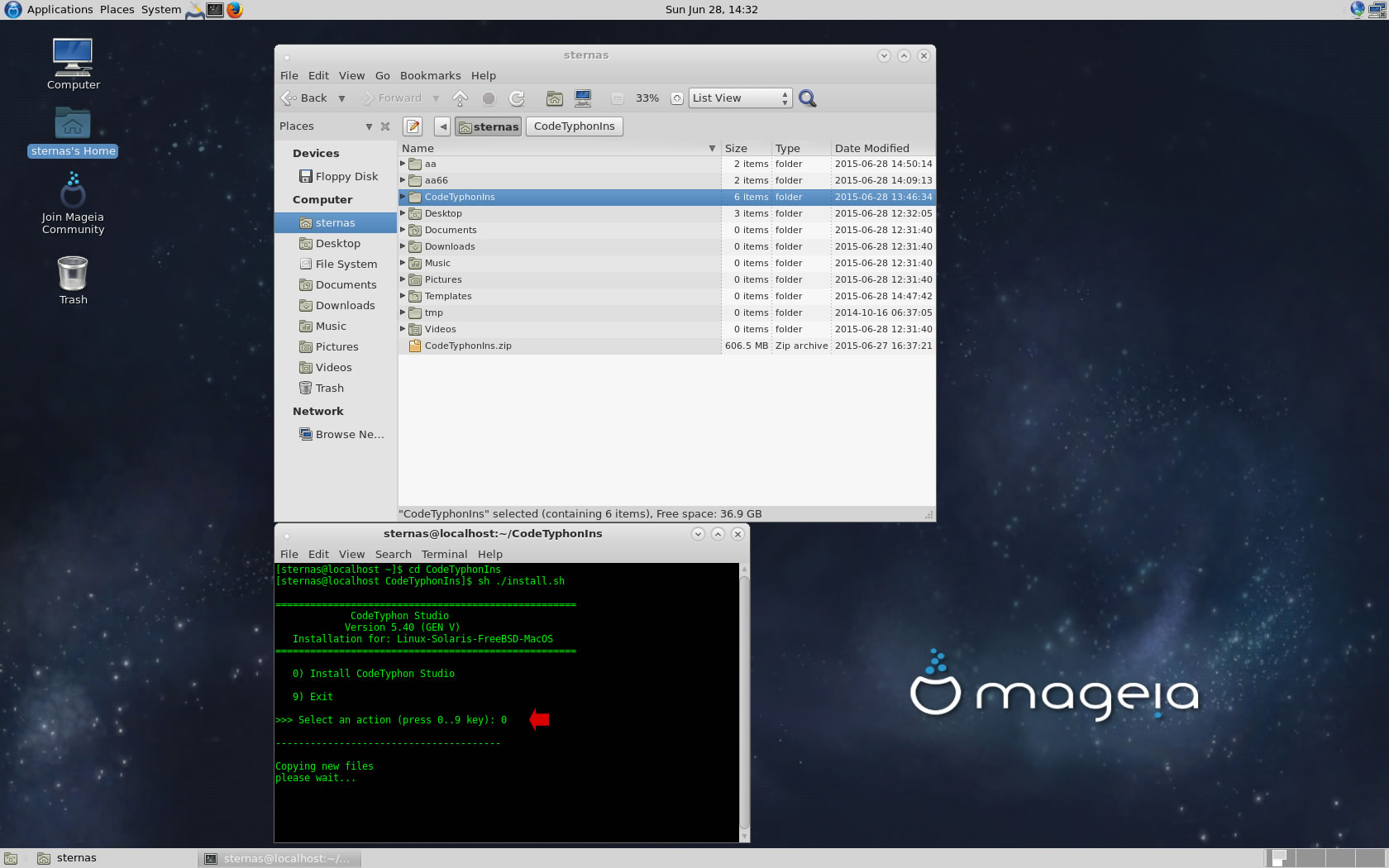

3)-UnZip CodeTyphonIns.zip
4)-Run install.sh from CT directory to Install CodeTyphon

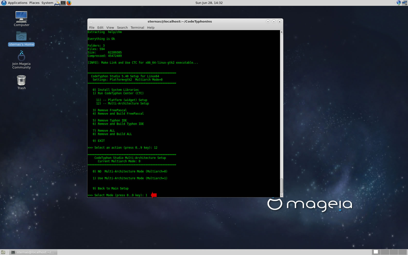

5)-CT on Fedora has MultiArch Support. You can Select MultiArch=1 from "MultiArch Setup"

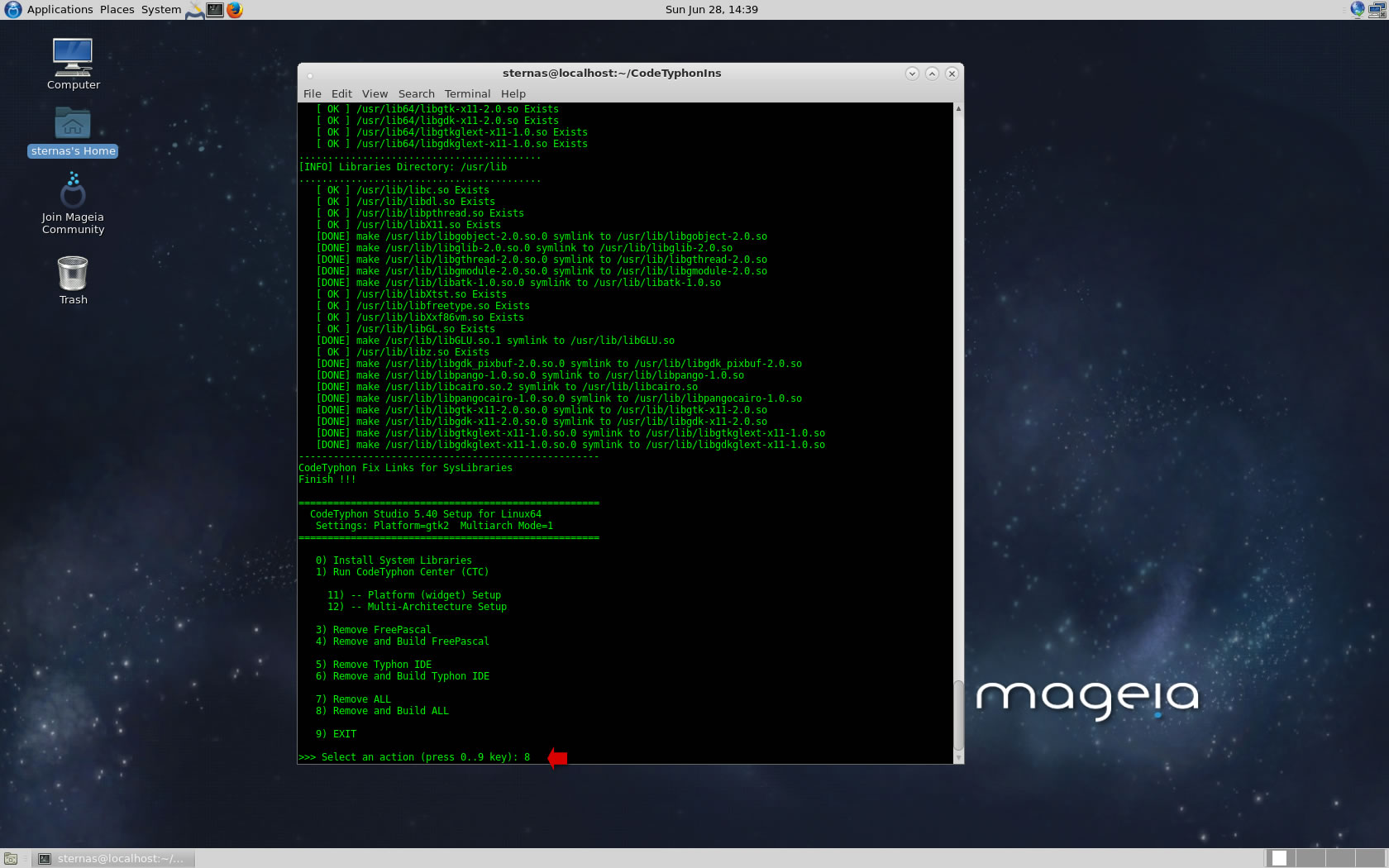

6)-Install "System Libraries" from CT setup script.
7)-Build ALL (Freepascal and Typhon IDE) from sources
[LAB] CodeTyphon on Mageia 5 10 years 11 months ago #7553
  • Posts: 4624
  • Thank you received: 1132

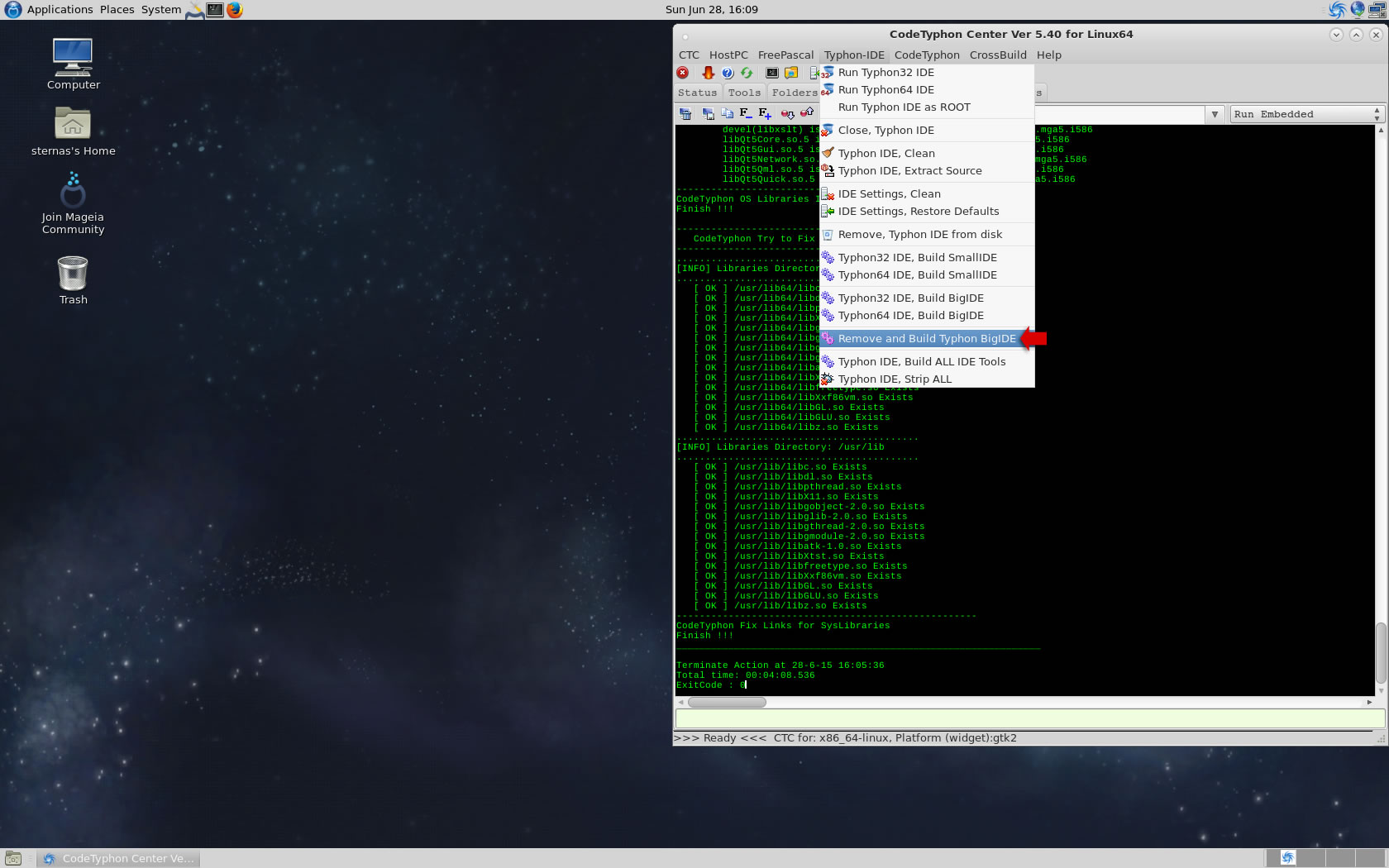

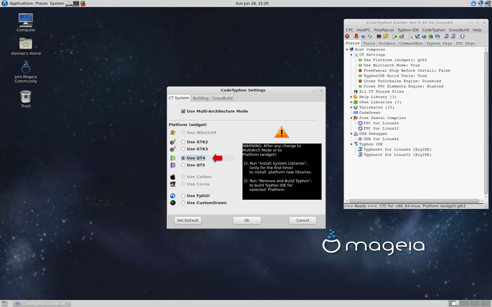

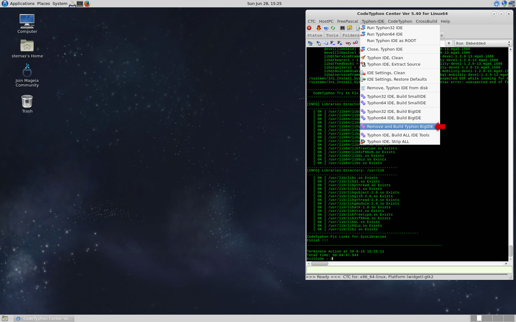

Build MultiArch Typhon IDE for QT4 procedure:
1)-Open CodeTyphon Center -> Setup Dialog
2)-Set Platform to QT4
3)-Install OS System Libraries
4)-Remove and Build Typhon BigIDE

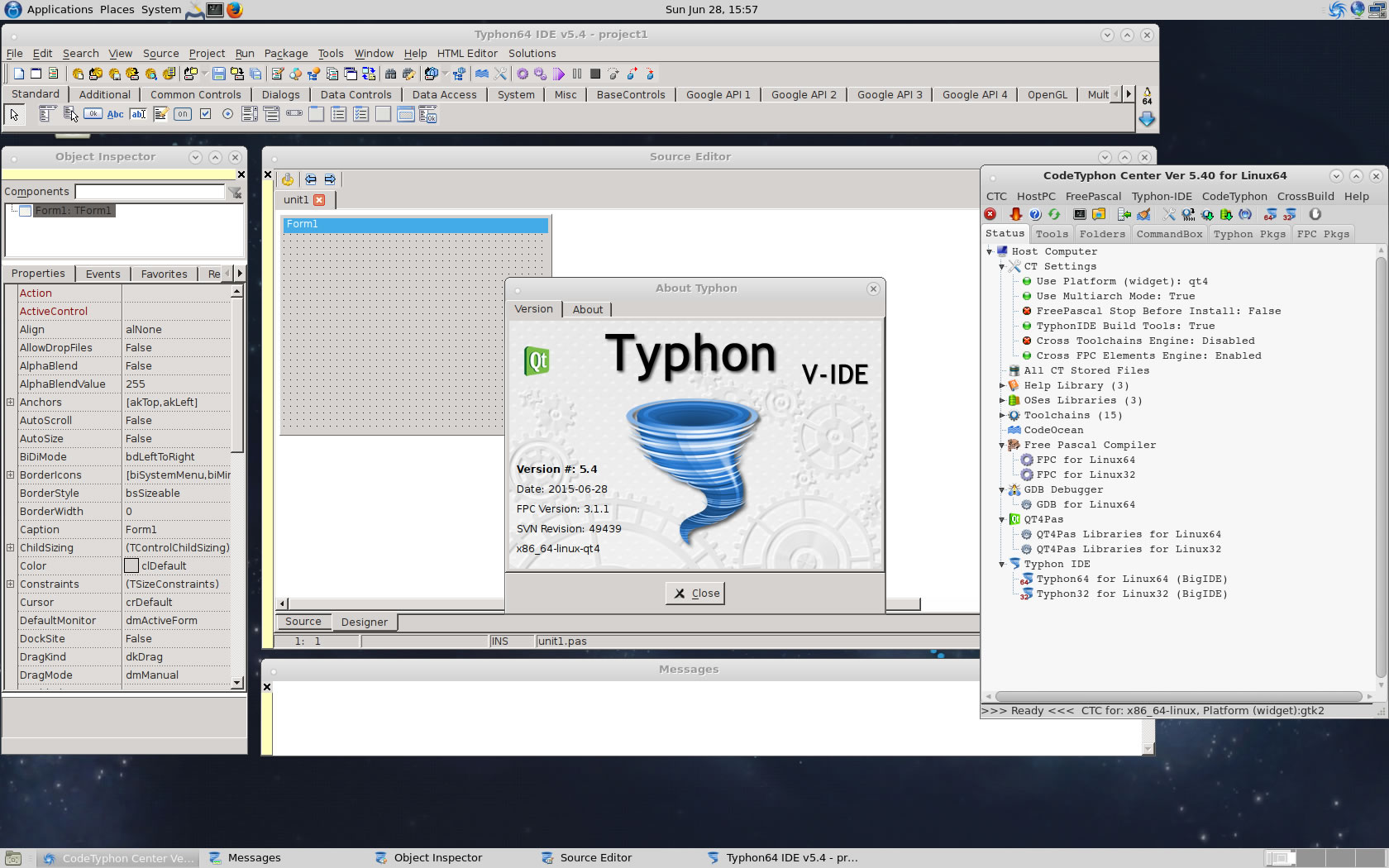

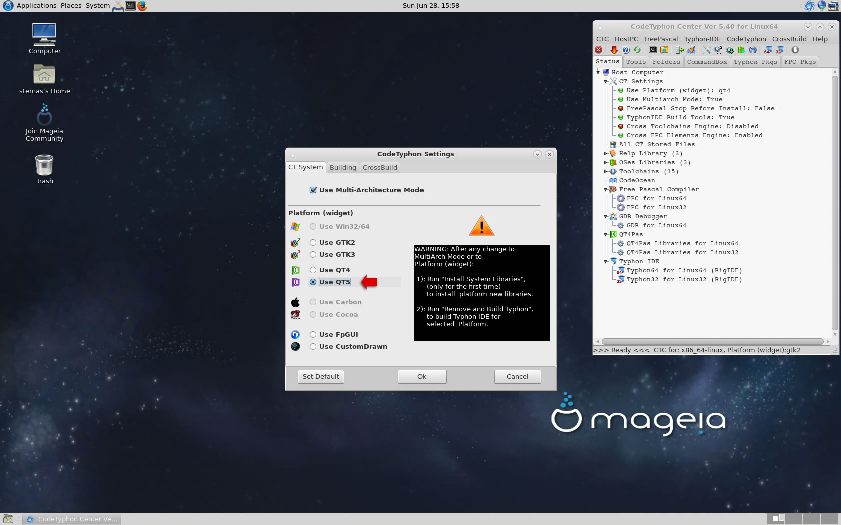

[LAB] CodeTyphon on Mageia 5 10 years 11 months ago #7554
  • Posts: 4624

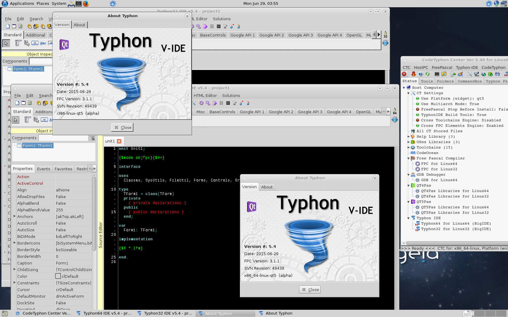

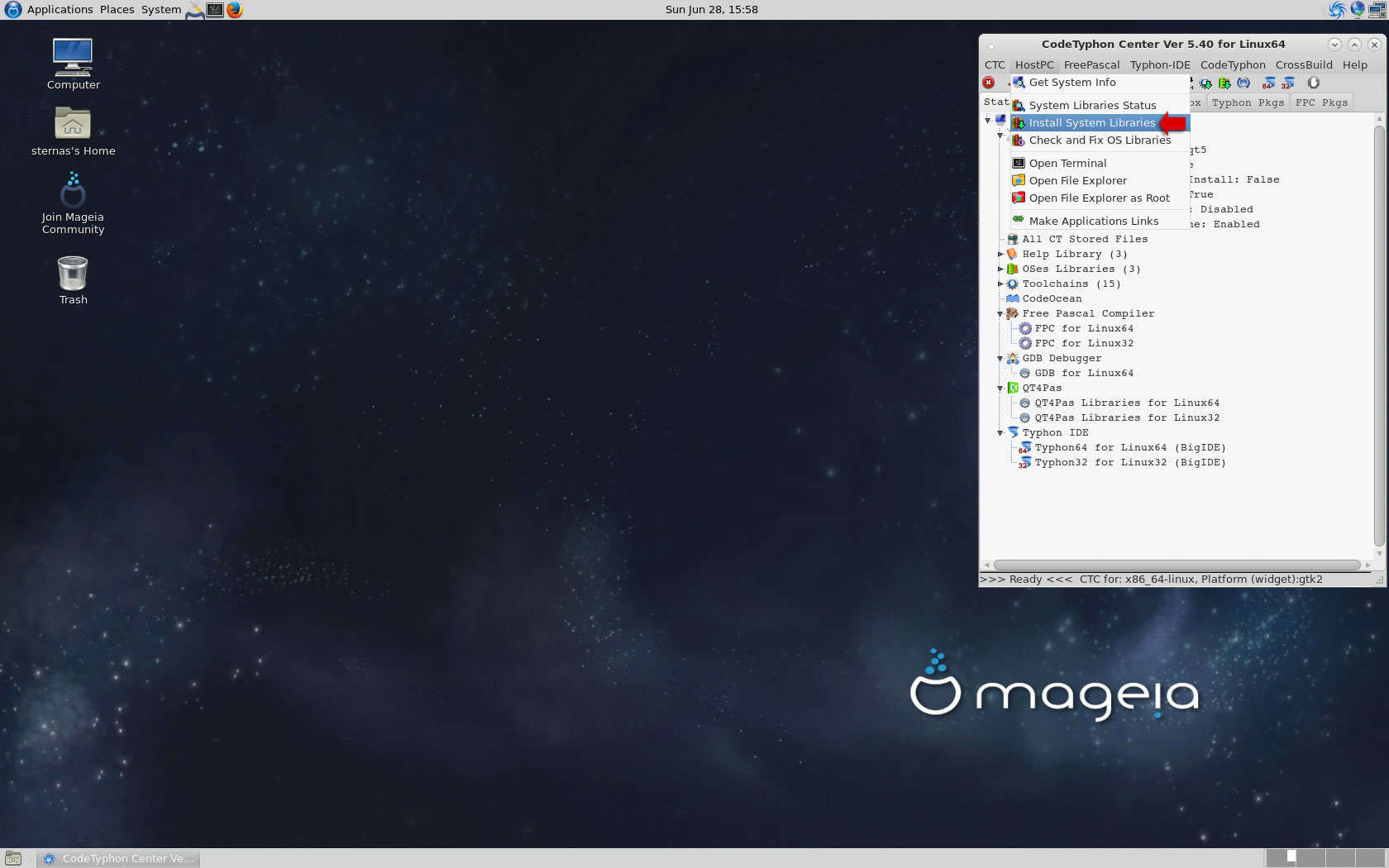

Build MultiArch Typhon IDE for QT5 procedure:
2)-Set Platform to QT5
and have fun....
