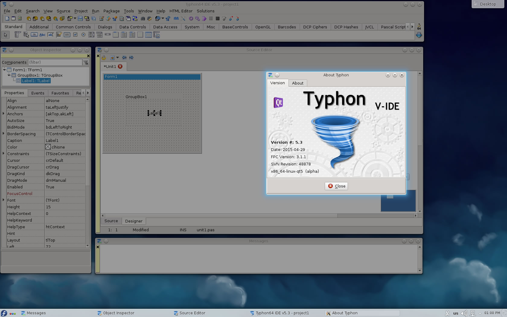

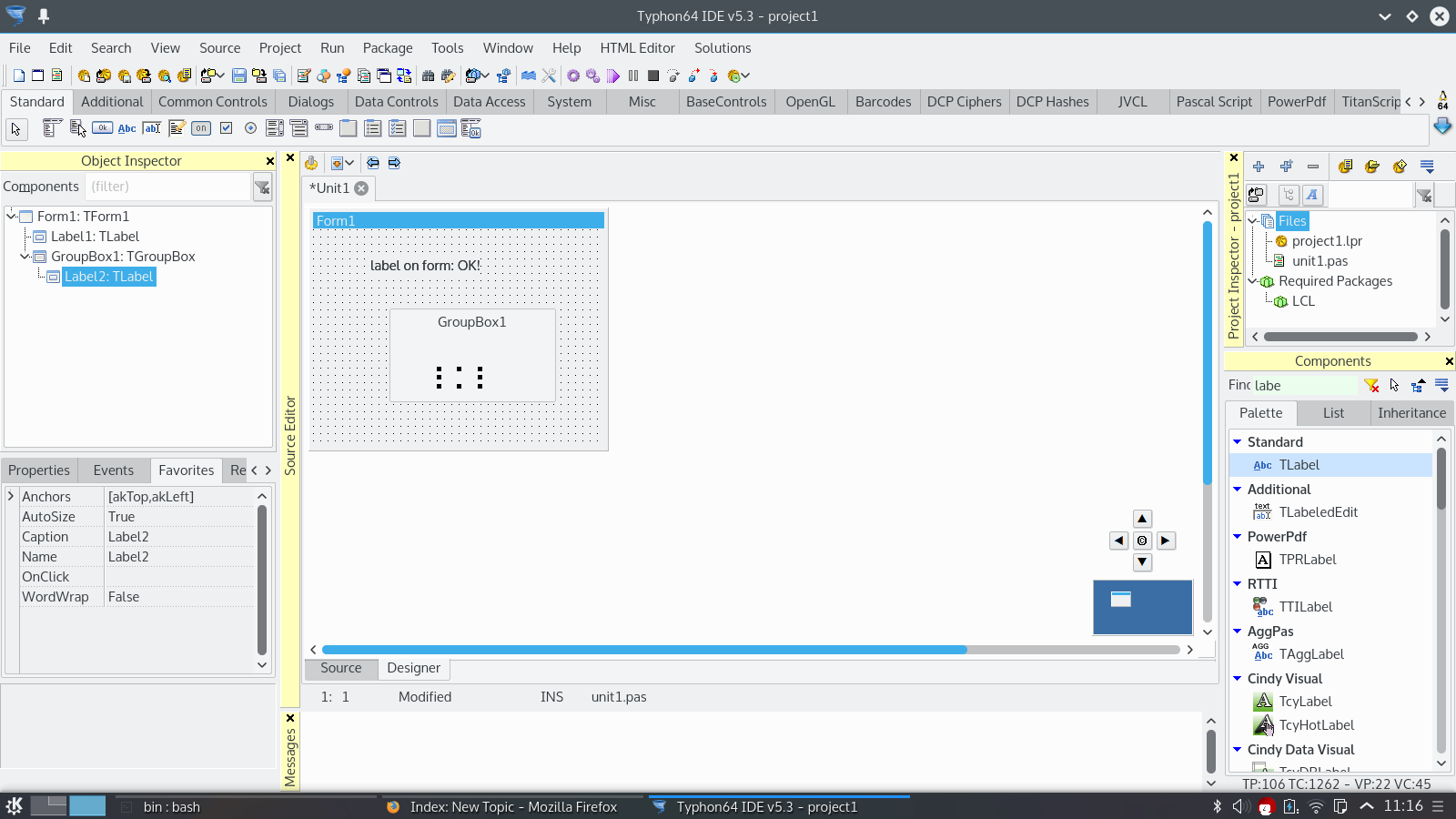

I recently installed kubuntu 15.04 on my laptop.
I am using latest lab version of CT QT4 compiled (QT5 still buggy)
For every version of CT i used on any QT compilation same bug occurs.
If i place a Label inside a groupbox it stays invisible. if i place i.e. on a form, it's ok.
screenshot attached
Any ideas why?

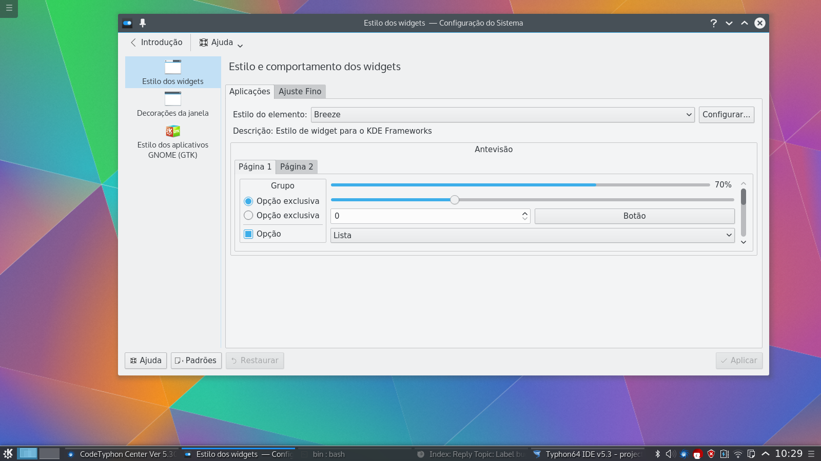

You have change the QT style in config interface KDE5.

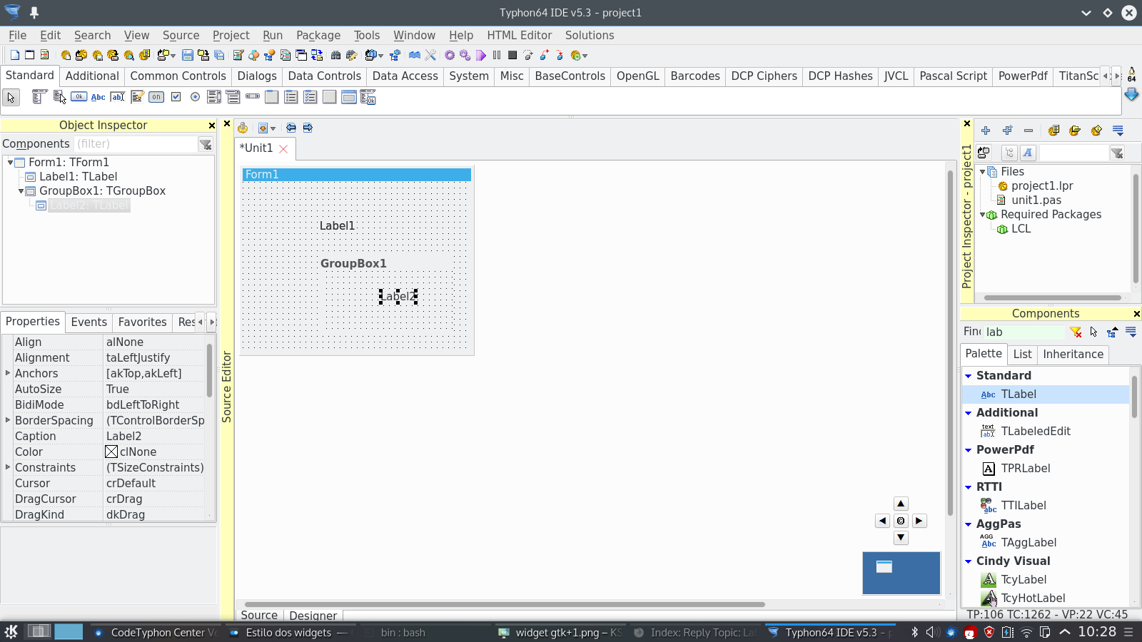

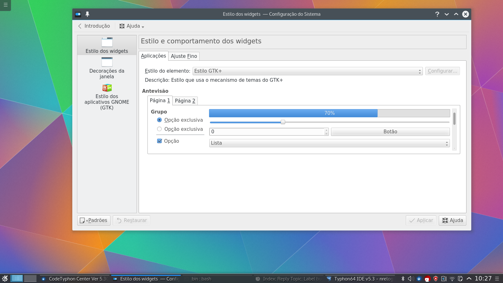

i can confirm that changing the widget style theme from breeze (KDE frameworks) to other, say GTK+ does solve the problem.
screen:
so i guess the bug is related to kde frameworks

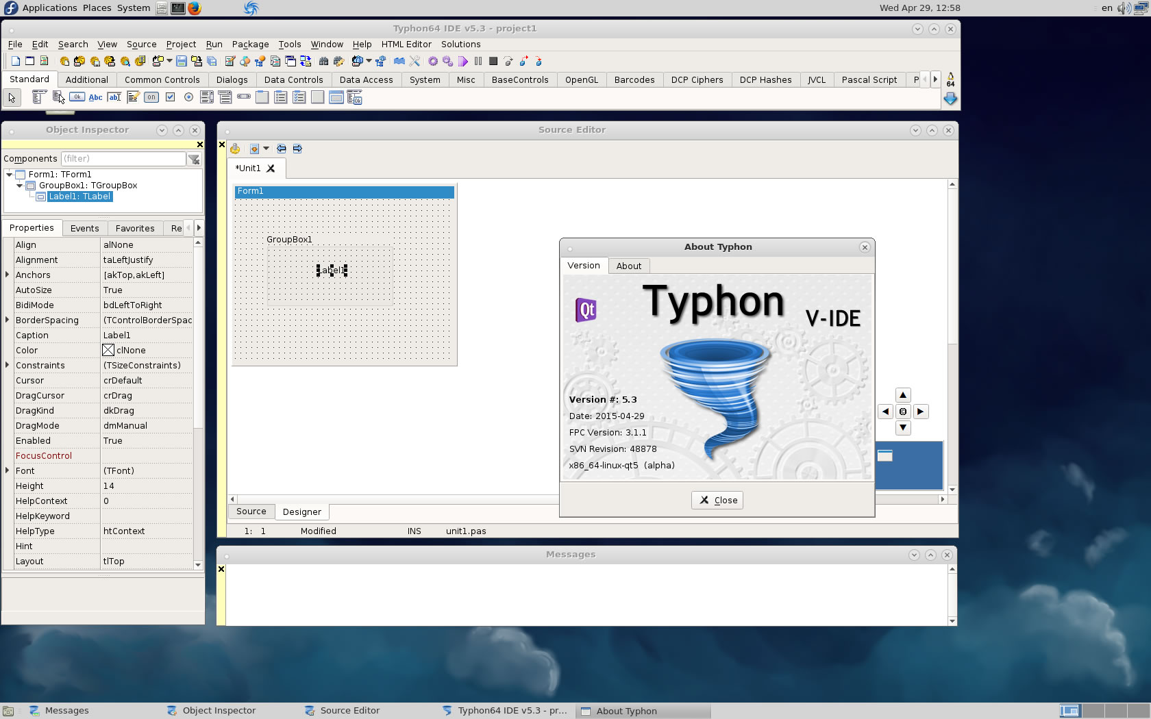

This problem not exists on Fedora 21
Typhon64 build for QT5
on both Mate and Plasma (QT4.8x) desktops
The following user(s) said Thank You: Nuno Pinho
