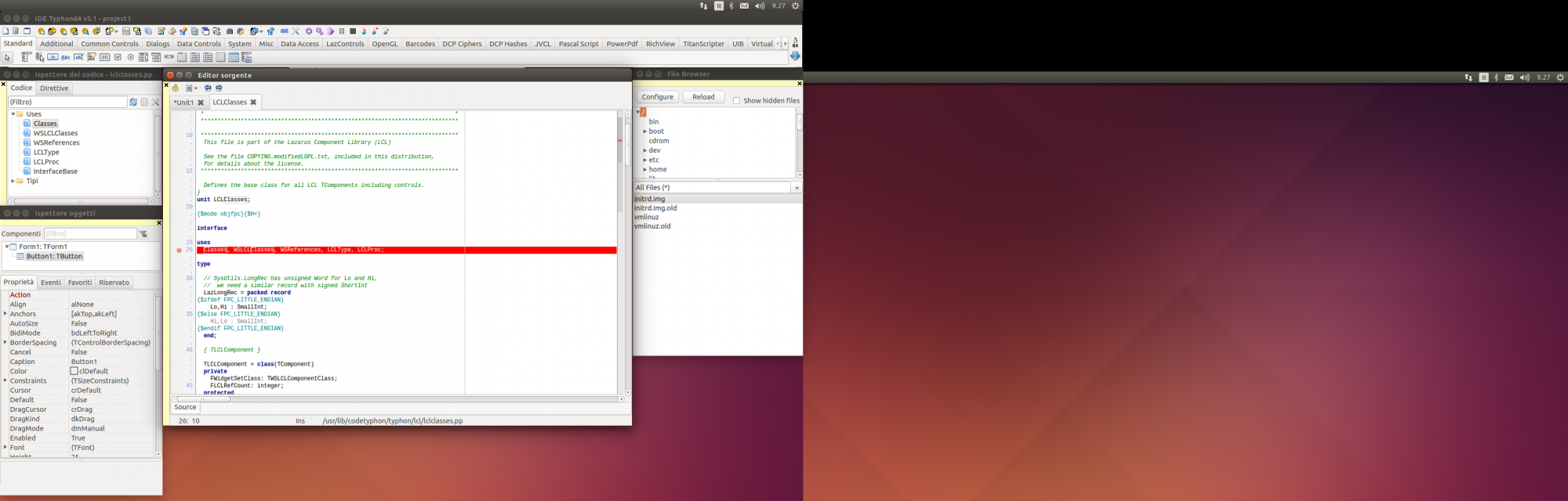

I noticed that when the mouse is over the designer the cursor icon is the text edit cursor, like if it is over the text editor window. I do a switch to the text editor and switched again to the designer and the cursor behavior is the correct one with the arrow icon and now I can move the control. If I double click the control or the form the LCLClasses unit will open in the editor. I still can not bring up the message window and I don't know the error. There is a screenshot attached.

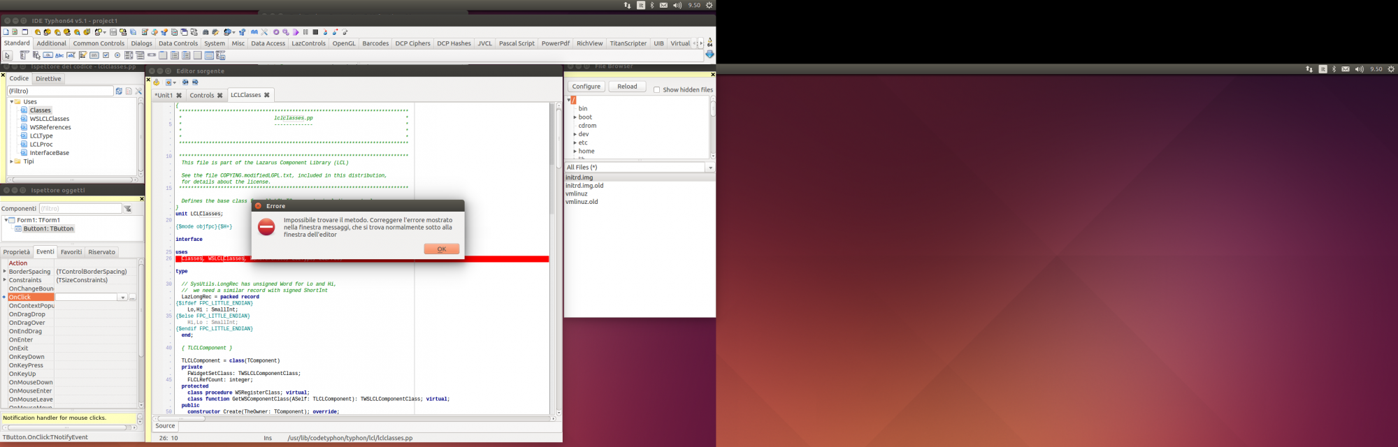

Even trying to create the click event handler from the object inspector an error is returned, as you can see in the attached screenshot.

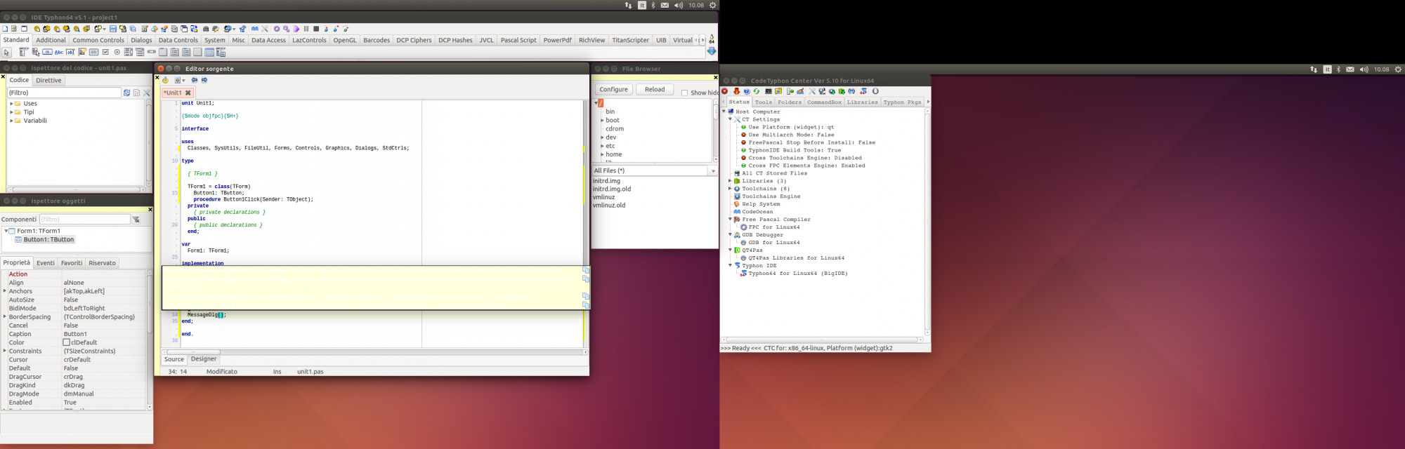

I found another problem. The tip with code suggestion is empty.
