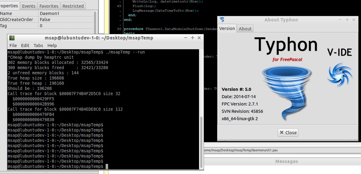

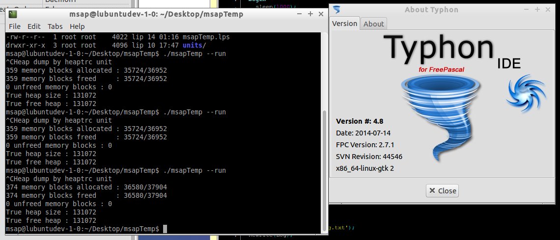

When I was on CT 4.8 I've created an example short Daemon app.
It was all OK on CT 4.8.
I've made a clone of Dev Virtual Machine and on that clone made an upgrade to CT 4.9
Daemon app compiled on CT4.9 has memory leaks - the same app, the same sources - just IDE has changed.
Compiled with DEBUG and run then gives: [hit Ctrl+C after 5-6 seconds]
msap@lubuntudev-1-0:~/Desktop/msapTemp$ ./msapTemp --run
^CHeap dump by heaptrc unit
302 memory blocks allocated : 32565/33424
300 memory blocks freed     : 32421/33280
2 unfreed memory blocks : 144
True heap size : 196608
True free heap : 196160
Should be : 196208
Call trace for block $00007FCBE791C5C0 size 32
  $0000000000429FF5
  $000000000042B996
Call trace for block $00007FCBE78CD8C0 size 112
  $0000000000479FB4
  $0000000000479830
msapTemp.log
msapTemp [2014-07-14 01:41:41.663 Info] Daemon TDaemon1 current status: Start Pending
msapTemp [2014-07-14 01:41:41.663 Info] Daemon TDaemon1 current status: Running
msapTemp [2014-07-14 01:41:42.664 Info] 14-7-14 01:41:42
msapTemp [2014-07-14 01:41:43.664 Info] 14-7-14 01:41:43
msapTemp [2014-07-14 01:41:44.335 Info] Daemon TDaemon1 current status: Stop Pending
msapTemp [2014-07-14 01:41:44.335 Info] Daemon TDaemon1 current status: Stopped
msapTemp [2014-07-14 01:41:44.335 Info] Failed to start daemon TDaemon1 : Access violation
File Name: msapTemp.zip
File Size:809 KB
Some advices??
Warning: Spoiler!
Last edit: by Jacek.

Yes. I'm starting CT Center using gksu, and then I always start Typhon IDE from CT.
The compiled app is run from Terminal as a normal user.
My behavior is identical with CT4.8 and CT4.9 - only IDE has changed.

Unfortunately NO LUCK !
Typhon 5.0 still gives memory leak.
On my first post I attached complete ZIP package of the project. You could try it yourself for better tests.

In the internal Daemon log there is something strange.
After I hit Ctrl+C to stop the Daemon you see:
"Failed to start daemon TDaemon1 : Access violation"
The LOG from CT4.8 after status: Stopped has another one and last tick with Date and Time - it's from Execute procedure of Daemon.
CT5.0 LOG
msapTemp [2014-07-14 14:00:47.983 Info] Daemon TDaemon1 current status: Start Pending
msapTemp [2014-07-14 14:00:47.983 Info] Daemon TDaemon1 current status: Running
msapTemp [2014-07-14 14:00:48.983 Info] 14-7-14 14:00:48
msapTemp [2014-07-14 14:00:49.984 Info] 14-7-14 14:00:49
msapTemp [2014-07-14 14:00:50.984 Info] 14-7-14 14:00:50
msapTemp [2014-07-14 14:00:51.604 Info] Daemon TDaemon1 current status: Stop Pending
msapTemp [2014-07-14 14:00:51.604 Info] Daemon TDaemon1 current status: Stopped
msapTemp [2014-07-14 14:00:51.604 Info] Failed to start daemon TDaemon1 : Access violation
If you want me to do more tests please post a message - I have a Virtual Machine box for development so I can do anything.
