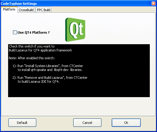

Unity use KDE API
Ha! Ubuntu is KUbuntu, actually :D
NeoDreamer, I believe you were asked to select General -> Settings in the CT Center menu and to check a certain box:
Then rebuild.
Regards!

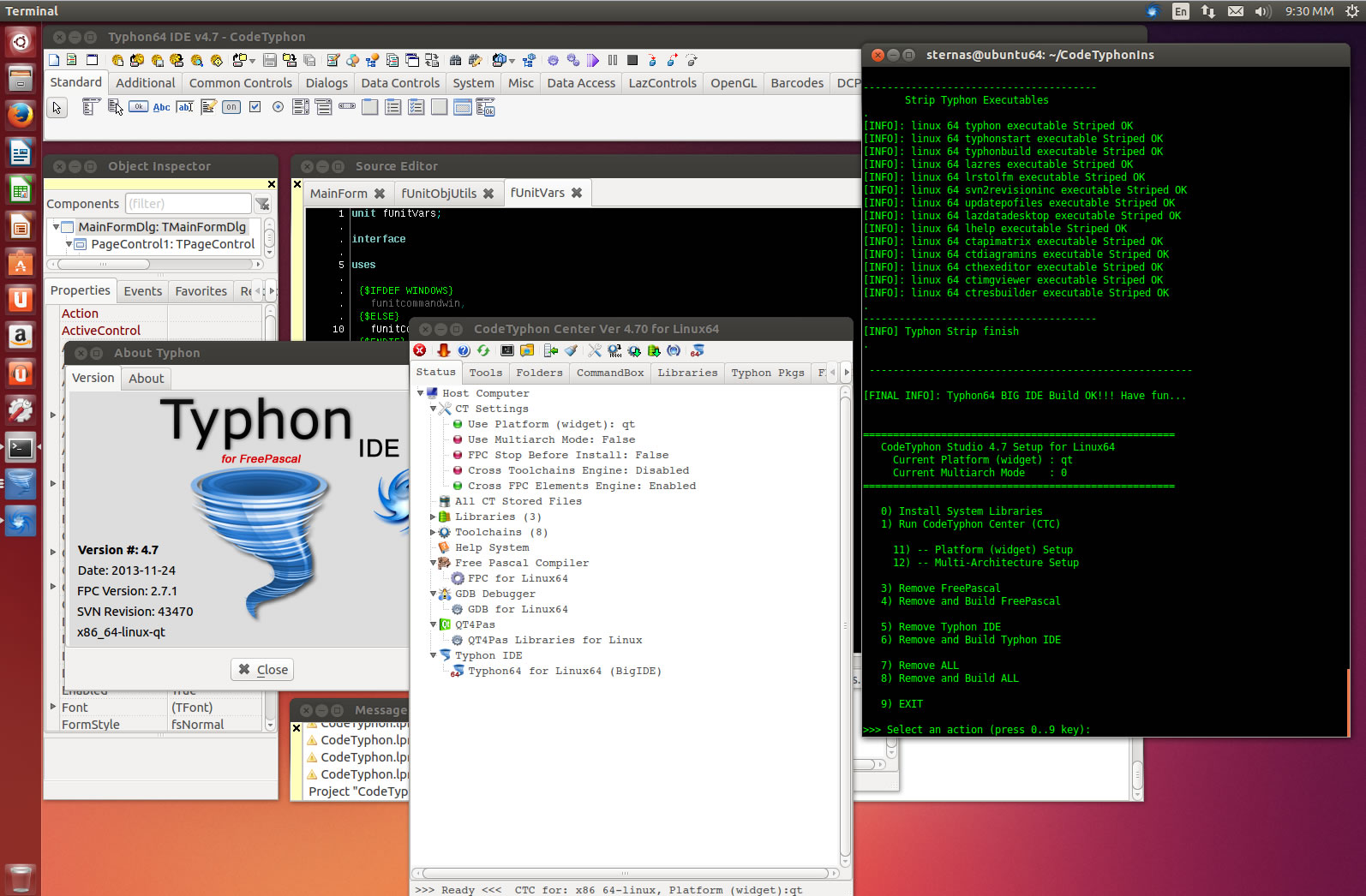

I did re-install codetypon.
I was select QT on install time and rebuild Codetyphon.
The first application was compiled successfully. but I met some warnings.
