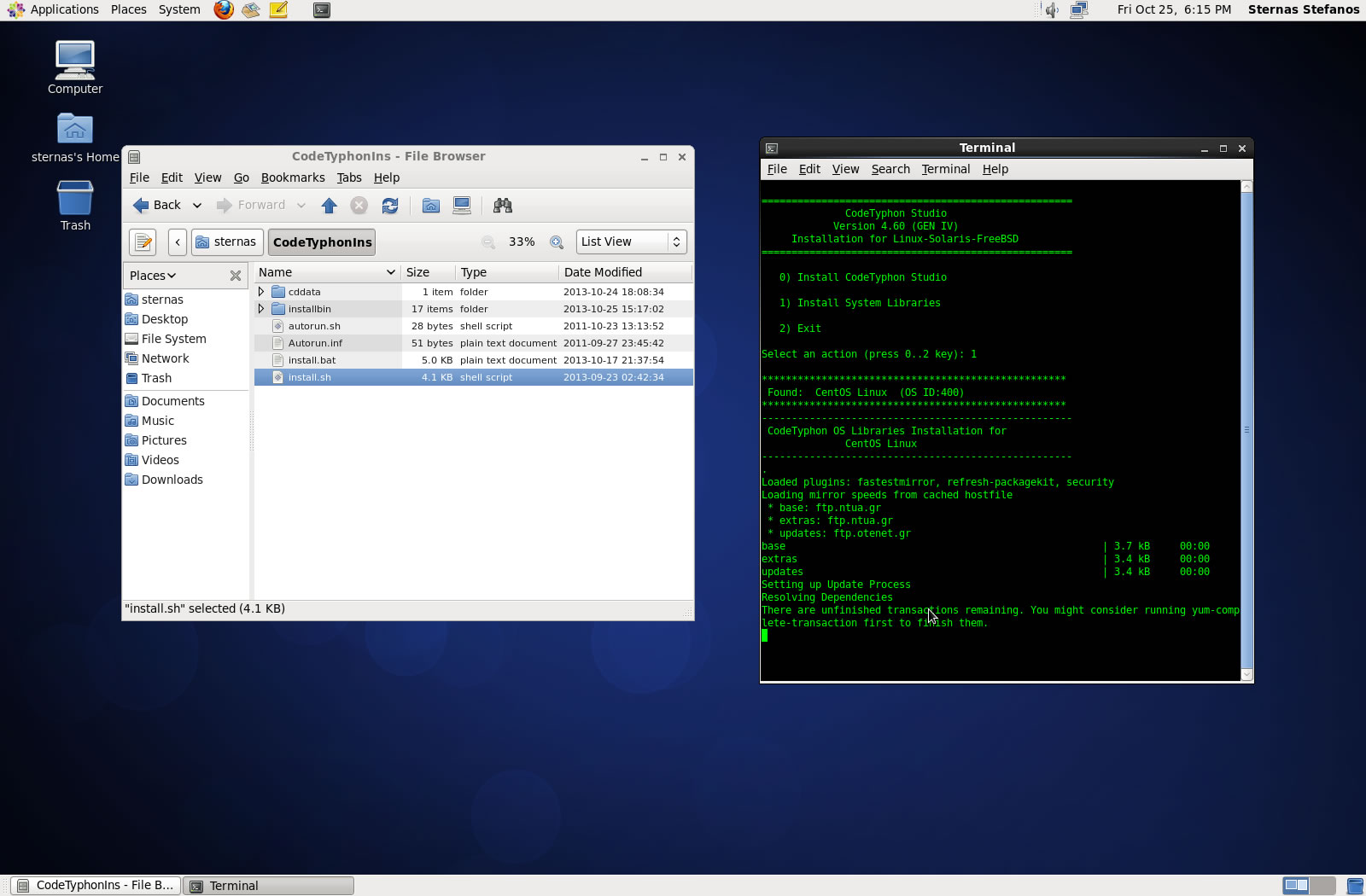

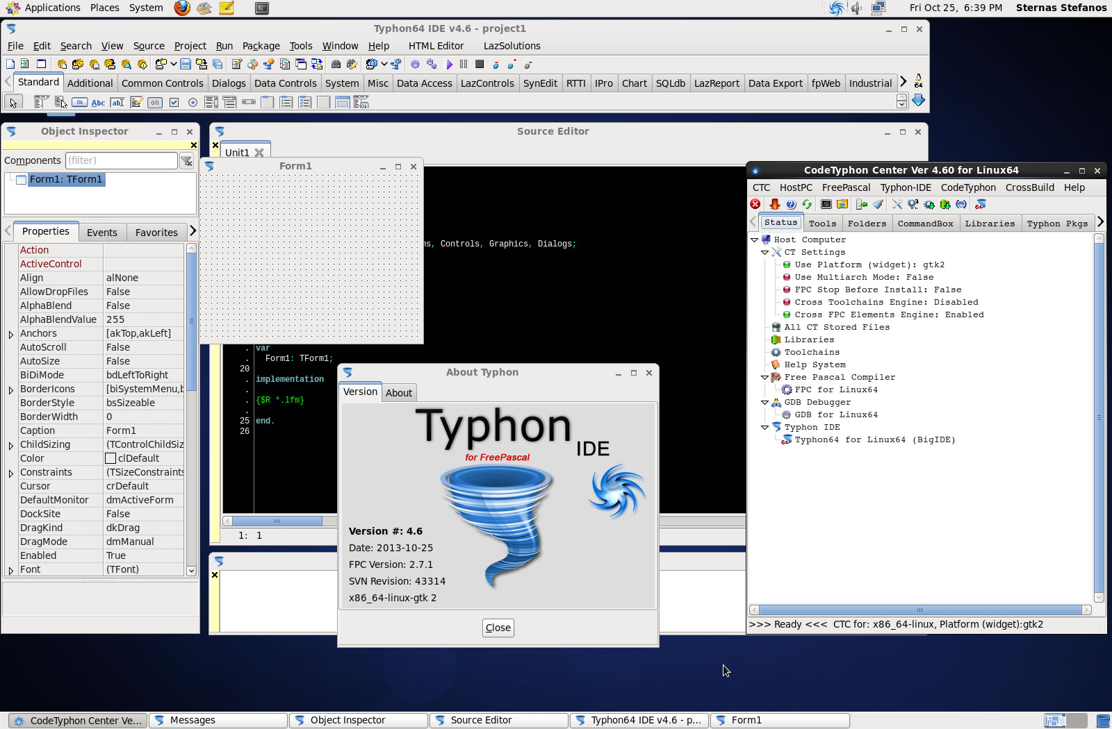

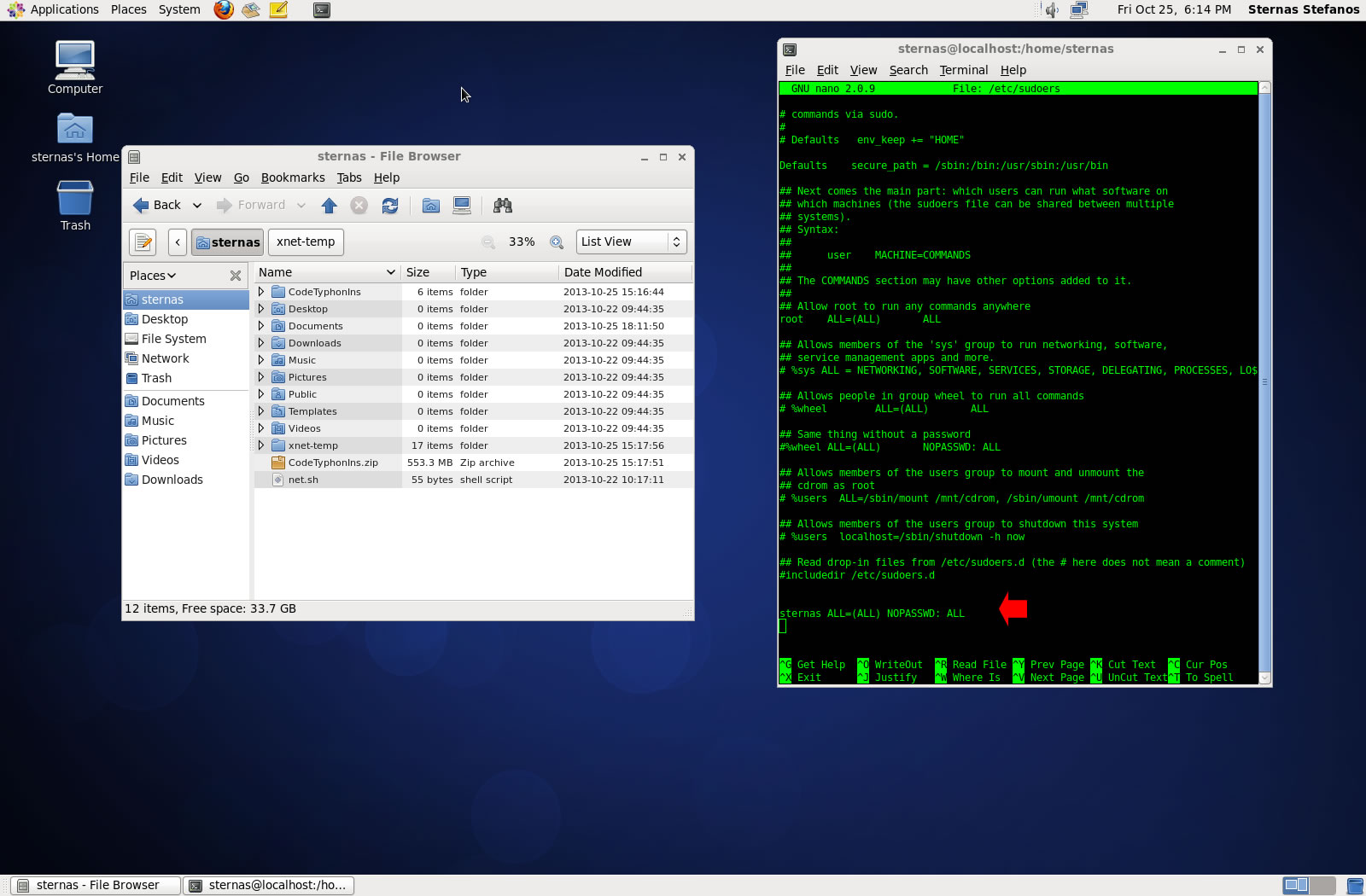

[LAB] CodeTyphon on CentOS 6.4 13 years 4 weeks ago #4668
We test lab CodeTyphon ver 4.60 on
CentOS 6.4 ( info ) Linux distribution,
with old Gnome2 Desktop.

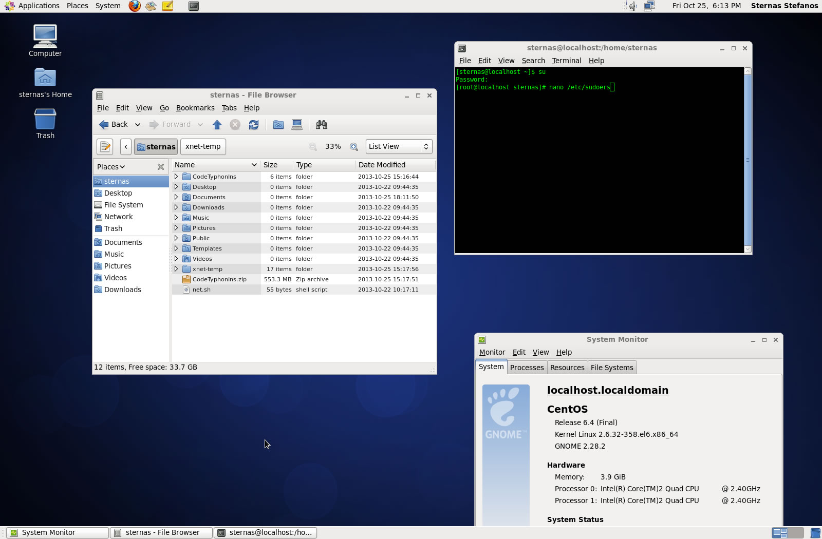

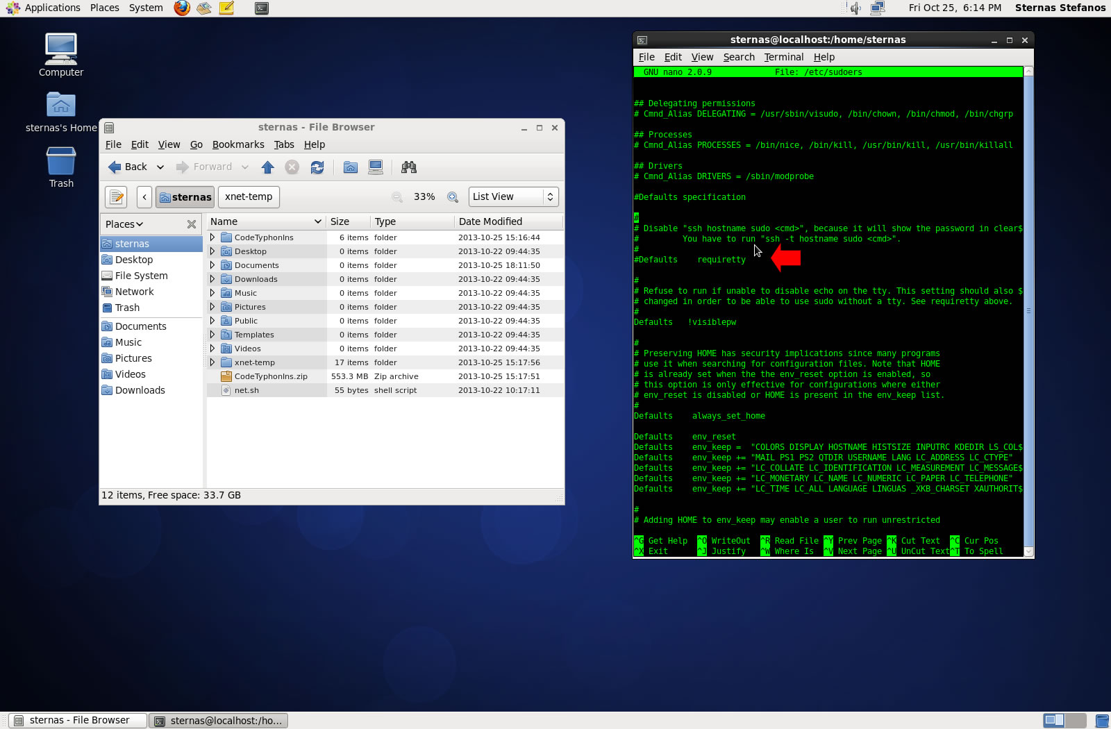

3)-Give full "sudo" permissions to current user.
USER	ALL=(ALL) NOPASSWD: ALL
and comment out this line
#Defaults requiretty
4)-Install "System Libraries" from CT installation script.
5)-Install and Build Typhon IDE.
and programming tests...

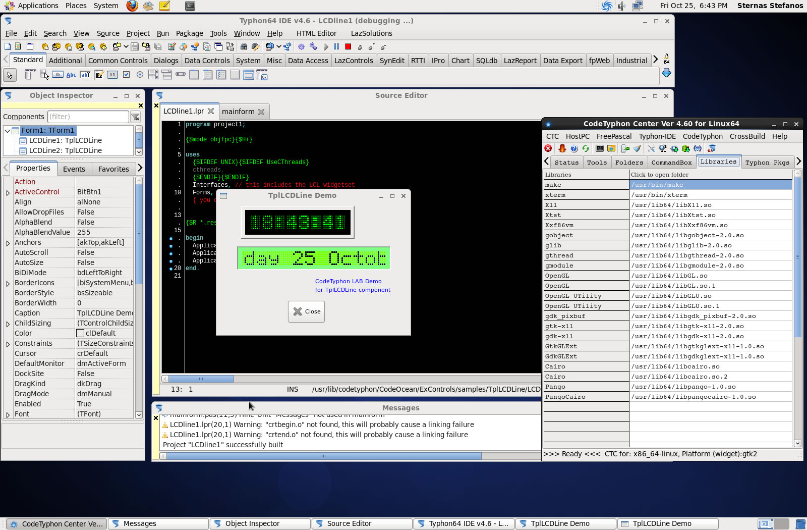

[LAB] CodeTyphon on CentOS 6.4 13 years 4 weeks ago #4669

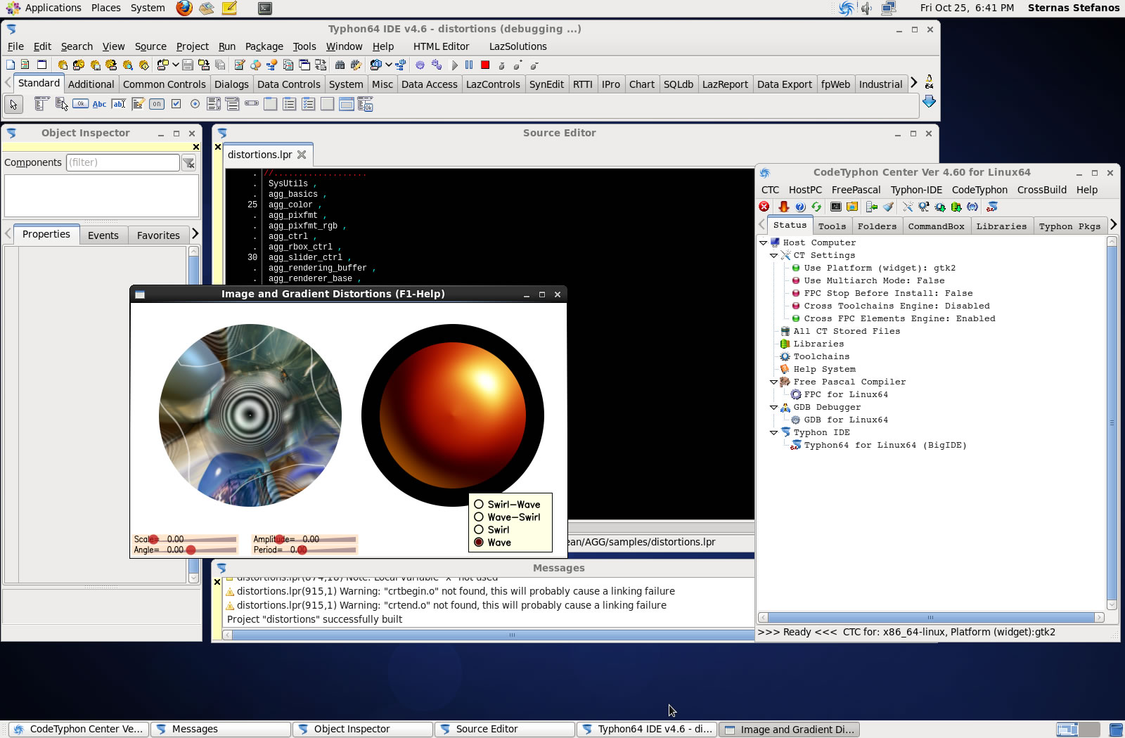

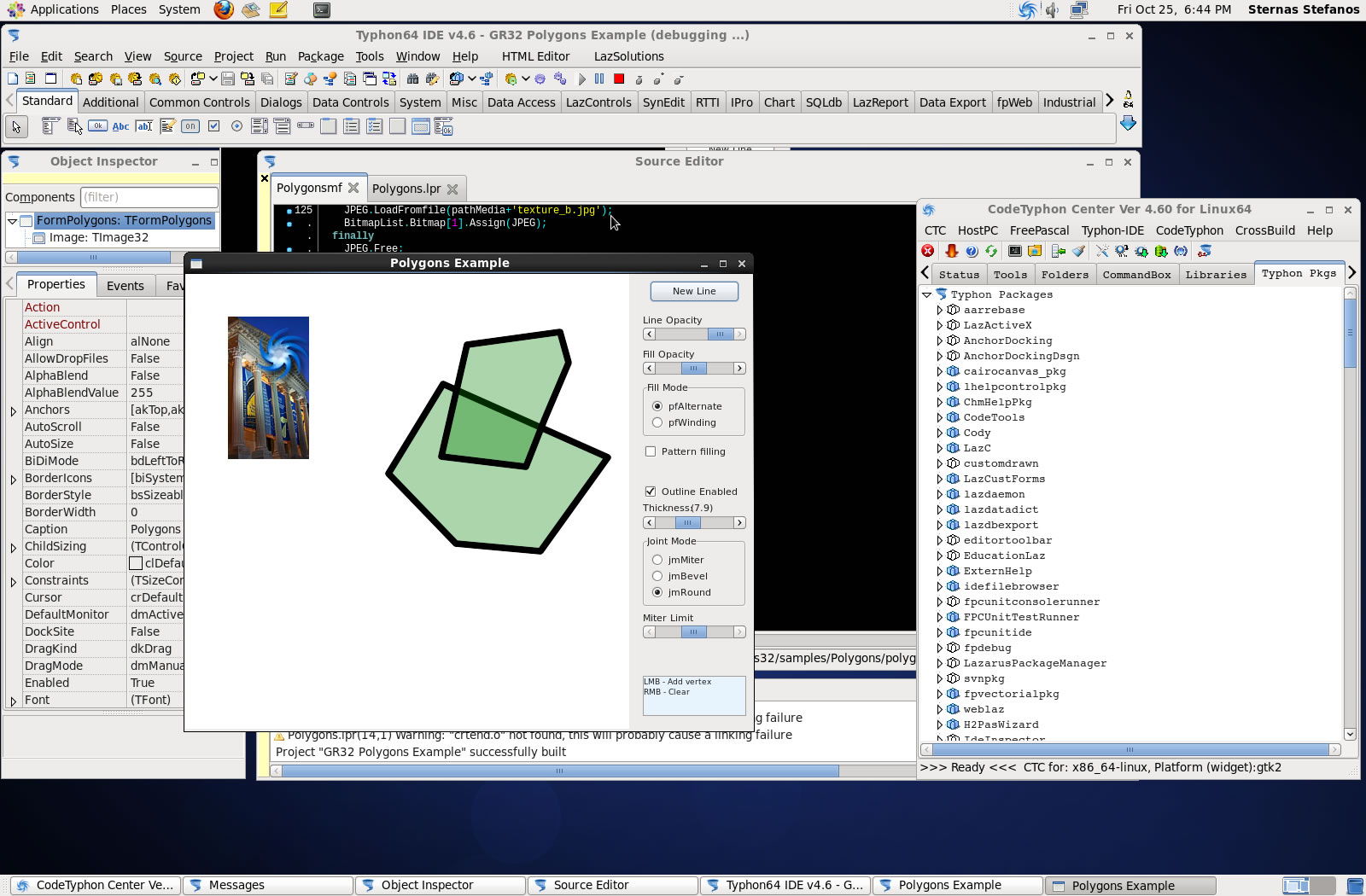

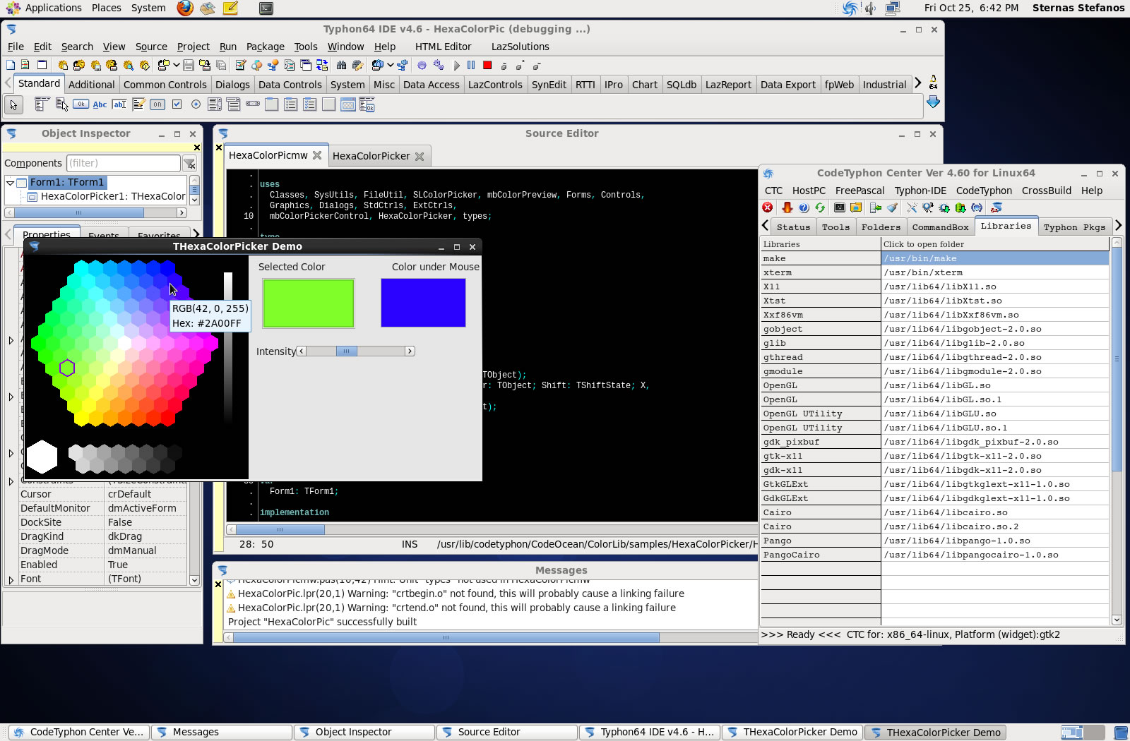

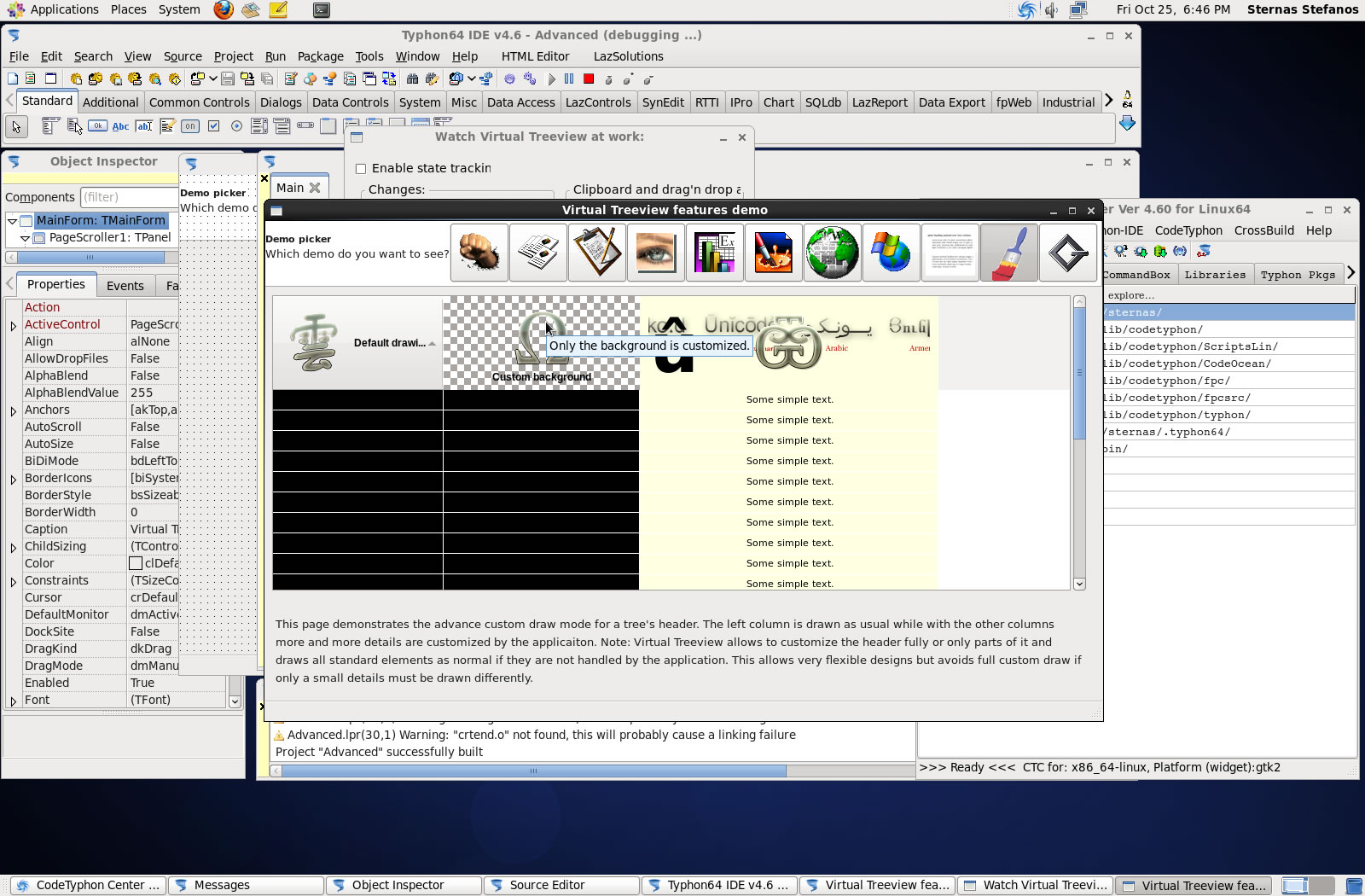

General CT tests list:
-CT Installation
-CT Build All procedure
-CT Update procedure
-FreePascal compiler tests
-Typhon IDE tools tests
-CodeOcean samples tests
pl_AGGPas,
pl_ColorLib,
pl_ExControls,
pl_Graphics32,
pl_VirtualTrees
pl_ZenGL,
pl_OpenGL,
pl_GlassDocking,
