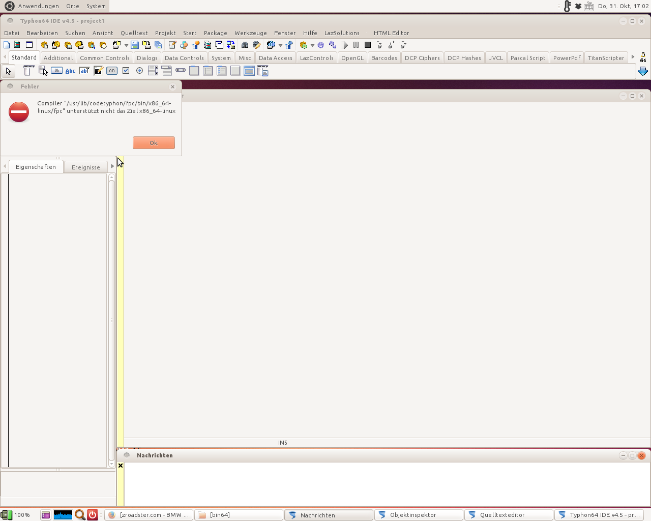

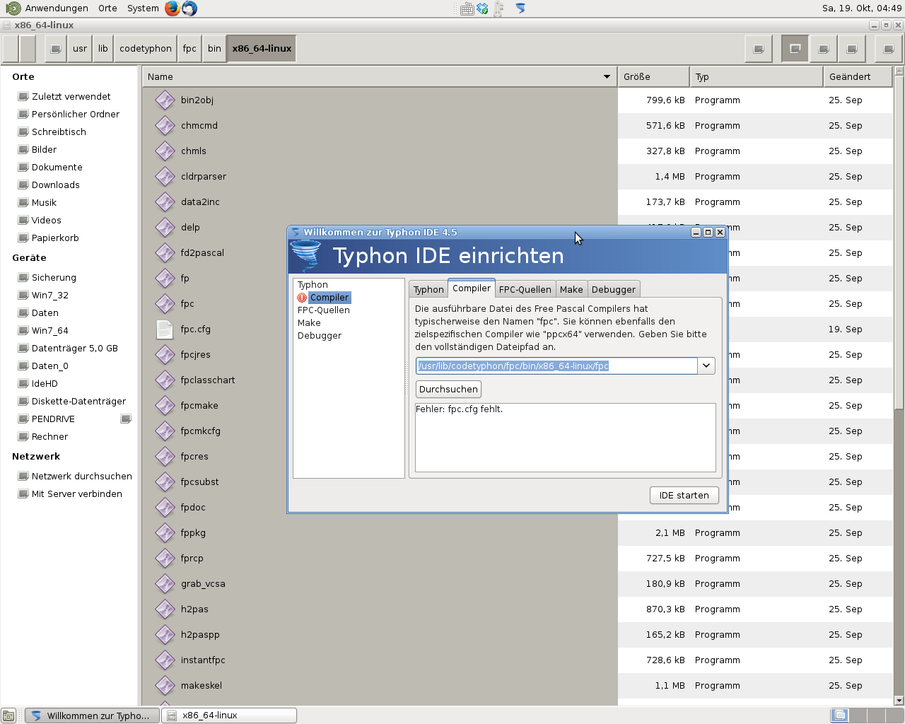

I do have installed CT on a Ubuntu 13.10 x86_64. During the start procedure an error message raises that there was no fpc.cfg. I have checked that and the file already exists. Is it a rights problem ? :(
Any hints are welcome

I have done your advice but I got the same error. I have clicked forward to all error messages that are raised and there is the last one which makes me a little bit astonished, because it tolds me that I'm using the wrong type of Typhon but on the other hand I can compile the default project and it was running without problems.

Sir my suggestion
open CT center and Typhon->"IDE Settings, Restore Default"

Yes Sir, you are right. CT is now starting in the right way. :)
