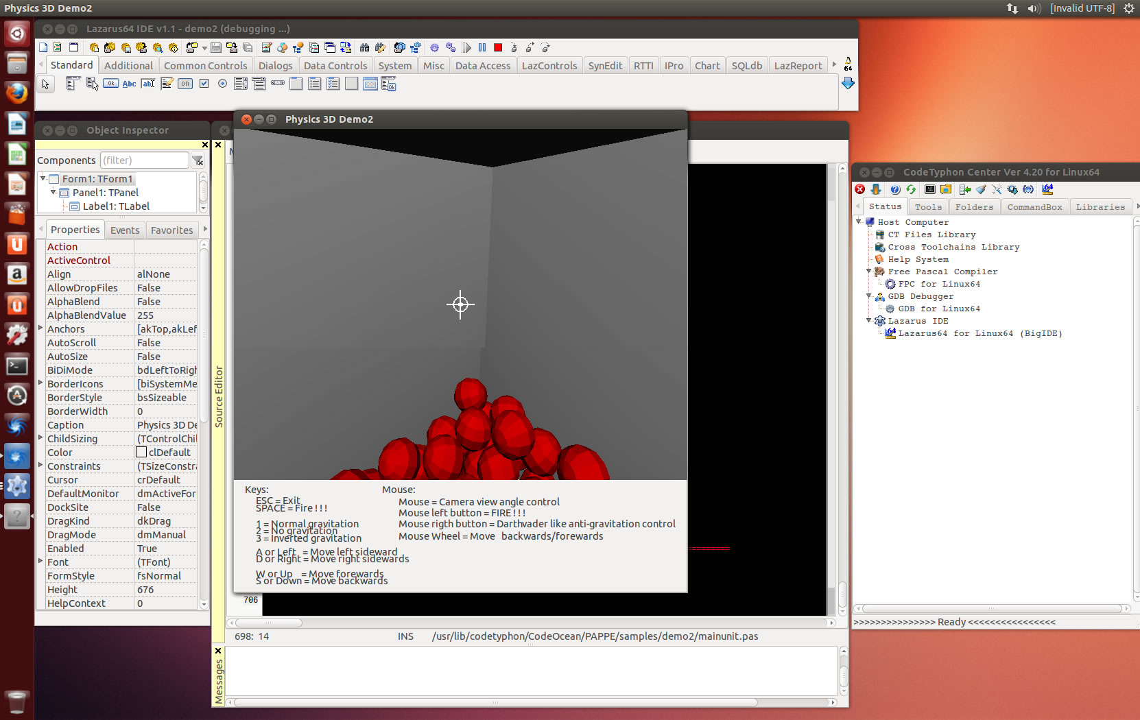

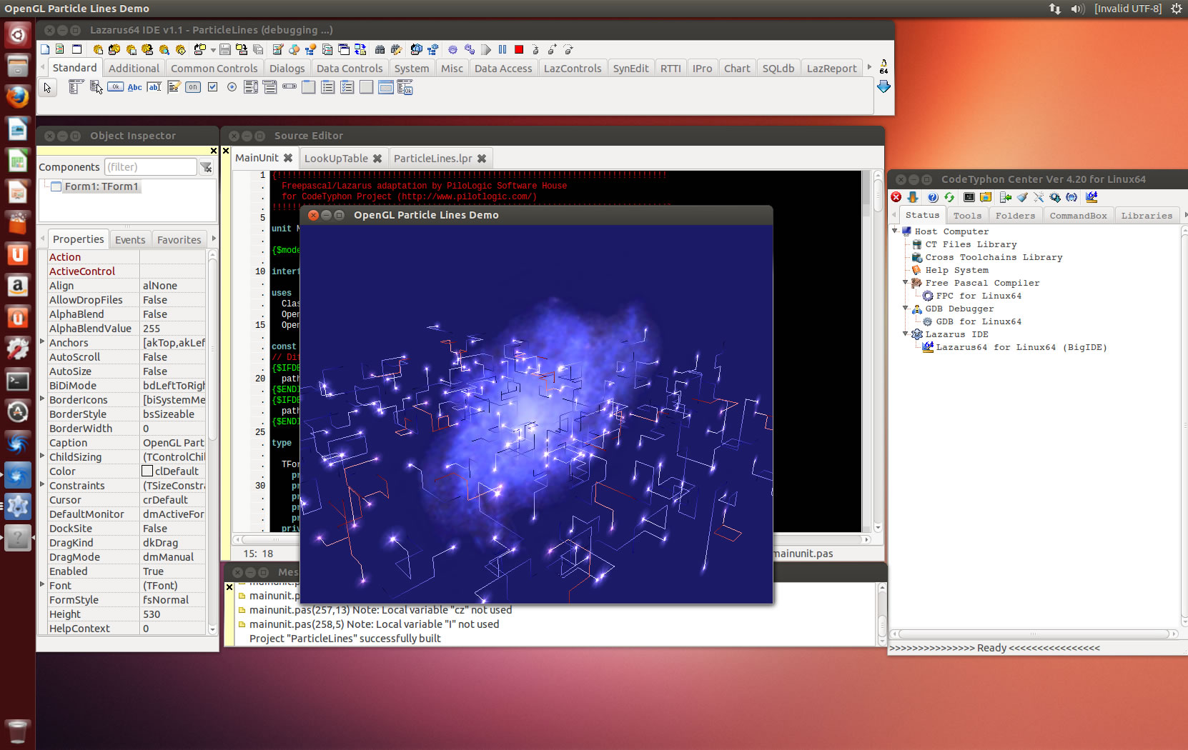

CodeTyphon on Ubuntu 13.04 13 years 5 months ago #3524

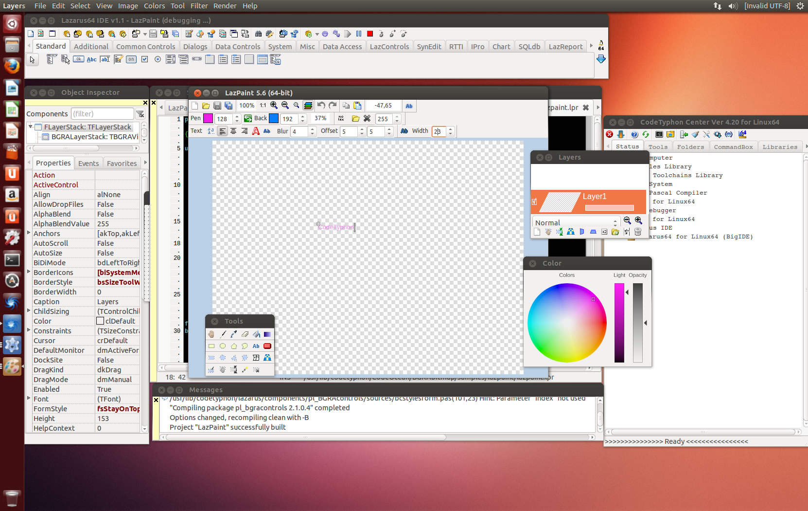

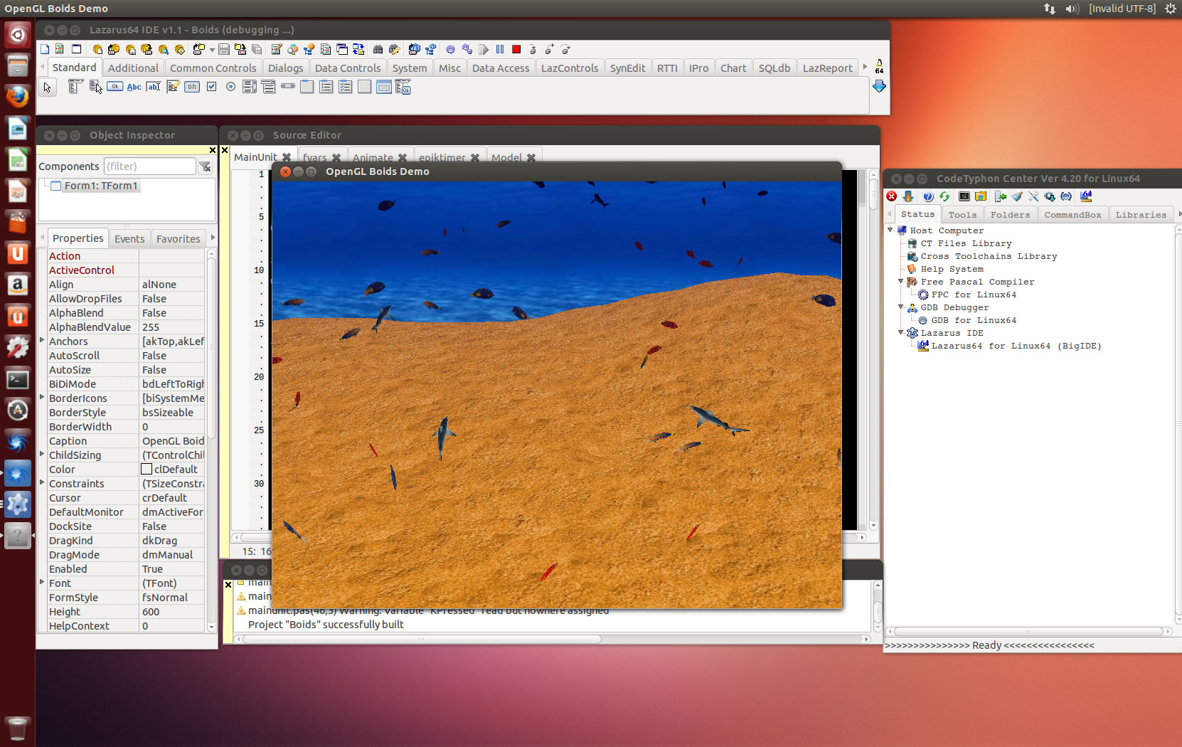

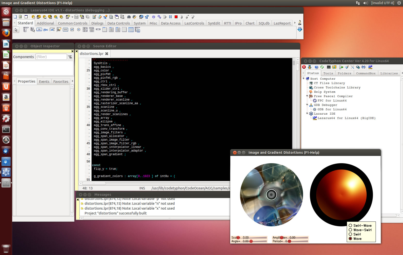

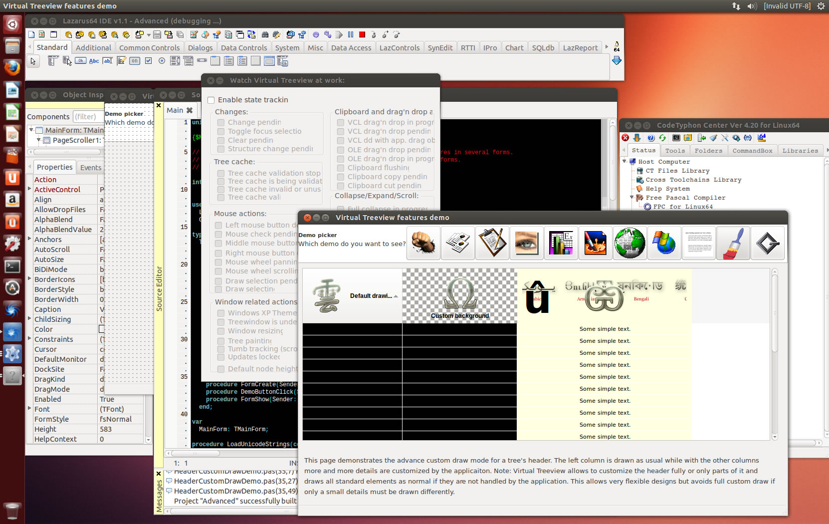

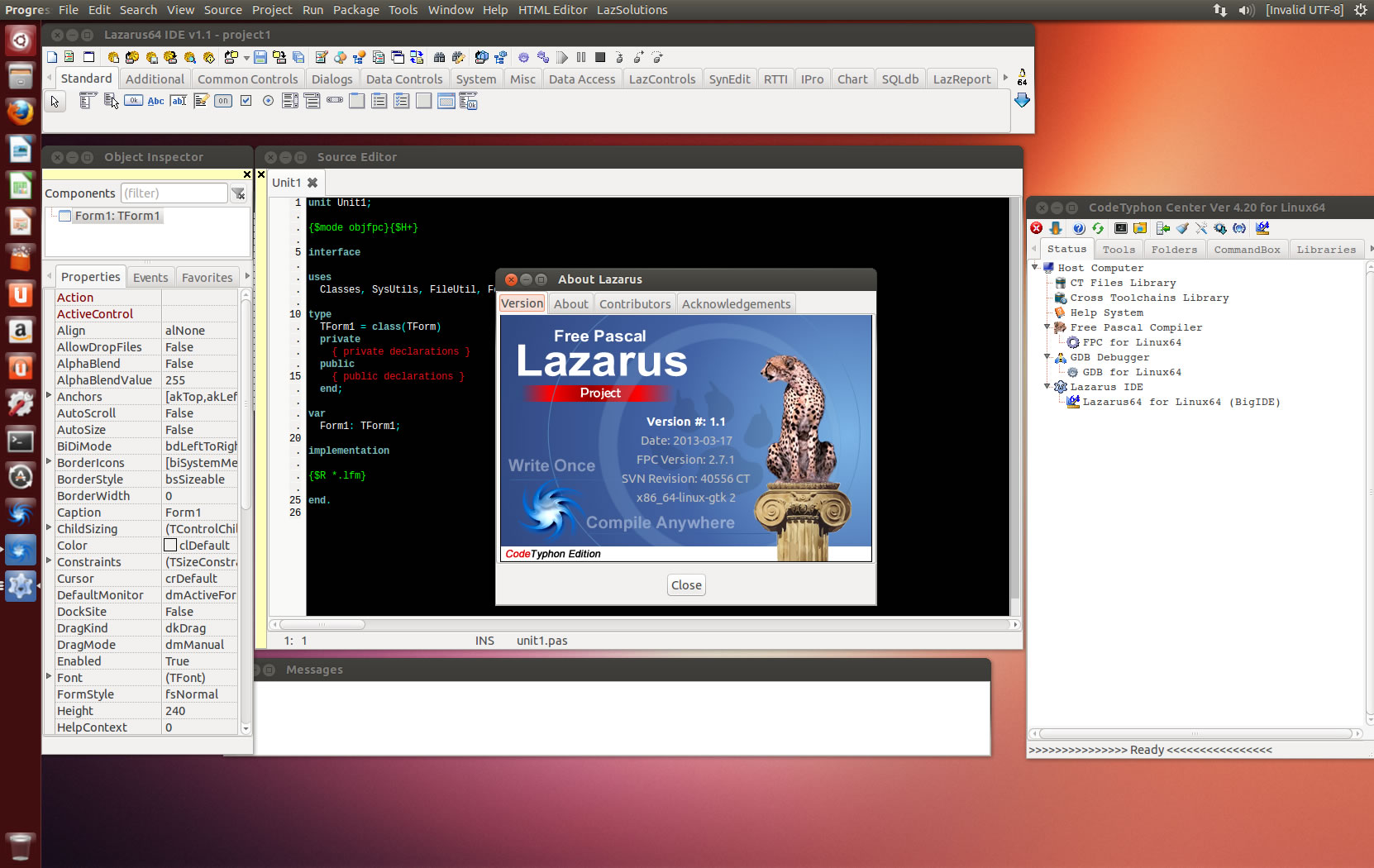

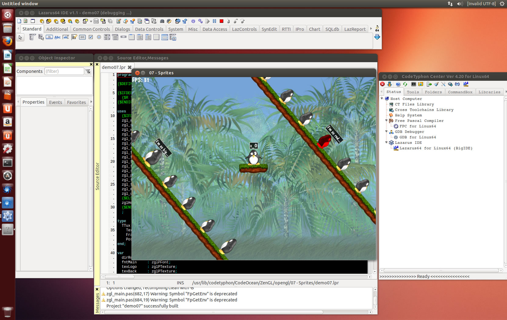

We test CodeTyphon Lab ver 4.20
on Beta1 Ubuntu 13.04 (Raring Ringtail) 64bits
Tests list:
1)CT System libraries installation
2)CT Installation
3)CT Build All procedure
3)CT Update procedure
4)CT ToolChains download procedure
5)FreePascal compiler tests
6)Lazarus IDE tests
7)CodeOcean samples tests
Some screen with CT libraries:
pl_GlassDocking,
pl_AGG,
pl_BGRAbitmap,
pl_Opengl,
pl_Pappe,
pl_VirtualTrees,
pl_ZenGL,
etc...
