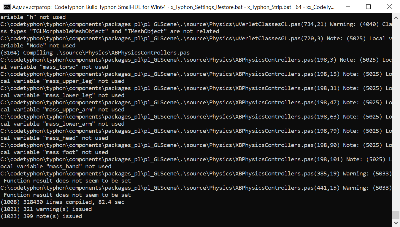

hy does the CT installation freeze?
Multiple attempts to reinstall, including manually deleting everything, end with the same thing - see screenshot
Warning: Spoiler!
OS: Windows 10 Pro, 16Gb RAM, CPU 12 Cores, a lot of free disk space
The problems started when I tried to add components - the IDE rebuild ended with an error (exception), and after that I can’t restore functionality....

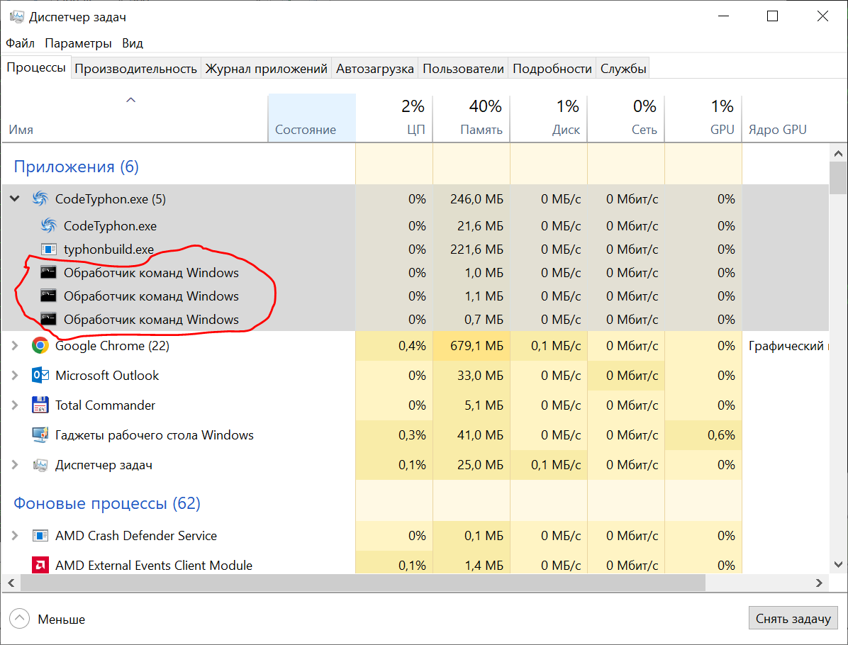

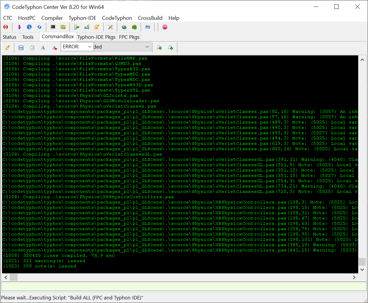

Here is the result of another attempt:
Here is a screenshot of the task manager - why three console processes? Maybe this is the reason? Could there be some kind of conflict during parallel compilation?

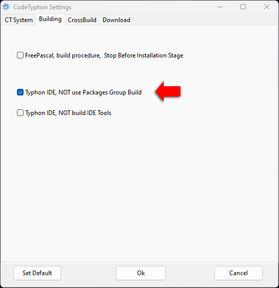

We want to see which TyphonIDE Package has Problem.
2 options:
1) Build Only Small Typhon IDE
Open Small TyphonIDE and ReBuild IDE
2) CTCenter=>CodeTyphon=>Settings
Build Typhon BigIDE  with CTCenter.
