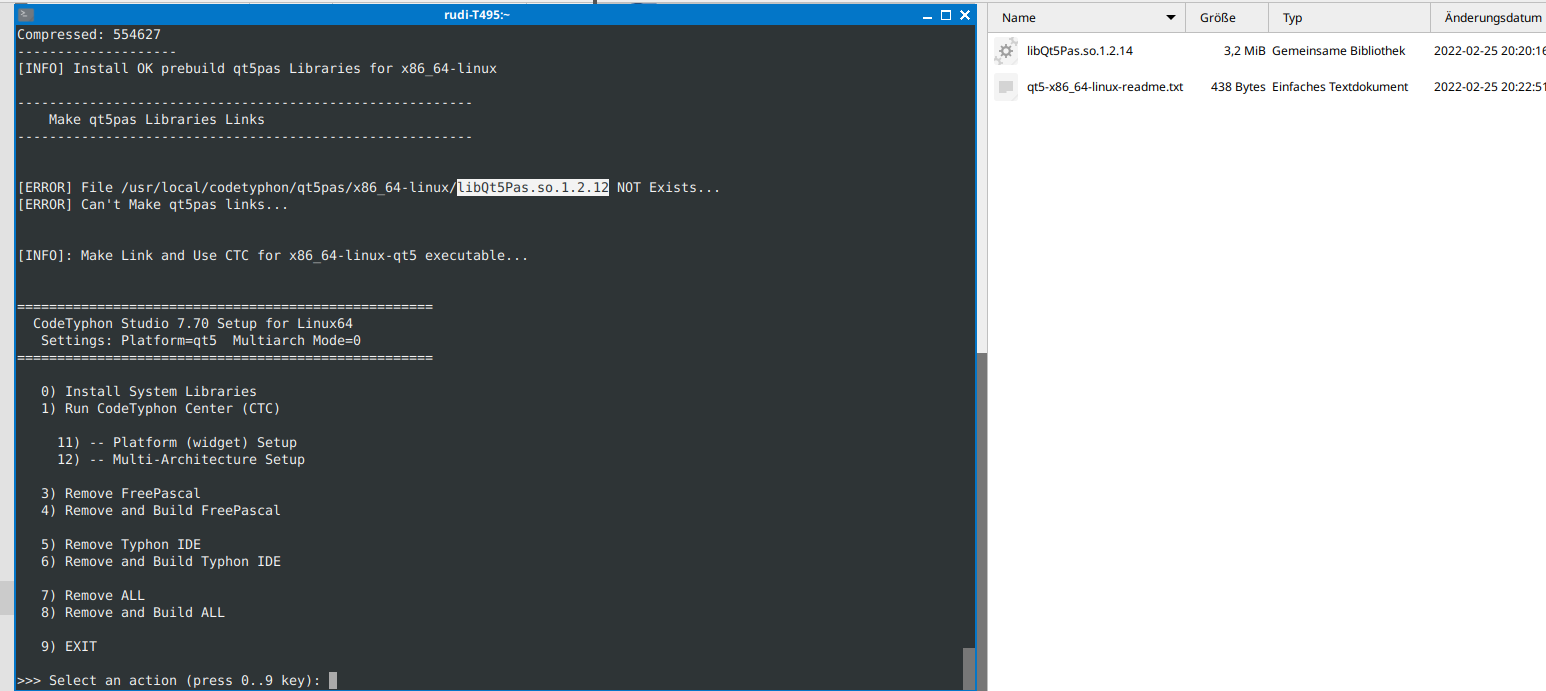

Hello everyone,
I'm trying to compile an application on QT5 for the first time,
but I'm already failing when creating Codetyphone.
I have completely removed Codetyphone from the system and want to rebuild it new.
First I installed the system libraries and then Platform (widget) Setup -> QT5.
Then I wanted to create Codetyphon but it fails.
I had to make changes to the 'ln_Typhon1_QT5pas*.sh' files on the first try because
it was looking for libQt5Pas.so.1.2.12 but libQt5Pas.so.1.2.14 was there.
But the installation fails even after repeated attempts.

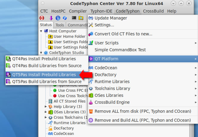

Try to Update your CodeTyphon Installation to
to LAB CT 7.8  more info
After CT 7.8 update
CTCenter => CodeTyphon => QT Platform => "QT5PAS Install Prebuild Libraries"
and Rebuild Typhon IDE

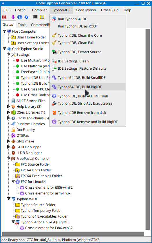

By 'Rebuild Typhon IDE' do you mean as shown in the picture?
I added QT5 to the widget settings, does anything else need to be changed?

After Update to CT 7.80
Open CTCenter
1) CTCenter => CodeTyphon => QT Platform => "QT5PAS Install Prebuild Libraries"
to install QT5 libQt5Pas.so.1.2.14 to your OS
2) CTCenter=>CodeTyphon=> "Remove and Build ALL"
FreePascal of LAB CT 7.80 it's NOT the same with CT 7.70
