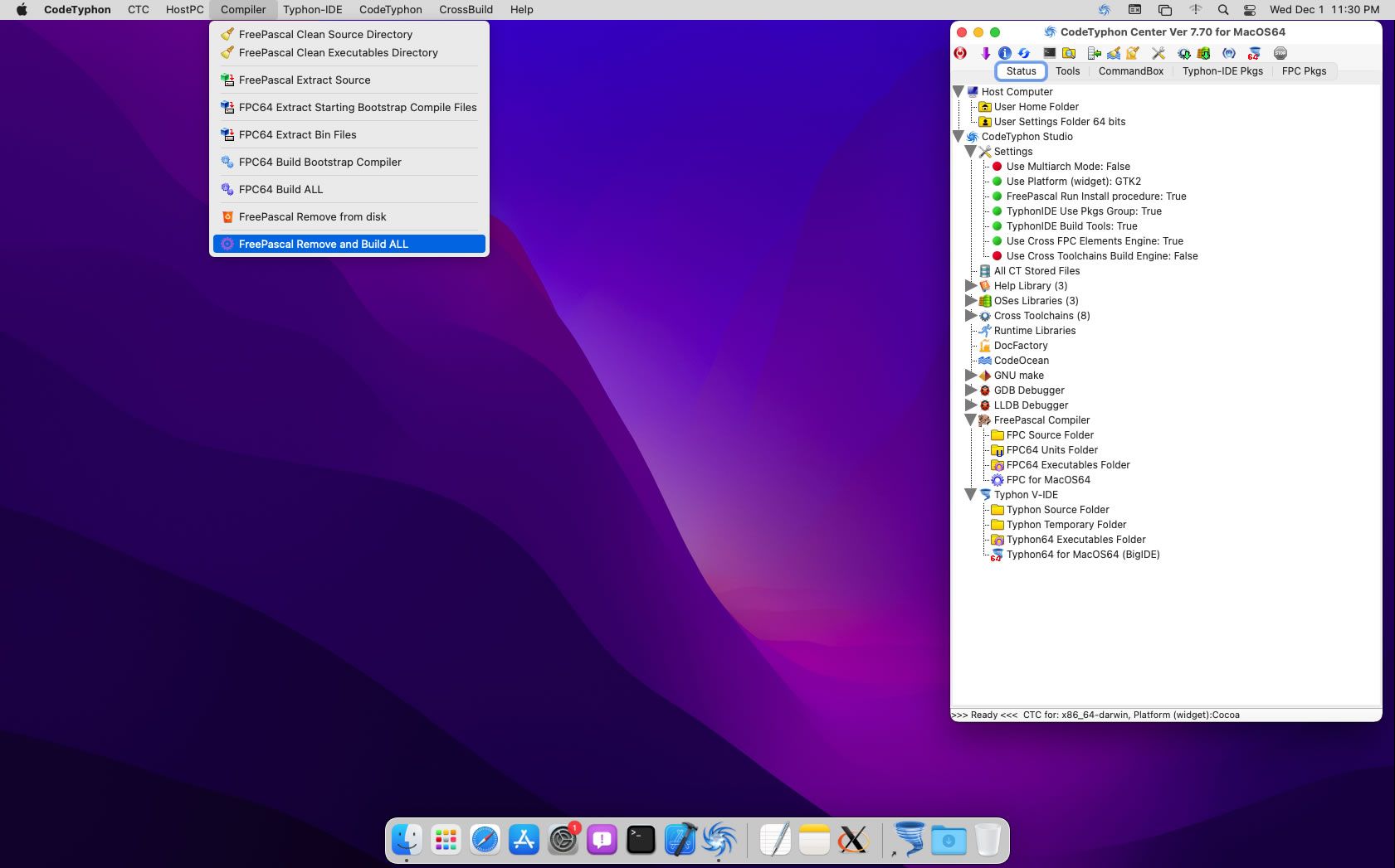

install CT 7.6 failed on Mac Monterey intel amd64 4 years 11 months ago #16338
Yes, from Launch bar exec "CodeTyphon" app is the CTCenter
CTCenter => Compiler => FreePascal Remove and Build All

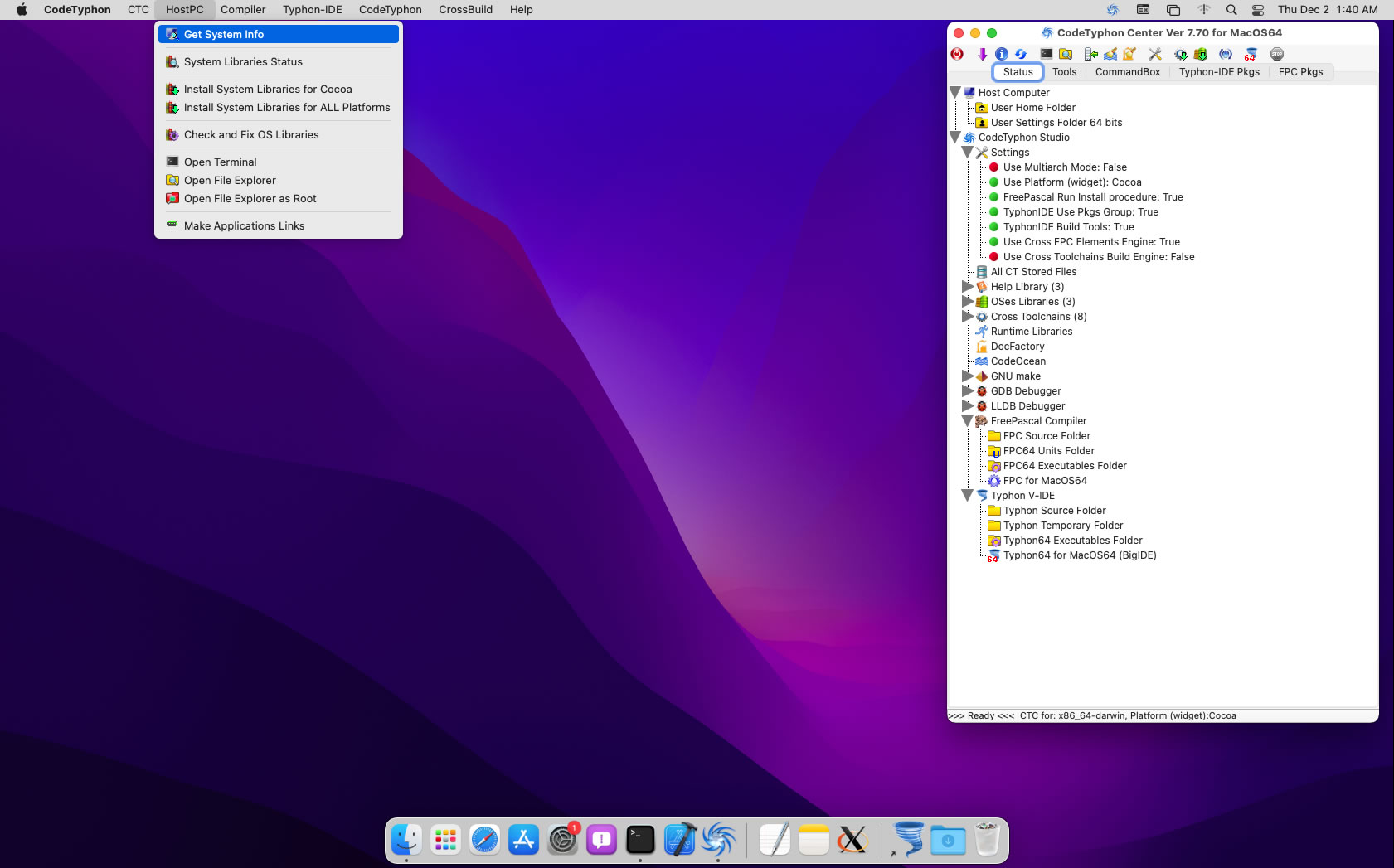

And the last trick
CTCenter => HostPC => Get System Info

install CT 7.6 failed on Mac Monterey intel amd64 4 years 11 months ago #16360
Try this
sudo rm -rf /Library/Developer/CommandLineTools
xcode-select --install
and CTCenter => CodeTyphon => "Remove and Build ALL"
