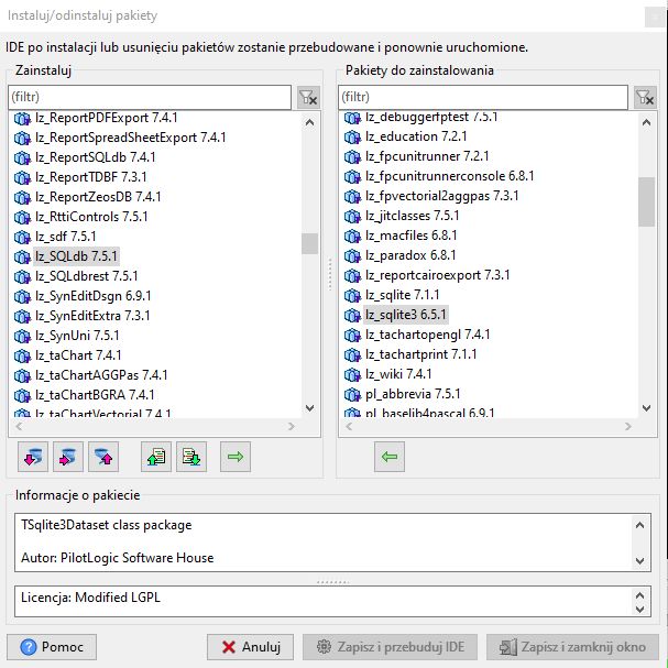

I installed today package abbrevia and sqllite, from official package manager in typhon, after that ... typhon 32 failed to start, when I click on typhon shortcut, I see only splashscreen with typhon graphics, and thats all, after that execution is halted , and program exit.
typhon 7.5 32bit
typhon 7.5 64bit / tested and works with abbrevia package and sqllite installed

as I said I have installed abbrevia and sqllite 7.1.1 and then it seems like typhon 32  bit did not compiled sucessfully, and it does not run..
I installed these packages using this package installer (image attached) , and then I removed these two packages using typhon 64bit, but typhon 32 bit did not recompiled, and I still cannot run typhon 32 bit, how I can recover typhon 32 bit exe to run sucessfully ?
EDIT : I reinstalled typhon32bit, using CodeTyphon Center, and tried to install abbrevia, all ok , then tried to install sqllite 7.1.1 , then typhon32bit doest not run, so it seems that there is some problem with this package sqllite  7.1.1, I dont know..

  • Posts: 223
Why do you need packages lz_sqlite or lz_sqlite3?
Package lz_sqldb is enough to work with SQLite in your application (as long as you put sqlite3.dll in your application folder).
I have many projects who use SQLite databases and none of them needs packages lz_sqlite or lz_sqlite3.
