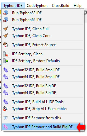

Ubuntu20 install CodeTyphon7.20 fail !! 6 years 1 month ago #15108
  • Posts: 1436
  • Thank you received: 233
Open CTCenter
-Go to Typhon-IDE
-Select "Typhon-IDE Remove and Build BigIDE"
-Save Action Log to a file and zip it more info
-Attach here this zip file for more problem analysis
Ubuntu20 install CodeTyphon7.20 fail !! 6 years 1 month ago #15109

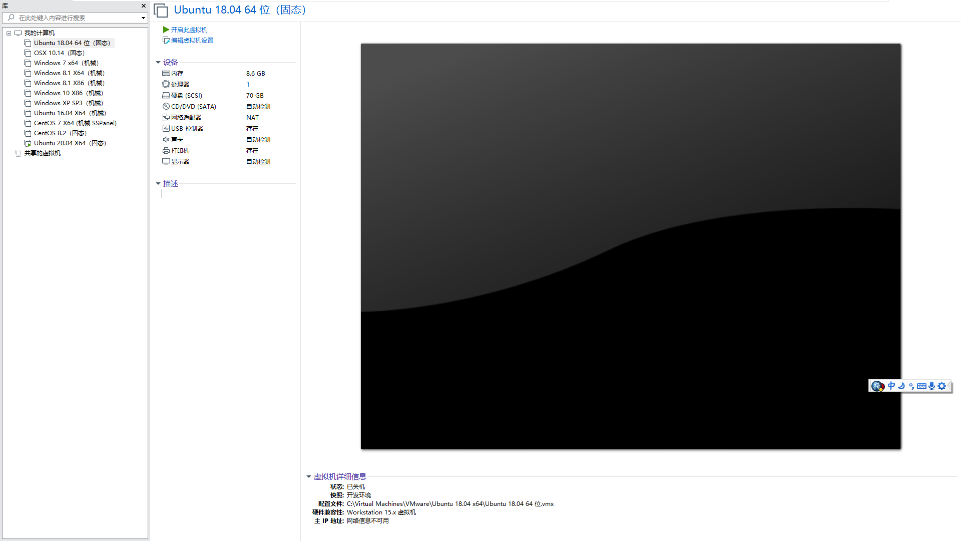

Sir thanks :
Your PC Host OS ? Windows 10 X64
Your VM CPU number, RAM Memory and Disk space ?
CPU number : 1
RAM Memory : 8.6GB
Disk space : 70GB
when i install CodeTyphon7.20 on Ubuntu18.04 success in same VM !!!
Last edit: by SunYuLiang.

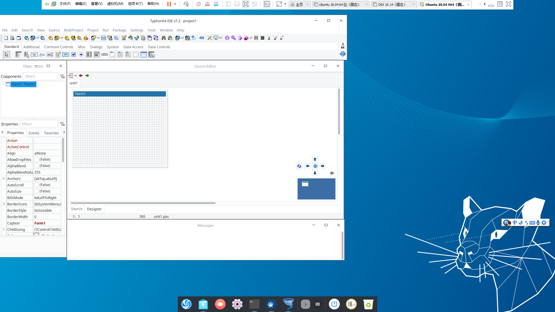

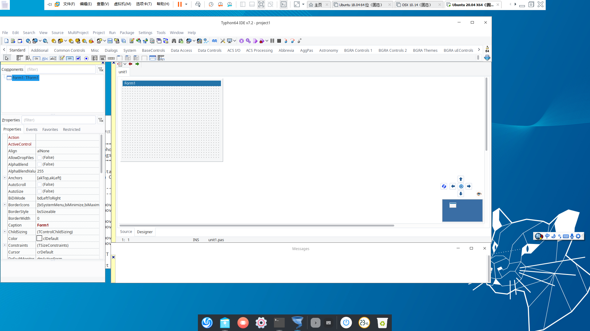

Ubuntu20 install CodeTyphon7.20 fail !! 6 years 1 month ago #15115
  • SunYuLiang
  • SunYuLiang's Avatar Topic Author
  • Posts: 16
Sir:
Thanks a lot !!

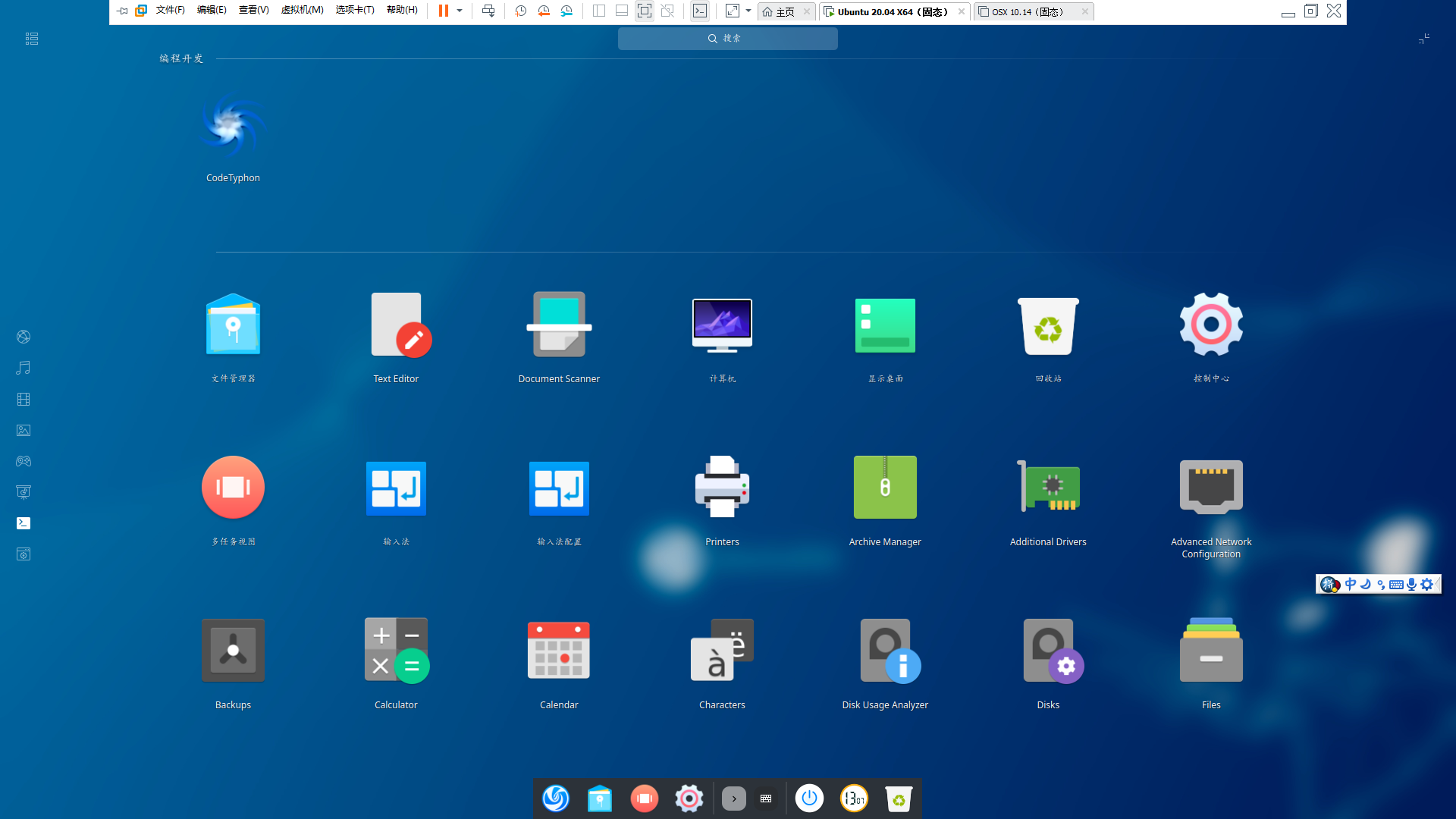

I install CT7.20 as you show , i think have success install it !!! now it look like right !!those question all disappear !!
I didn't understand ,why change CPU number to 4 install success ? but Ubuntu18.04 is 1 CPU also install success ?
this install success IDE picture :
sir , thank again !!
Ubuntu20 install CodeTyphon7.20 fail !! 6 years 1 month ago #15116
