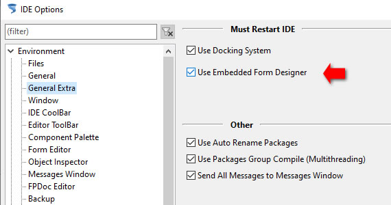

Hi Guys,
Is there a way to dettach the 'Design' tab and make it a floating window, see attachment. If there is, and some recompiling that is needed and a bit of rocket-science please share this with me. I have been using Lazarus 2.0.8, and the design can be made to float. I have tinkered with some settings in CodeTyphon 7.10 but no luck at all. The main reason for my asking to help float the design window is for use in multiple screens and obviously for convenience sake, and I think some would agree with me.

Uncheck this
and just Restart Typhon IDE

A Million Thanks and Kudos :) :) :) :) :) :) :)
