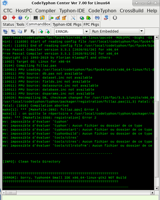

Hello.
I did download last CT 7.0 and upgrade to develop lab from CodeTyphon utility.
fpc 32 and fpc 64 build ok, TyphonIDE32 build ok but Typhon64 not build.
(1002) Target OS: Linux for x86-64
(3104) Compiling fcllaz.pas
(10001) PPU Loading /usr/local/codetyphon/fpc/fpc64/units/x86_64-linux/fcl-db/db.ppu
(10011) PPU Source: db.pas not available
(10011) PPU Source: dataset.inc not available
(10011) PPU Source: fields.inc not available
(10011) PPU Source: datasource.inc not available
(10011) PPU Source: database.inc not available
(10011) PPU Source: dsparams.inc not available
(10028) Recompiling DB, checksum changed for /usr/lib/fpc/3.3.1/units/x86_64-linux/rtl/system.ppu
/usr/local/codetyphon/typhon/packager/registration/fcllaz.pas(11,3) Fatal: (10022) Can't find unit DB used by fcllaz
make[1]: *** [Makefile:2892: fcllaz.ppu] Error 1
make[1] : on quitte le répertoire « /usr/local/codetyphon/typhon/packager/registration »
make: *** [Makefile:3366: registration] Error 2
mv: impossible d'évaluer 'typhon': Aucun fichier ou dossier de ce type
mv: impossible d'évaluer 'typhonstart': Aucun fichier ou dossier de ce type
mv: impossible d'évaluer 'typhonbuild': Aucun fichier ou dossier de ce type
mv: impossible d'évaluer 'tools/ctres': Aucun fichier ou dossier de ce type
mv: impossible d'évaluer 'tools/ctlrstofrm': Aucun fichier ou dossier de ce type
I use Linux Debian 10.1 - 64 bit, with 64 gigas ram.
Why Typhon64 not build?
Thanks.

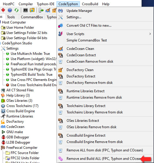

> "Remove and Build ALL"
Huh, I do not see Remove and build all in CT center, I see it only while using the script install.sh.
So I did from CT center "Typhon IDE remove all and build big IDE".
Here the log file in attachment

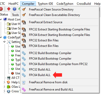

The problem is in FPC NOT in Typhon IDE
Try to Build FPC 64
OR
Build ALL FPC and Typhon

Hello Strenas.
Try to Build FPC 64
Done, no problem, see log in attachment fpc64_codetyphon.zip

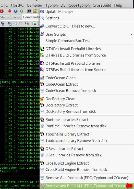

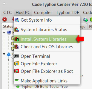

2) CTCenter => HostPC=>"Install System Libraries"
3) CTCenter =>CodeTyphon=>"Remove build ALL"
4) Finally
Typhon32, Typhon64
Now, Debian support again MultiArch and MultiPlatform CodeTyphon Studio Technologies

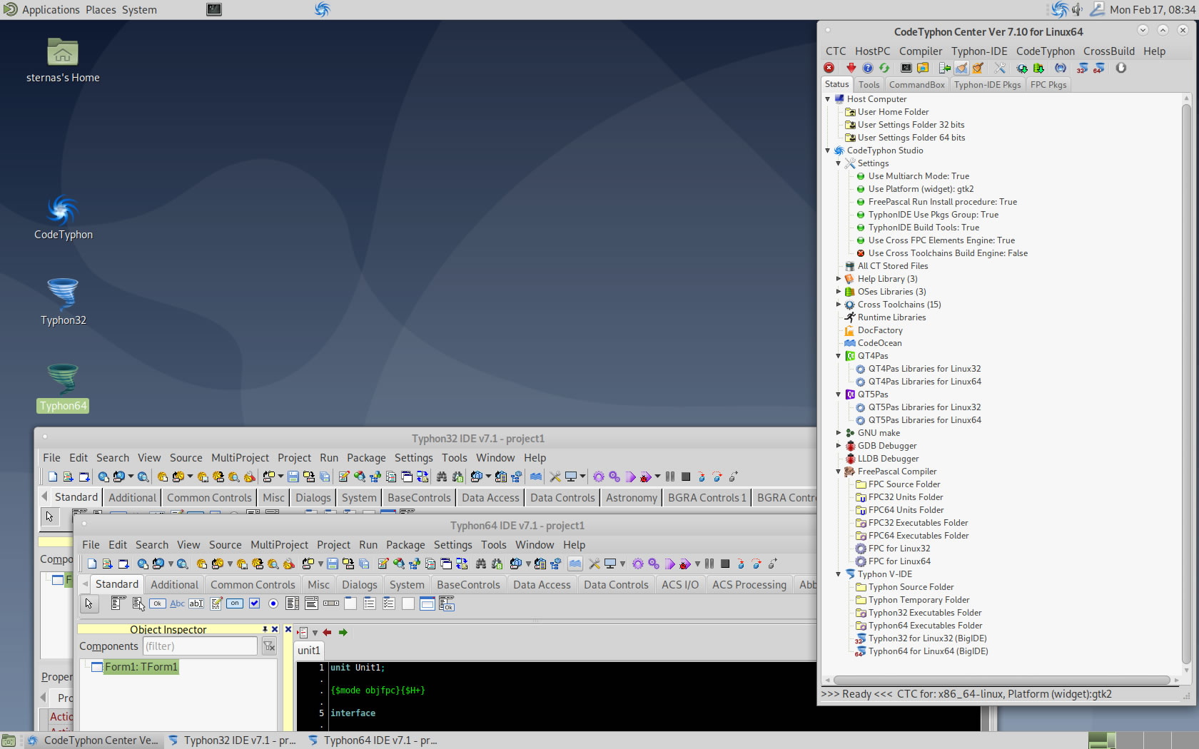

Typhon IDE 32 build OK, Typhon 64 not ok 6 years 8 months ago #14383
  • fredvs
  • Posts: 209
Hello Sternas.
Yep, gooooaaaal!
OK, Typhon 64 is installed now, well done.
