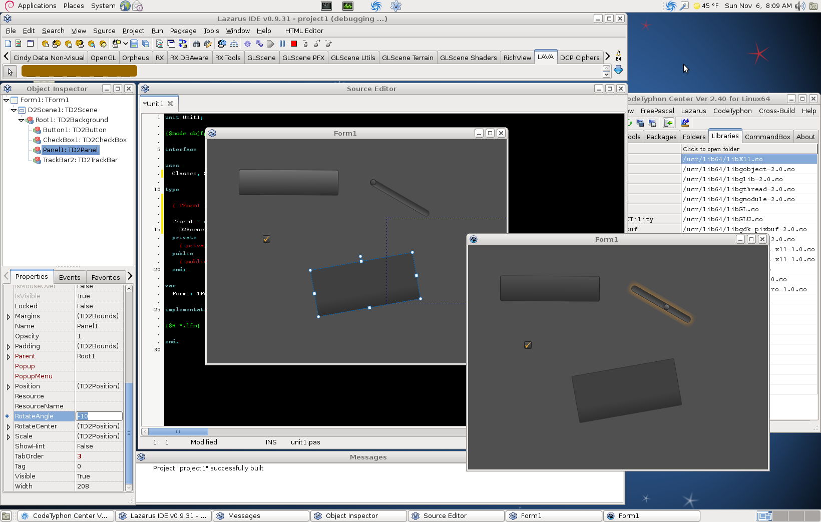

oh, a screen from pl_Lava pkg on Debian Linux 6.0.3 64 bit...
