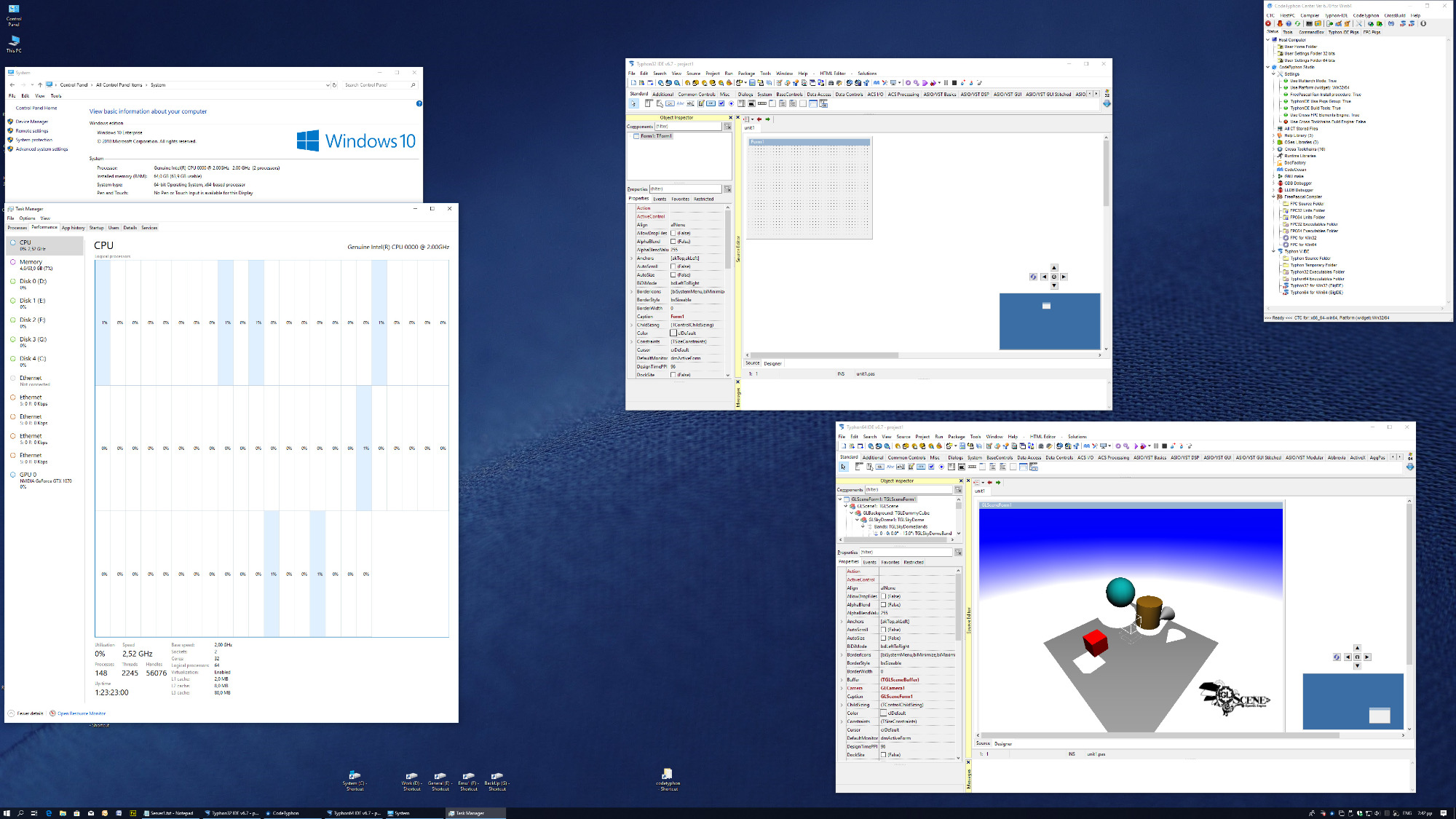

3) A screen from our LAB WorkStation-4 PC
-2x Xeon E5 V4 (2x16 Cores, 64 Logical processors)
-2x Crucial 32GB DDR4 ECC CL17 2400MHz (CT4K8G4RFD824A)
-ASUS Z10PE-D8 WS
-Samsung 950 Pro MZ-V5P512BW
-Palit GTX1070 8GB JetStream
-iiyama ProLite X4071UHSU-B1 (4K 3840x2160 pixels)
-etc
The minimum PC in our LAB (4x) has CPU AMD Athlon with 4 cores / 8 Gbytes RAM / 120Gbytes SSD

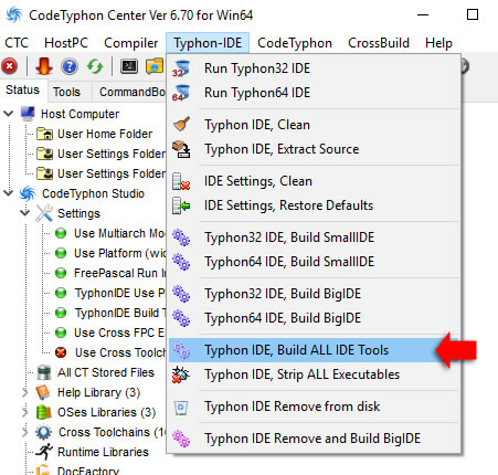

Problem installing Big IDE on Win7 32 Bit. 7 years 11 months ago #12783
Peter Heckert wrote: Sir,
I have a propososal:
So far I have seen the chmviewer is not built, when the compilation aborts and the big IDE is not built.
Especially for beginners like me, who would prefer the small or medium IDE it would be helpful if the chm help is installed always.
Or, at least the viewer should be built always.
Thanks,
For these cases we have CTCenter => Typhon-IDE => Build ALL IDE Tools
The following user(s) said Thank You: Peter Heckert
