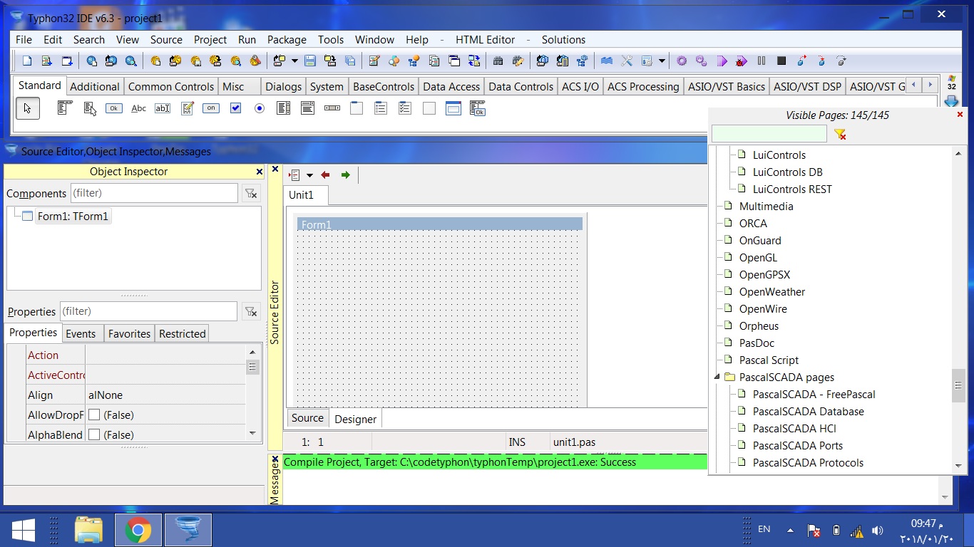

There was another problem related to FPC32 since it needs a lot of memory, but I used another computer with more memory to make the new typhon.exe.
I finally managed to build The IDE with much more components.
I attached a screenshot of the IDE.
Thank you very much.
