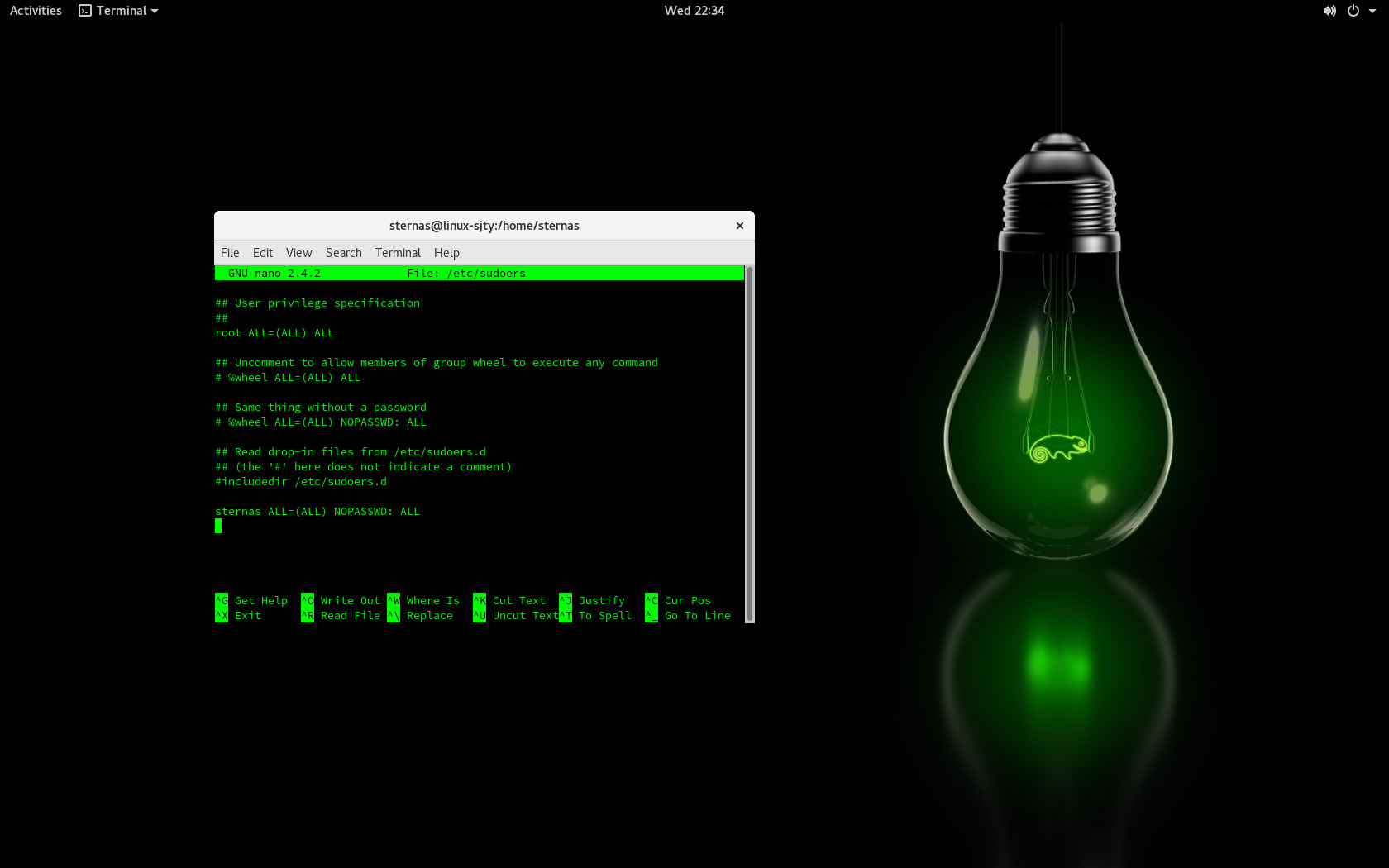

opensuse 42.2 9 years 5 months ago #10657
try
sudo nano /etc/sudoers
add
yourusername ALL=(ALL) NOPASSWD: ALL
Defaults timestamp_timeout=-1
ctl+x and y to save and exit

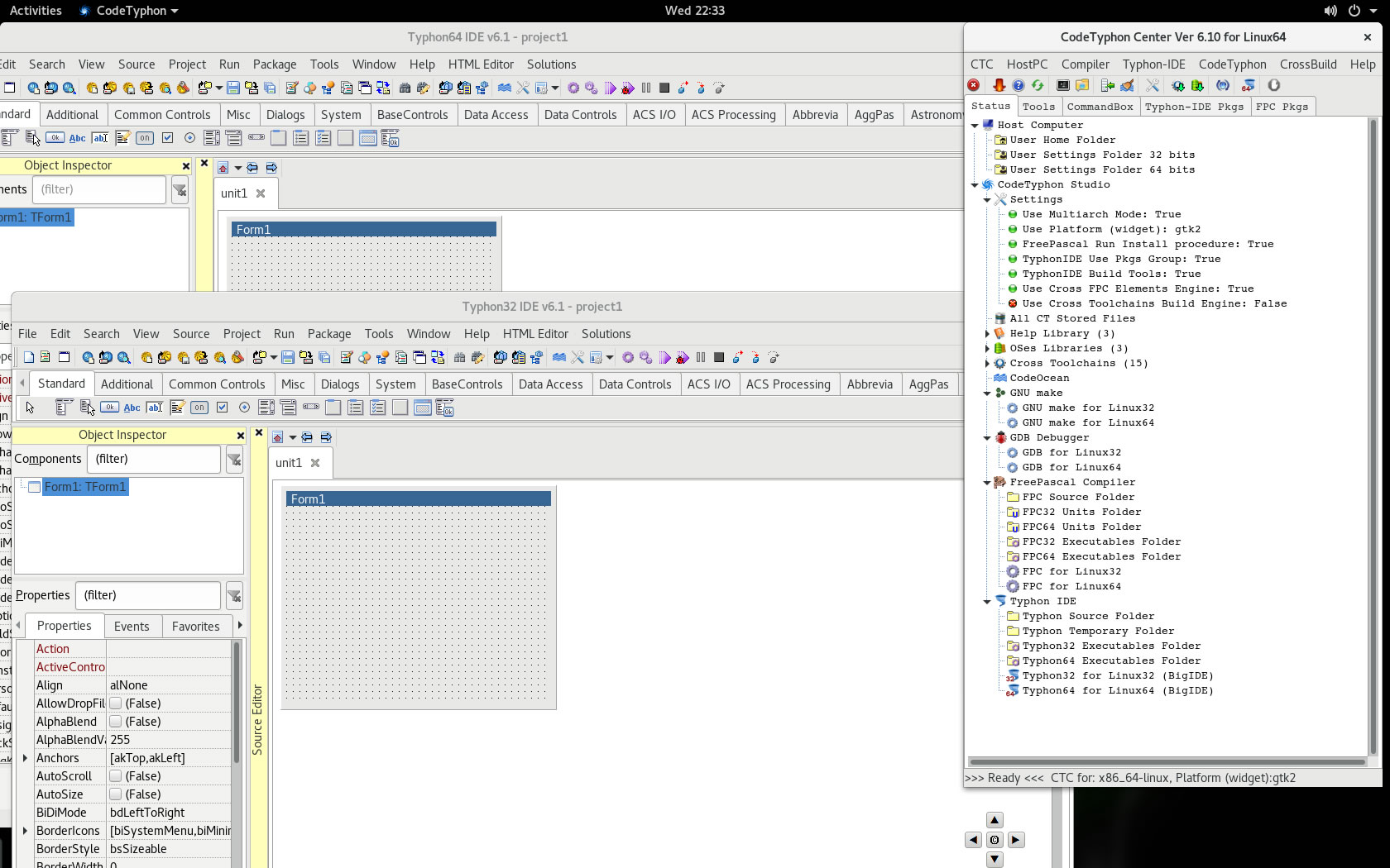

opensuse 42.2 9 years 5 months ago #10665
we test LAB CT 6.10 on OpenSuse 42.2
without problems
Gnome3 Desktop with MultiArch CodeTyphon
