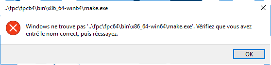

I tried to update my CT 5.90 to 6.00 and I got a message error :
"Windows does not find ..\fpc\fpc32\bin\x86_32-win32\make.exe. Check that you entered the correct name and retry"
I got an identical message for the x86_64-win64 installation. :(
My system is win 10 family 64 bits.
I ran the install.bat as administrator
Any idea ?
thx in advance
Pat

Effectivement l'ancienne installation est effacées mais lors de l'installation de CT 6.00, l'écran de commande montre les erreurs suivantes:
Build Typhon32 small-IDE for win32
[INFO]; FreePascal units for win32 NOT EXIST !!!
Build FreePascal 32bit
[INFO]; FPC32 Source Files NOT EXIST !!!
Je me demande si le fichier codetyphonins.zip n'est pas endommagé sur le site de Pilot Logic
A+
Pat

I proceeded like recommended and checked the integrity of the codetyphonins.zip file but I still have the error shown above. It appears that the installation script cannot copy or install the make.exe (32 & 64 bits) of the FPC.
Did you succeed to install CT 6 on windows ?
Thanks again for help
Pat

I solved the installation issue on Win 10 by re-installing the DirectX run-time libraries. It is quite surprising as the previous version (CT 5.90) worked pretty well without updating the DirectX files.
So everything is ok now (CT 6.0 succesfully installed on Win 10 and Kubuntu 16.04).
Thanks to the developpers team
Regards
Pat
