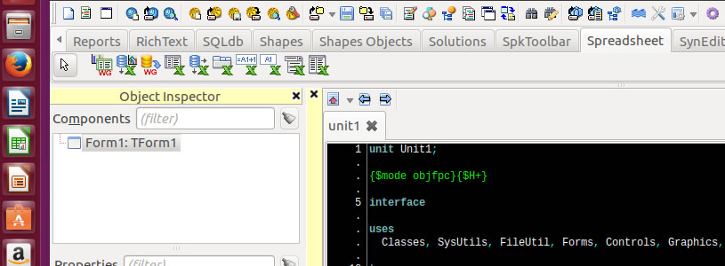

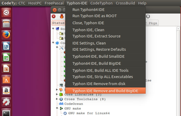

On Unity desktop of Ubuntu
pl_FPSpreadsheet (Spreadsheet) component library
and rebuild Typhon IDE action
In CodeTyphon you can remove and rebuild FreePascal or Typhon IDE unlimited times from CTCenter
with out reinstall CT
Screens form Ubuntu 16.10 now...
