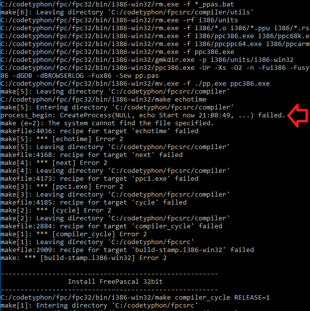

I tried to install CT 5.60 Lab version on Windows 10 with no success. (Same result with 5.50 on another Windows 10 VM).
I have installed this Direct-x library before starting CT installation: directx_Jun2010_redist.exe
Since the error was the same as the one I was getting on Linux (viz., the unit system missing), I tried to rebuild just FP32, and that failed as expected as well. Can some one analyze the attached log file?
My VM has 4GB ram and about 20GB free space on the hard drive.
Thanks!

How to install CT 5.50 or 5.60 on Windows 10? 10 years 10 months ago #8493
My suggestion is to use this installer for DirectX End-User Runtimes link to DirecX Web Installer
for FPC32 the solution (I think) is here

Sternas Stefanos wrote: My suggestion is to use this installer for DirectX End-User Runtimes link to DirecX Web Installer
I had the compatibility mode turned on for both 32 and 64 bit versions of fpc.exe.
Does DirectX run-time have anything to do with FPC build?
Last edit: by hanair.
How to install CT 5.50 or 5.60 on Windows 10? 10 years 10 months ago #8496
No
check if other old FPC file are in your "OS Path"

It is failing only on Windows 10 64Bit. CT 5.60 is successfully installed on Windows 7 64bit,
In the log I noticed the following error:
"process_begin: CreateProcess(NULL, echo Start now 21:08:49, ...) failed."

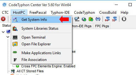

How to install CT 5.50 or 5.60 on Windows 10? 10 years 10 months ago #8499
CTCenter=>HostPC=>Get System Info
zip and post here the "Action Log" file
