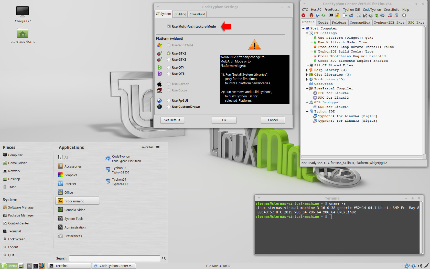

Why problems with "unit system used by fcllaz"? 11 years 3 weeks ago #8484
MintLinux is one of our "main" LAB Linux distribution
Please,
-Open CTCenter =>Settings and set MultiArch enable
-From CTCenter =>HostPC=>Install System Libraries
-Finally rebuild FPC32 and Typhon32
and please check your Mint installation
if you want, I can post many screens

Sternas Stefanos wrote: Sir
Please,

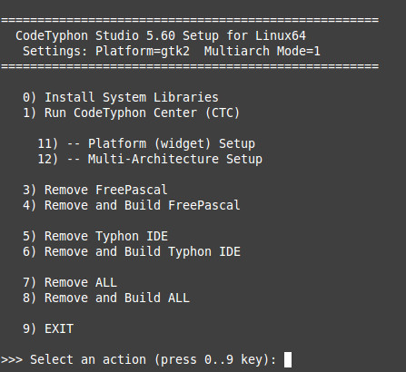

Finally I found the problem I was having since 5.40 and Linux Mint 17.x.
I always install my CT using the command line menu as shown below. I always go by the order as shown in the menu and install System Libraries before doing anything else!
Actually the next option (12) for Mutli Architecture Setup has some influence on the required system libraries!
So you must select "Option 12" and set the Multi Architecture option and only after that you should install system libraries, "Option 0".
Big thanks to Sternas for helping me out!

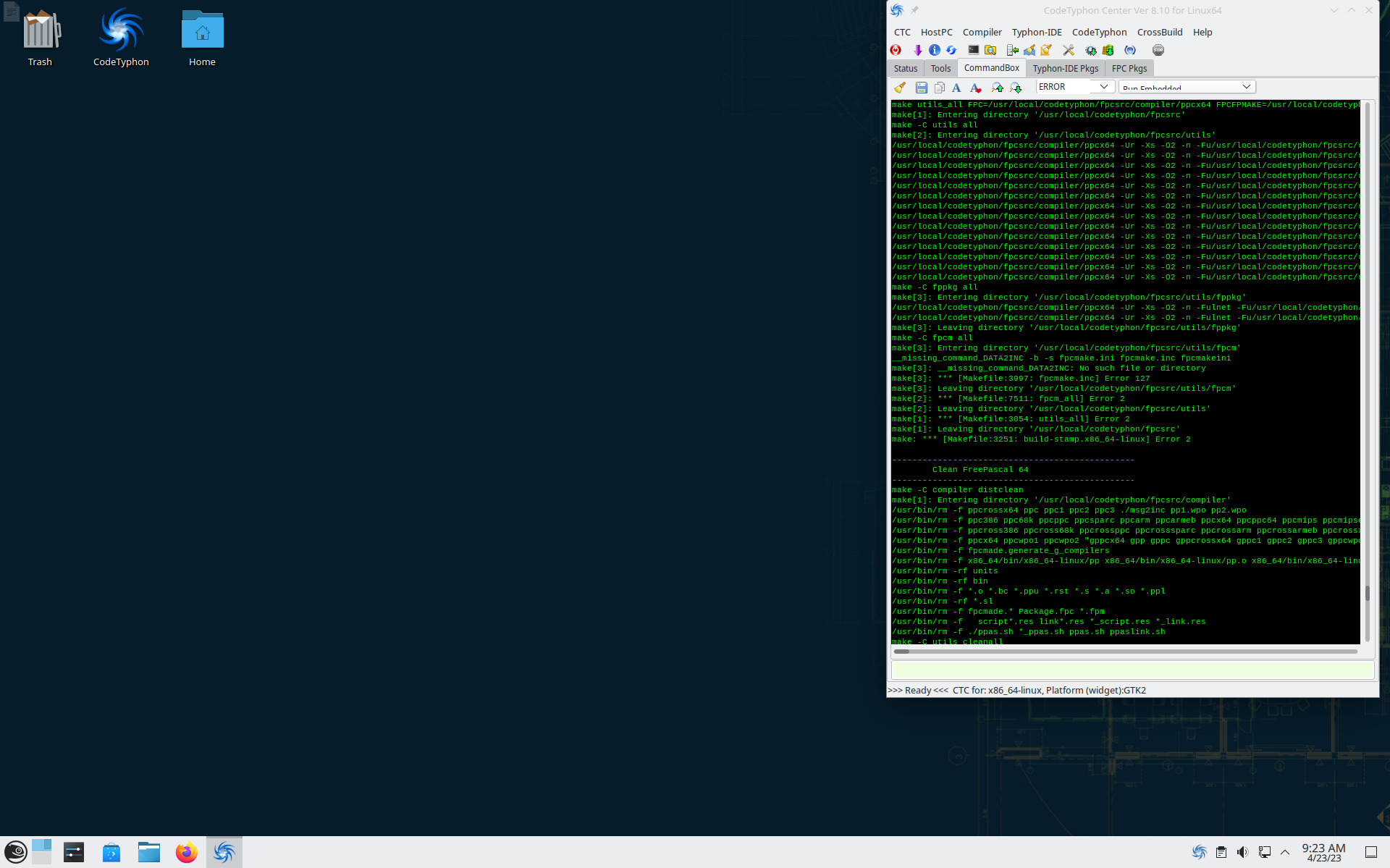

On Remove and Build BigIDE:
Copyright (c) 1993-2022 by Florian Klaempfl and others
(1002) Target OS: Linux for x86-64
(3104) Compiling fcllaz.pas

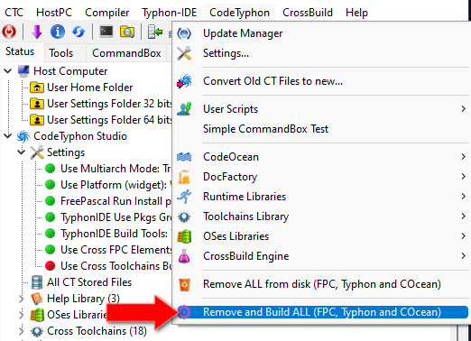

Why problems with "unit system used by fcllaz"? 3 years 7 months ago #17727
Please
-Open CTCenter
-Do CTCenter => CodeTyphon =>"Remove and build ALL"
-Save the log of CT Center action  more info
-Zip or 7zip this log file and post here as attach.

Why problems with "unit system used by fcllaz"? 3 years 7 months ago #17729
NO This is only TyphonIDE build Log
your problem is in FreePascal build
Why problems with "unit system used by fcllaz"? 3 years 7 months ago #17730

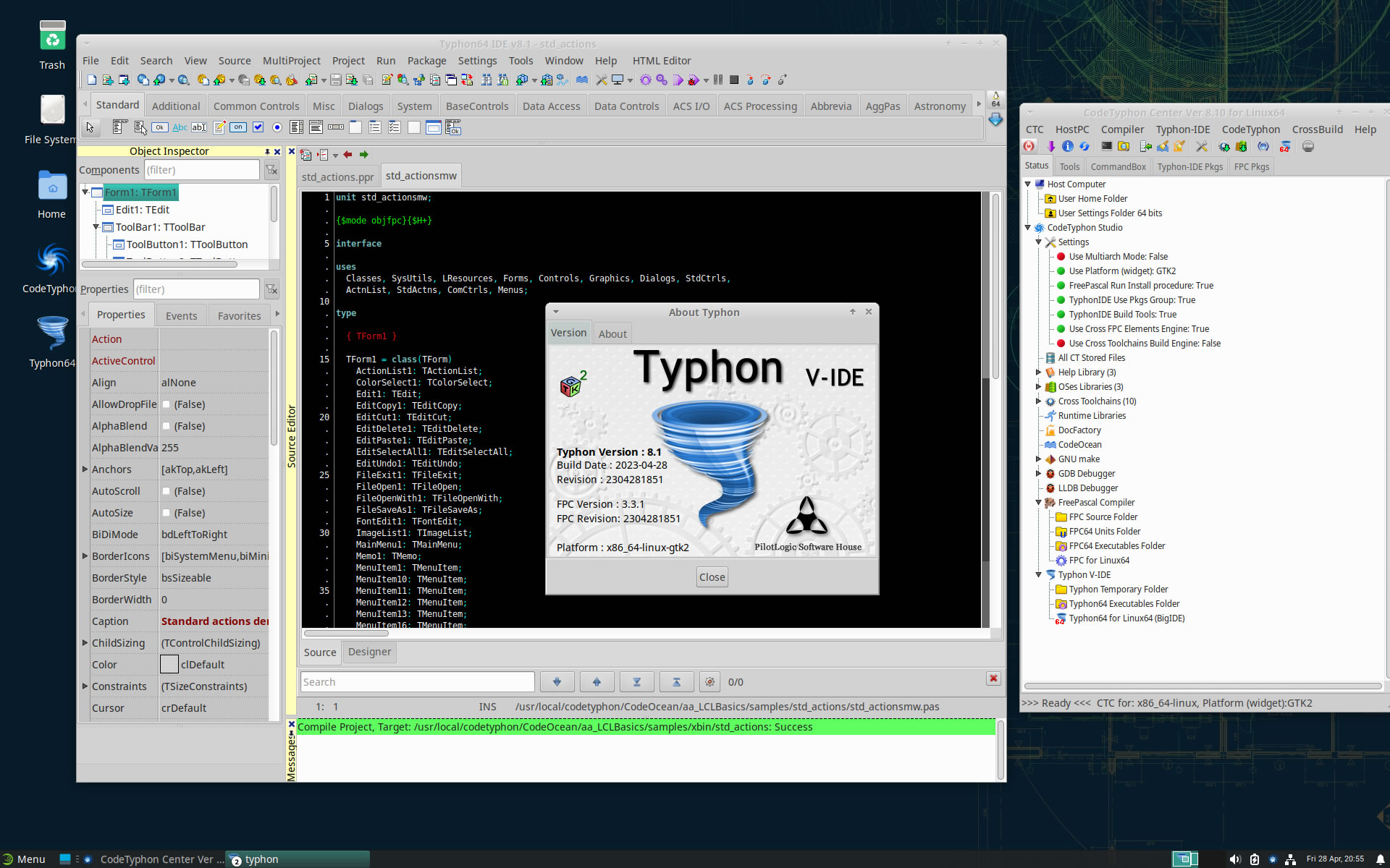

Why problems with "unit system used by fcllaz"? 3 years 6 months ago #17736
We final fix the FreePascal fpcm tool problem on
openSUSE Tumbleweeth
